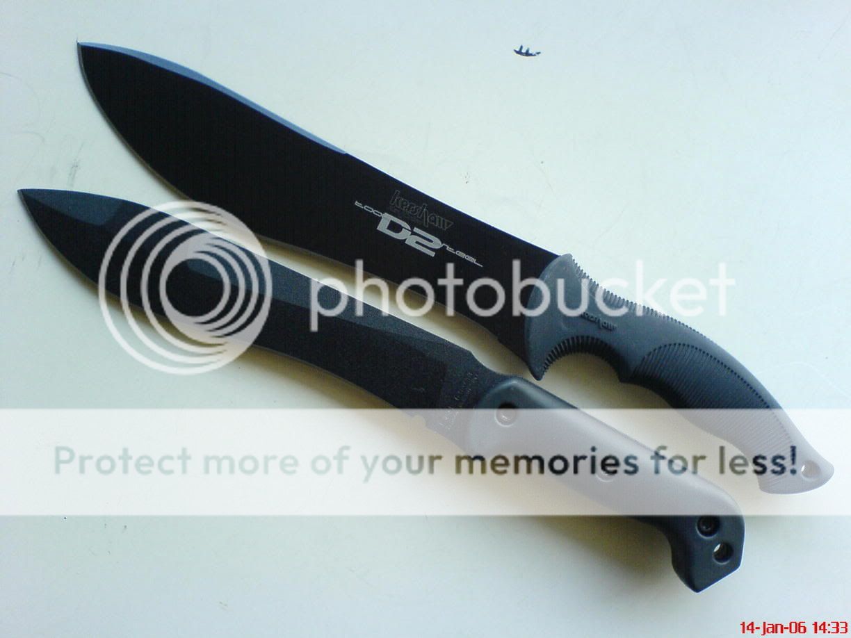

After a few months passed by, I finally bought both of them. Here are the side by side shots on them:
I haven't done any heavy testing on it, nor do I have enough expertise to comment on them. But so far I have used it for chopping on branches that got knock down by a snow plow in front of my house this winter, both showed more than enough performance for me on 'attacking' the branches. With winter gloves on, both handles provided secure grip even with snow around in the process.
What I have notice is the coating on the Outcast switched from TiN to Teflon somewhere within these few months. I had a chance to look at the Teflon coating also, it have a more matte surface compare to the metallic flake surface that my older Outcast have.
