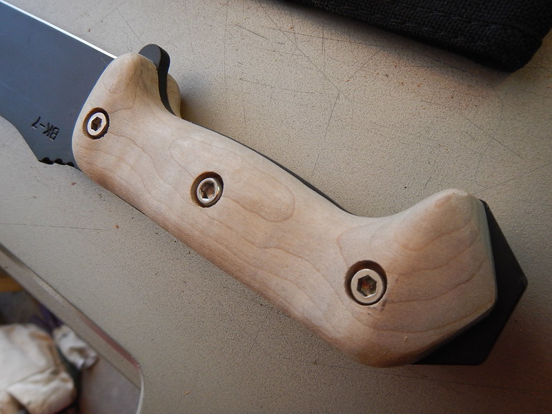

Done. Sanded to 220 and melted Bee's wax into it with a heat gun.
You do some awesome work man! I need to get another 17 or maybe a 15 to put the scales you made on. I feel guilty not using them, but the 17 I have is going to see some really nasty and wet work so I took them back off of it.

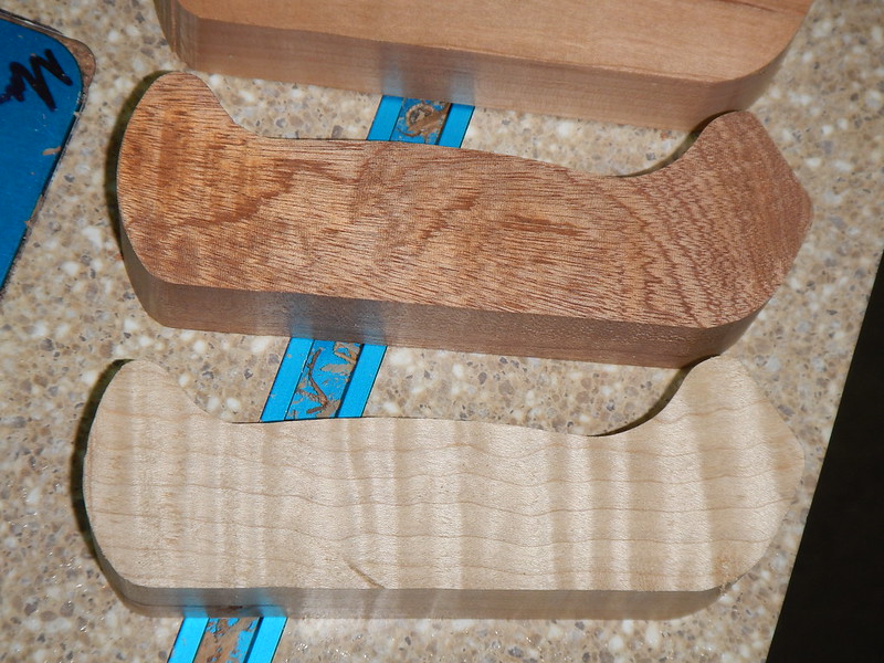

Hell yeah man, appreciate the compliments. I haven't made a set in almost a year but I just started re-working a piece of fiddleback maple I had partially completed. I do it pretty much the same way as far as the drilling of the holes and the alignment, I just use sandpaper to do all the contouring and I have this set of dial calipers I use to measure them at specific area's to make sure they even from side to side but also so they are close to Kabar specs. I really try to make them feel like the grivory.

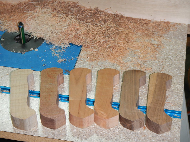

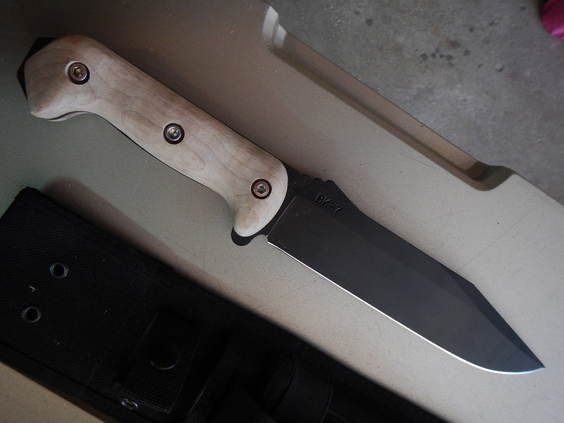

Thanks. Pair of scales per blank, drilled right thru and split the blank lengthwise on the bandsaw, then shaped the cut side, drill the stepped part for bolt heads and nuts and chiseled the (can't type this without smiling) nut holes. Been designing a jig that will automatically line up the blanks on the drill press, but can't build it yet. Probably be a while still, laid low by a back injury. The top photo was my pre-jig "learning" set, made from the maple blank at the bottom of the last pic. The scales are all sized on a router table with a bearing guided bit and jig. Probably still have a lot more "design opportunities" to experience.
Edit: just looked at my other post trying to remember what I'd already said, to post another pic that wasn't already posted. Most of the above appears to be redundant. Oh well, pic anyway:
and another:
