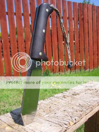

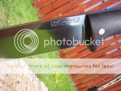

Here is my modified BK10 with an African Leadwood handle and the thumb ramp removed.
Hope you like it.
Cheers. :)
Good Lord man, don't be coy, thats awesome. Whats not to like? SWEET WORK.
