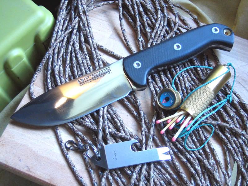

I've just finished another mod job on a Becker Campanion. :)
From this:
To this:

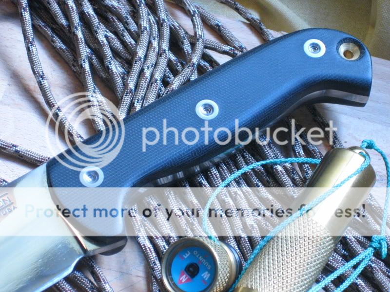

Black linen Micarta handle scales with counter sunk allen head screws.
The lanyard tube is made from a solid piece of brass rod to tweak the balance point to just in front of the forefinger.
My new favourite. :)
Cheers.
