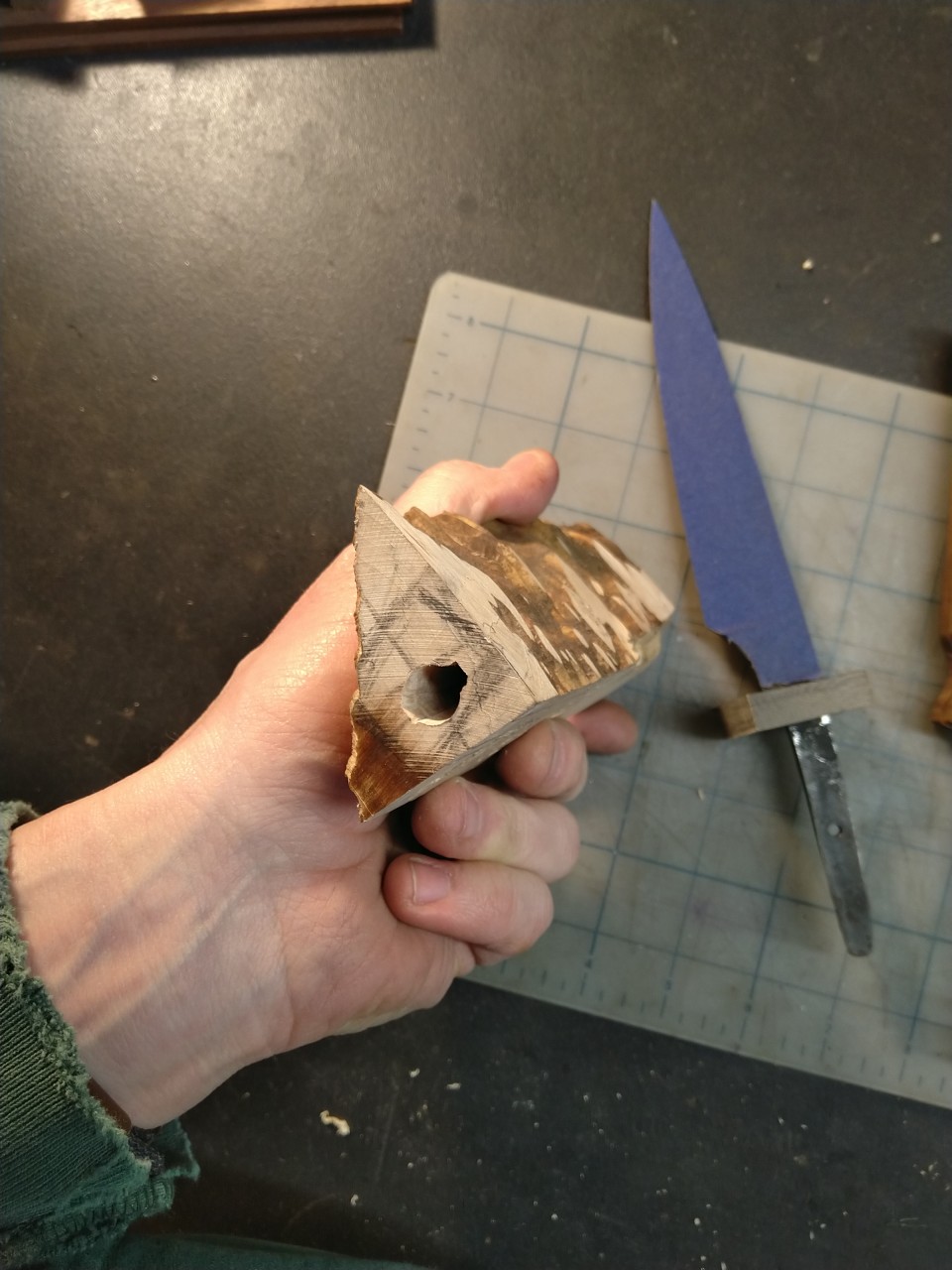

Stopped just short of epoxy this evening. Might be done for the weekend. I'm going with the kitchen handle, because otherwise it will just be a scary thing that will never be used.

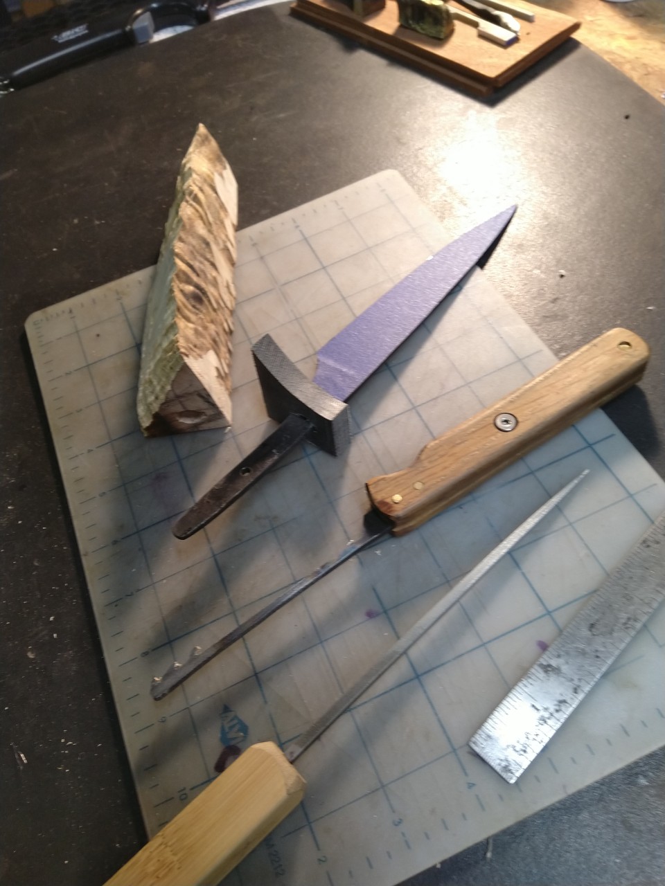

Where did you get the broach?
And would it work on antler?
Not sure about antler, I've never worked with the stuff. Tho the core is fairly soft, yes?
I made that broach out of a scrap of 1084, and a smaller one I made too. The oak handle has pins that match either Milwaukee or Makita (I ferget) reciprocating saw/jigsaw blades, so I made the broach tang match that and I can swap them out, or with commercial blades (which are too short for most things). I covet @johnny_ducati_rocks's broaches, but mine work ok enough.

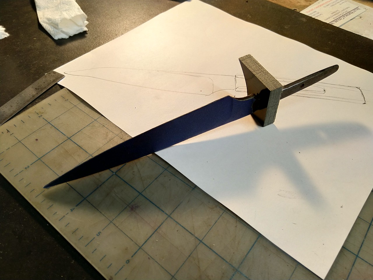

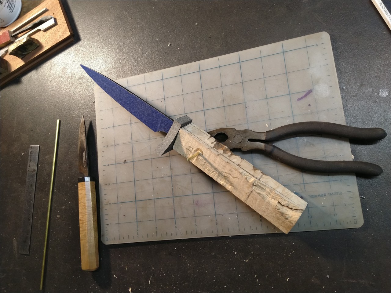

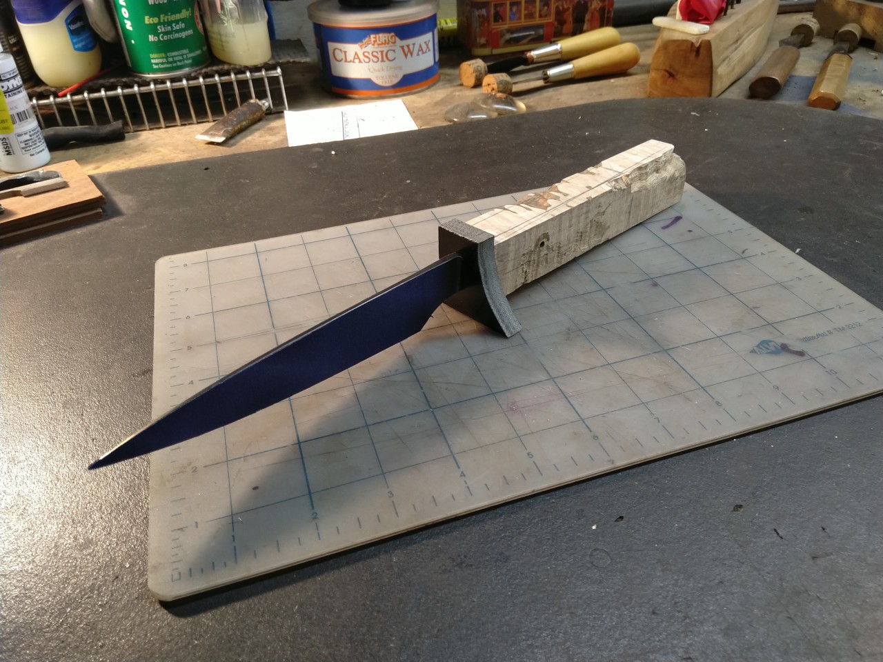

Alright, let's finish off that WIP from earlier in the week:

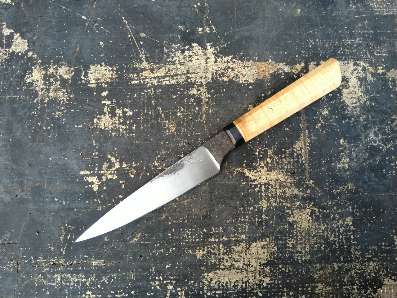

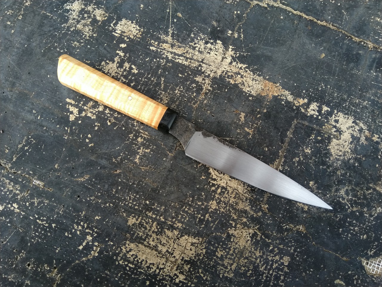

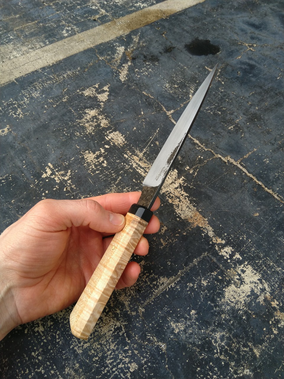

4" of Volvo suspension spring becomes a western-ground sashimi knife. Swedish Fish, anyone? :p
If I had any, would have staged a picture. Micarta bolster, natural curly maple handle. Blade is 6.5" long to the bolster.
That one's great, Hawk. I mean they all are, but how did you pull off the collared buttcap?
Thanks daizee. A few days prior to my injury I made the .188" brass bolsters and drilled out the rear one and ebony spacer for the handle tenon. Last week everything was fitted, epoxied, tapped together and finally shaped. There is a very slight inner taper to the hole in the rear bolster to insure a tight fit.
