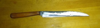

I worked a little scrap of 1/4” x 2 W2 into a kitchen knife today, ended up with about a 6” blade, 6 3/4” with ricasso....Not sure what style you’d call this.
COOL material re-use!!

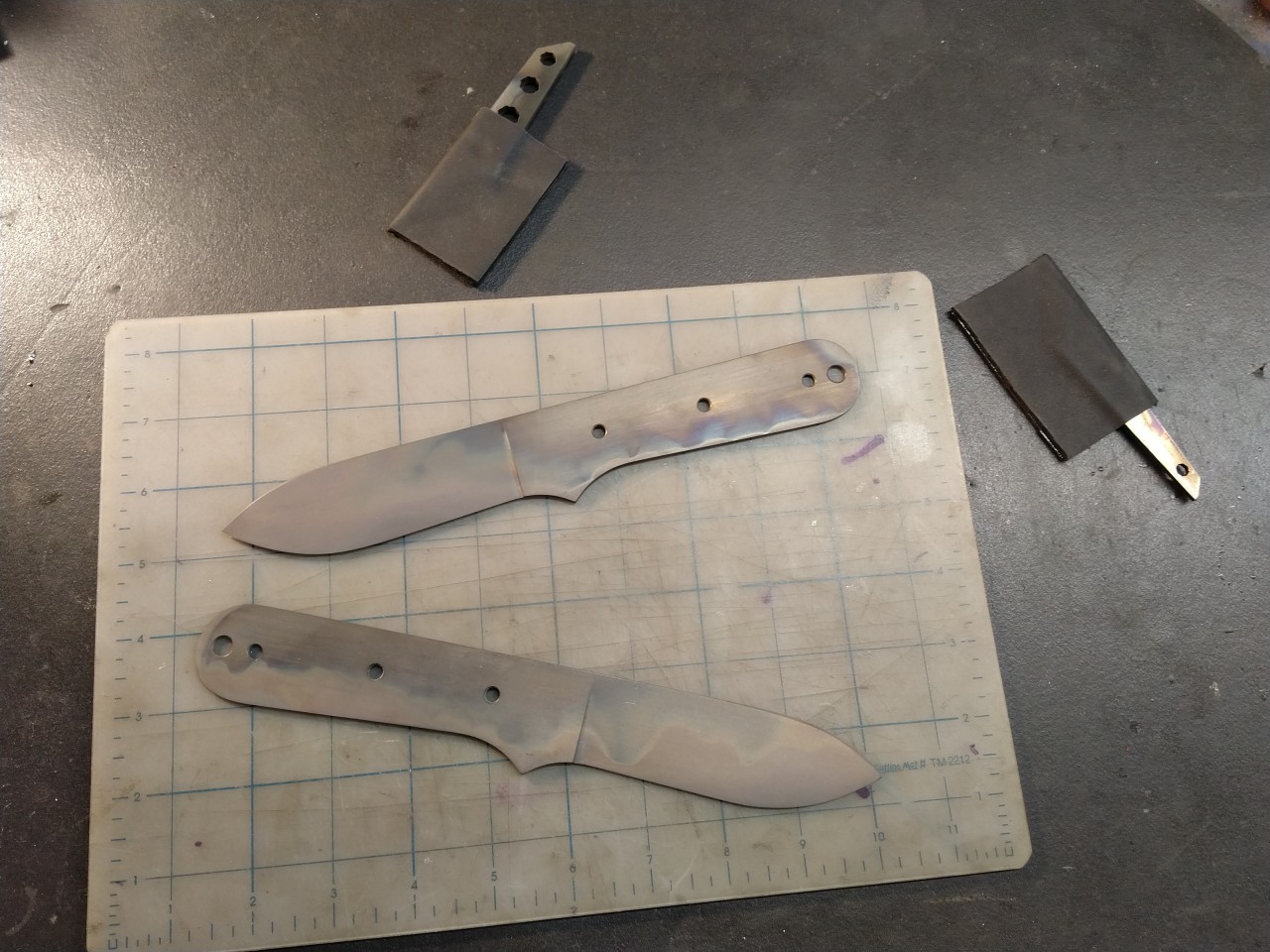

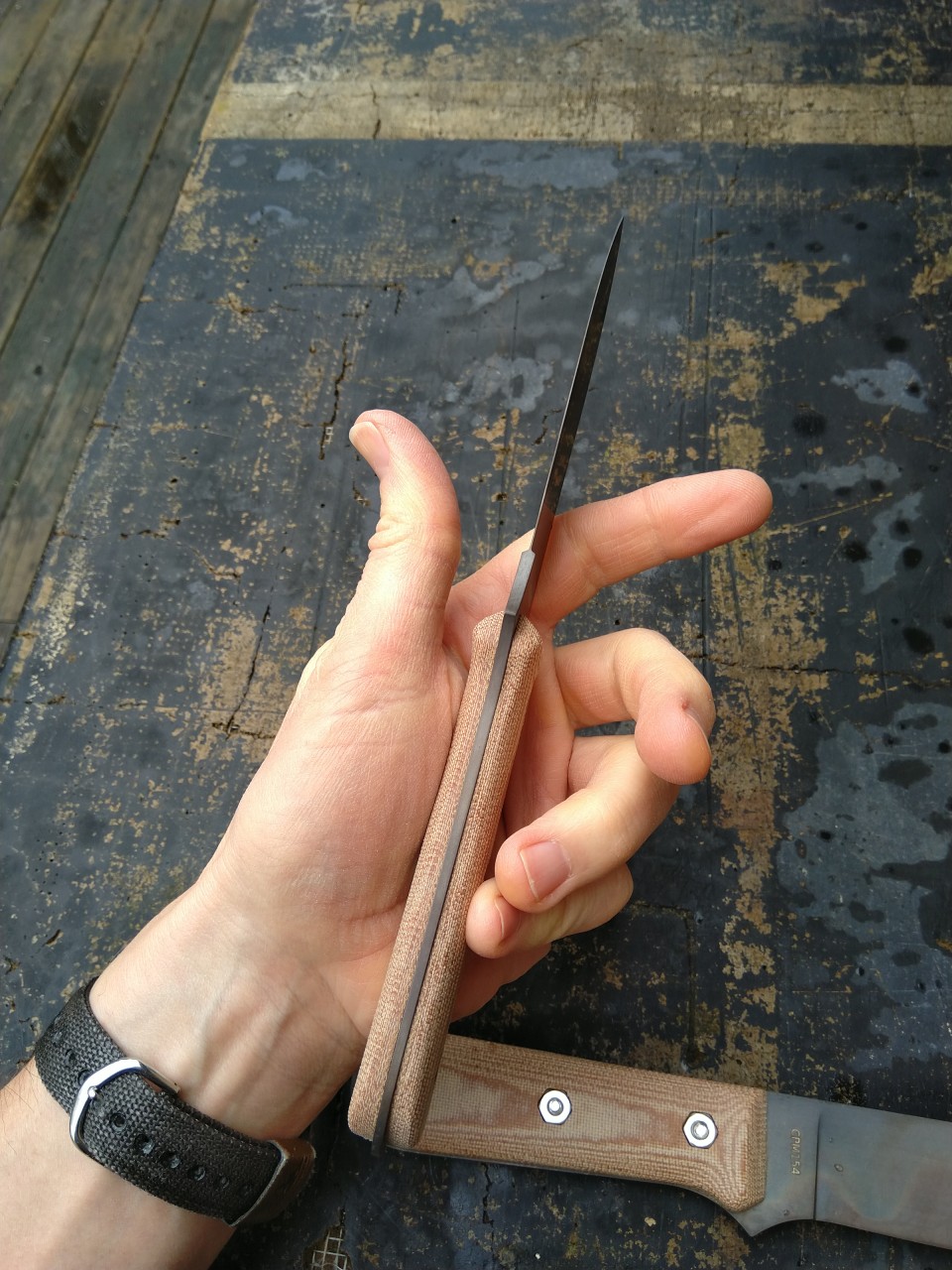

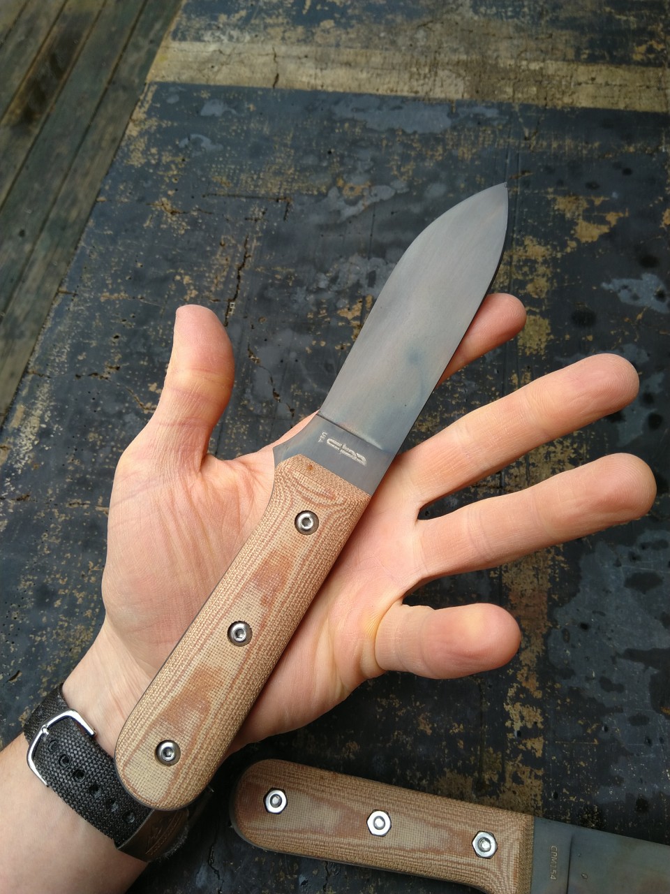

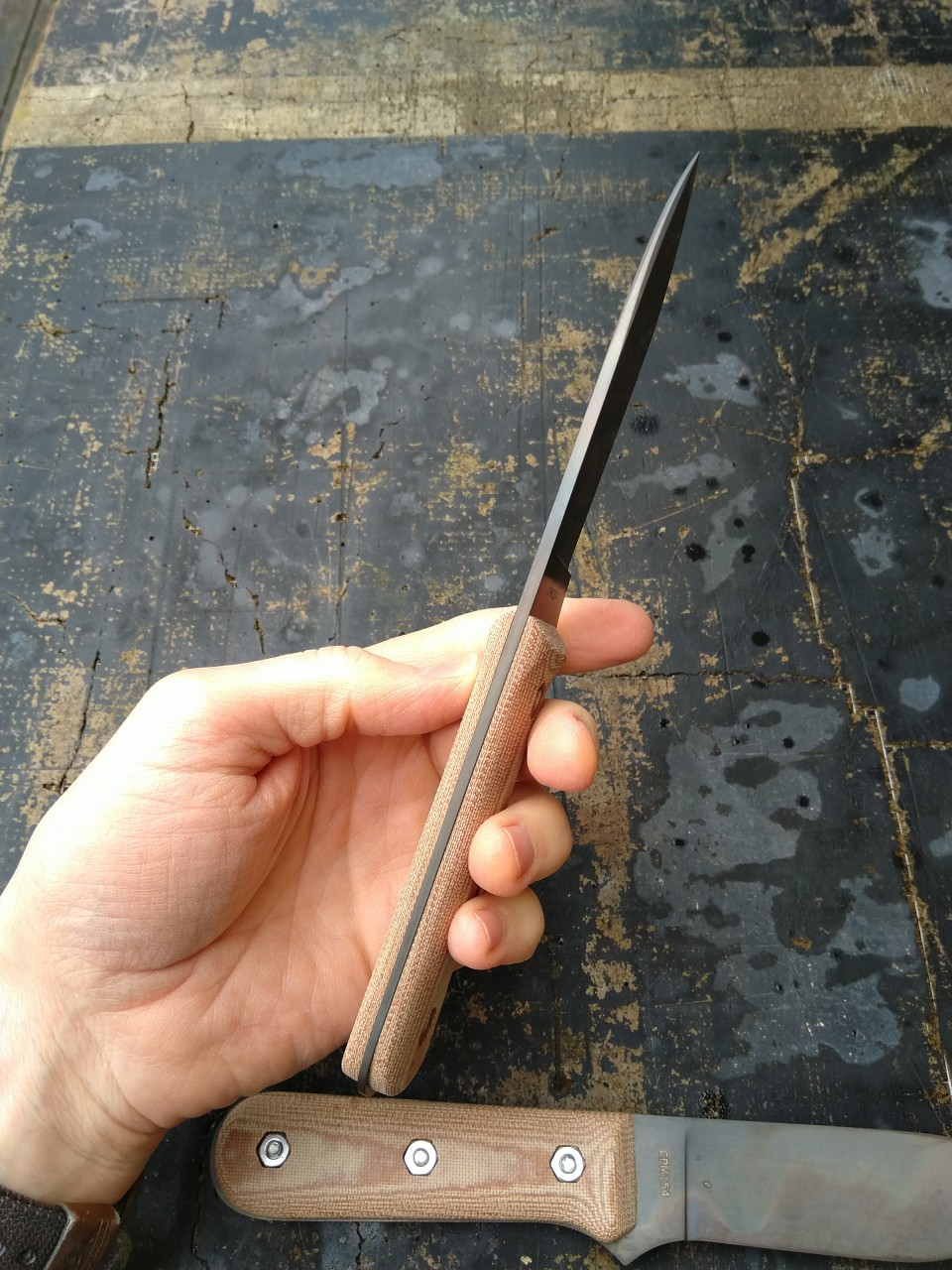

Sourcing dry ice has become a challenge for a variety of reasons, but I was able to snag some today and get this pair of CPM-154 AuK4's cooked. They'll look a bit less stubby when the scales are on. One came out perfect. The other is going to require some tricky straightening...:

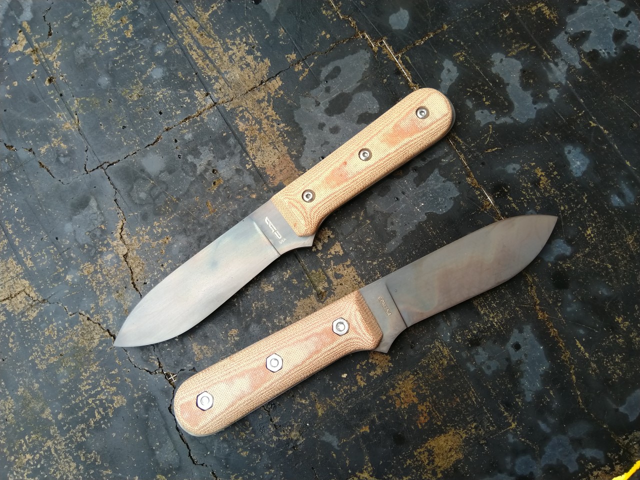

Last knives of 2020! A matched pair of AuK4's in CPM154. Awww yeah...
You can see thickness before the edge goes on - should get 'em sharpened this evening, but wanted pix while the sun was up:
