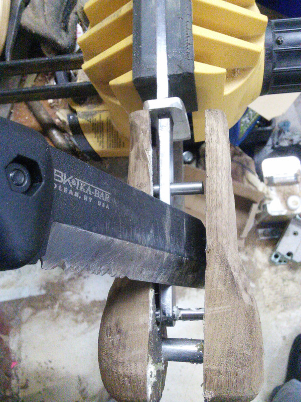

What did that used to be? What kind of epoxy?
Micarta waaaay stable. No splitty.
I'm a fan of West System's GFlex. It's toughened for a good bit of spring and would make for a good interface. I think you might have introduced too much stress by using the pins to snug things up. Typically there's a softer material spacer involved between a handle and guard when that technique is used, I *think*. A thin piece of leather might work. Soak it in epoxy too, and squeeze it up there. You'll often see copper.
