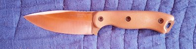

knoefz knoefz recent post reminded me that I have been procrastinating for months and still needed to dye my BK19 micarta to fit with my set. Finally got to it and rounded it out with some azwelke azwelke kydex…
