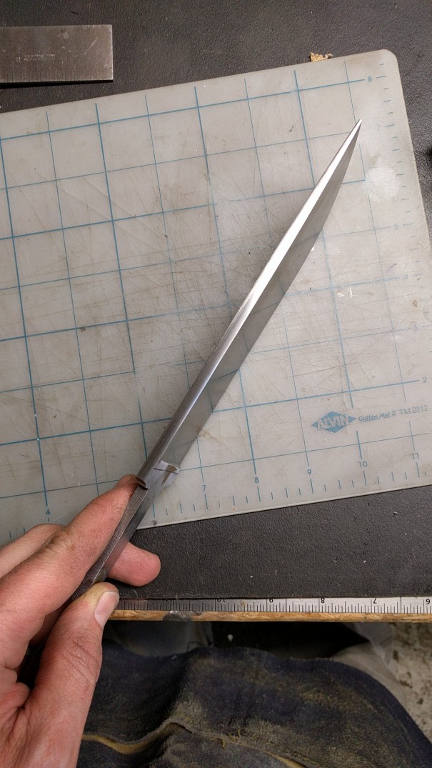

Just in case you guys think I've fallen ENTIRELY into the ocean (not yet as of this writing, but who knows - I fly again this afternoon), here's a little something something that will hopefully be finished before the year is out... 0.200" at the spine. :eek:
Nope, no more clues than that 'til it's done.

You are a tease.
