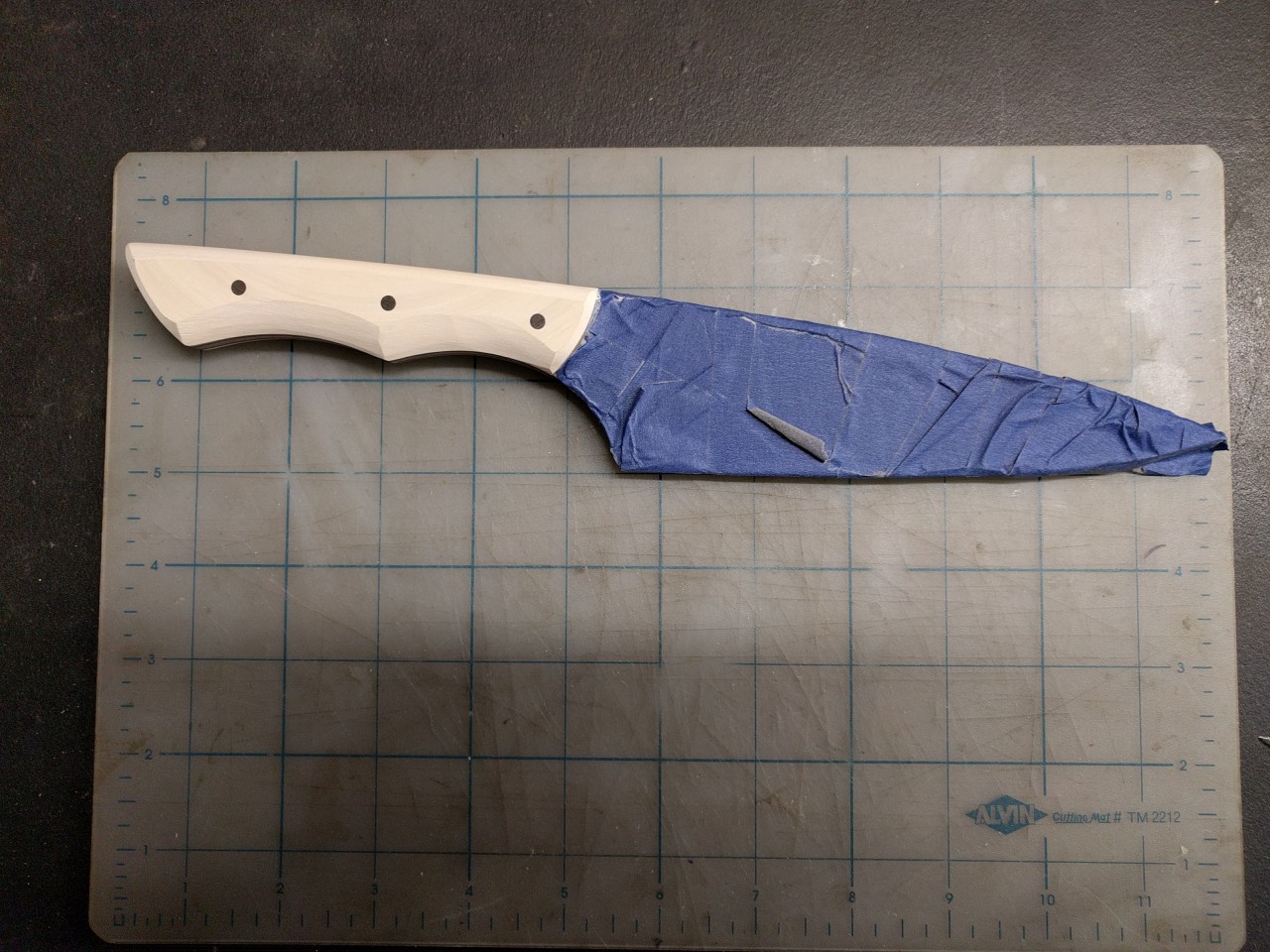

Teaser for the gallery link:
https://www.bladeforums.com/threads/aeb-l-chef-knife-with-micarta-and-g10.1598788/
