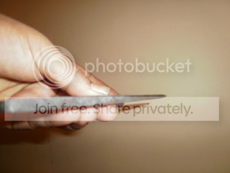

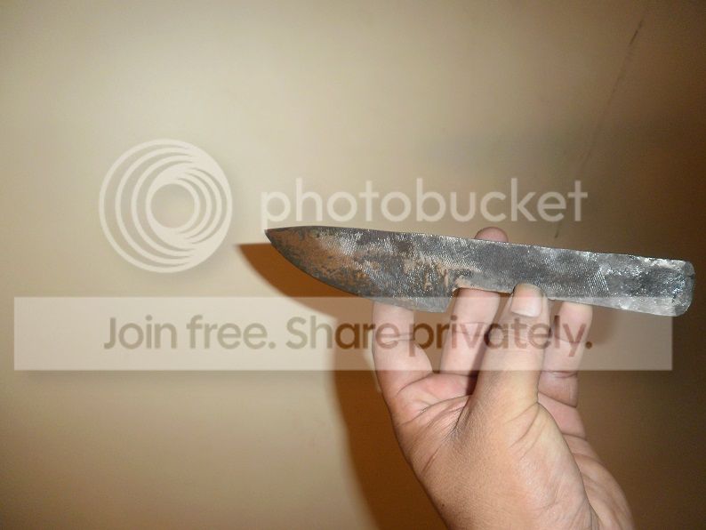

Begining WIP my own knife.
Feb 8, 2012
598

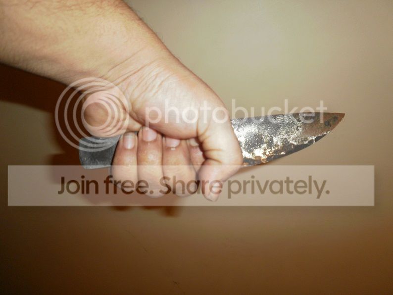

I dont know if this should be here but its probably not worth putting up on the knifemaker's pages yet :D.

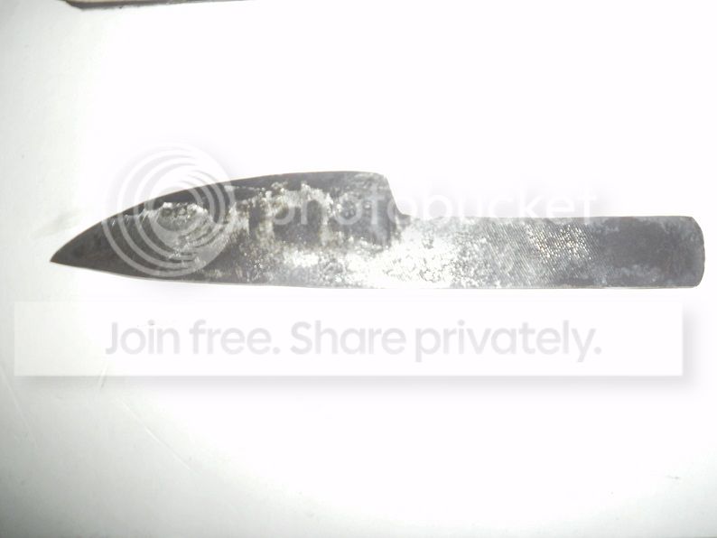

Started with an old file that I had of unknown steel. Its a standard metal file used by automotive shops to shape sheet steel. Sat with a local smithy and had him soften it and beat out the general shape and now I am refining it on Carborundum universal sanding cloth at 80grit.
Need advice on a few things.
When I heat treat, should I simply go to bright orange color/non magnetic and then quench.
I don't know whether I should use oil or water. I was thinking peanut oil heated to about 175degC.
I need advice on tempering/annealing. What temperature should I temper at, for how long? And then how should it cool and for how long?
I have also read somewhere that it should lie on another heated piece of steel on its spine to "drain" the temper. I did not understand what that meant. Any advice on this from the Gurus would be much appreciated.

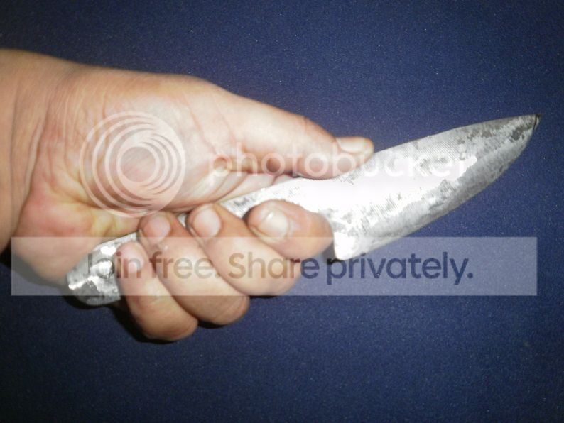

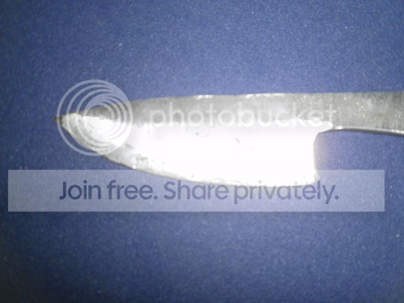

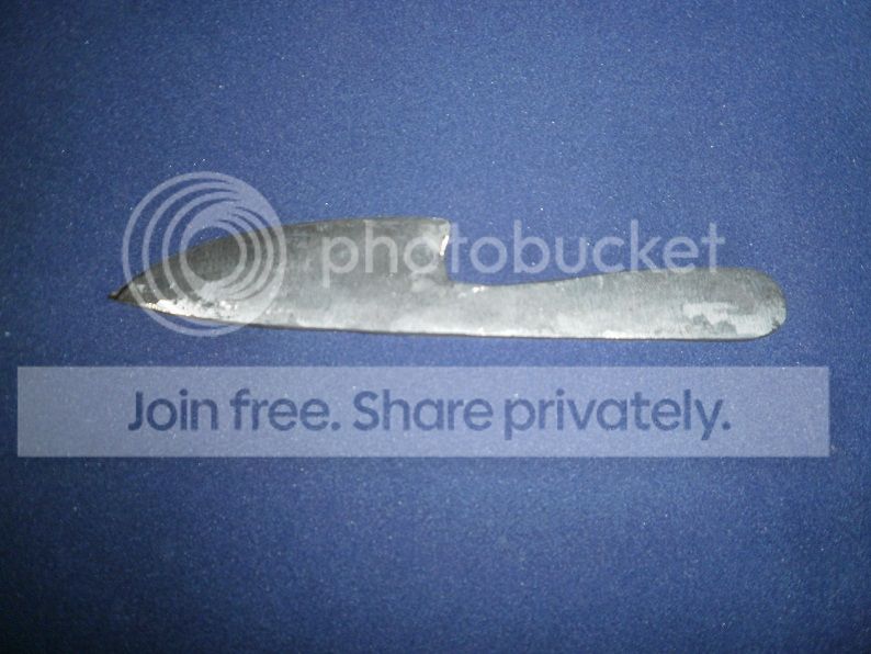

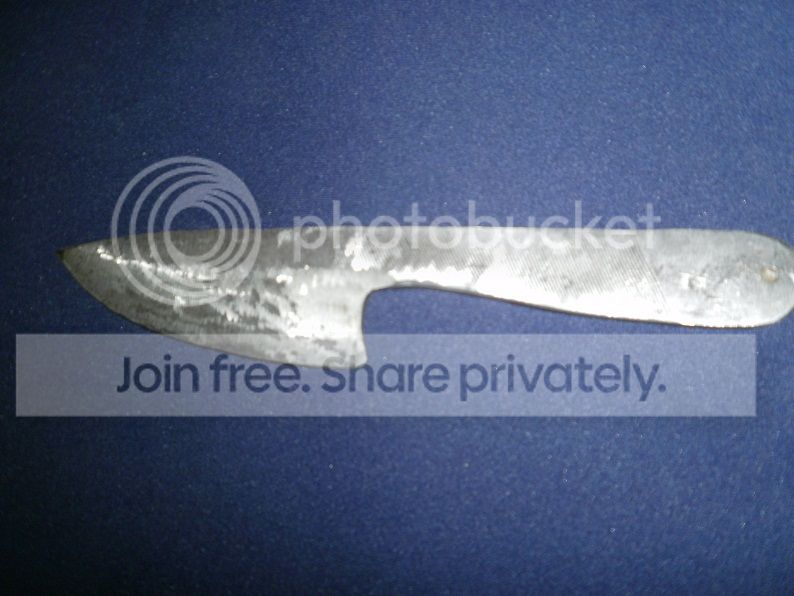

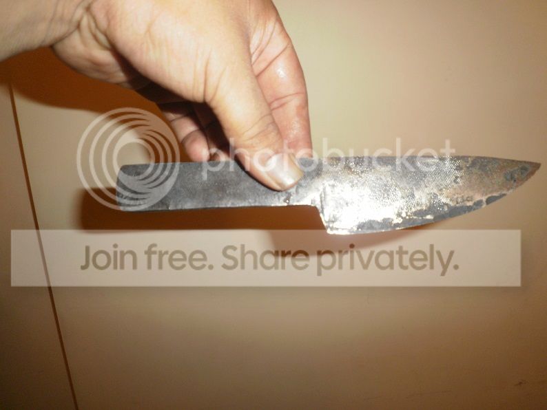

After a little handheld disc sander action.
Did this to remove the blackened parts and get a usable shape. Have a feeling I might have made the neck too narrow. Doesn't seem to be weaker or anything. I tried to break it :D
