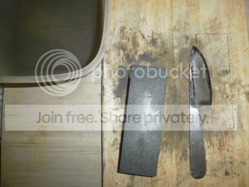

Begining WIP my own knife.

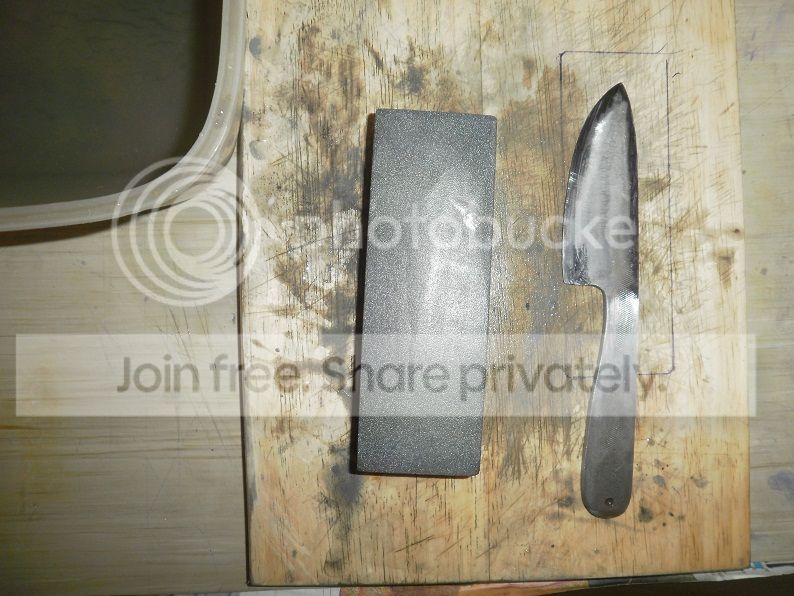

I've managed to get a reasonable shape to it. The tang etc is still unfinished.
After the wheel sander I have not used any power tools. That bit of cheating was also because its very tough o work this steel because its still quite hard even after annealing, which was done to forge the rough shape. I am still unclear how to HT this particular steel. I guess I will cross that bridge when I get to it...........

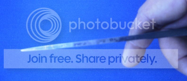

PS. I'm using the fairly idiot proof "Sharpie" method to flatten the edge. But I might just be the idiot this not proof against....
How do I check if its truly flat? And it strikes me that a true FFG would automatically have some distal taper. Is that right?

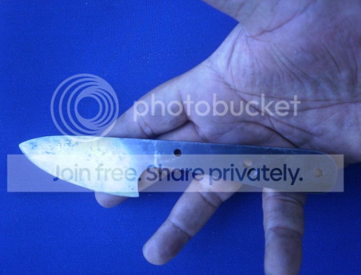

Post shaping, grinding and HT. HT was as follows
1. Heated to nonmagnetic plus 2 minutes. This happened surprisingly fast. In 15 minutes it was glowing bright red so I tested it with a magnet and it slid off.
2. Quenched in fresh peanut oil for 90 Seconds after the flame went out. It flamed for maybe 4 seconds as I dipped and moved the blade around.
3. Let it cool until I could hold it in my hand.
4. Heated it until I got a dull glow again. Took another 3 mins and a few seconds.
5 Let it cool in its own time.
6. Hardness testing-
Tested with another file on the edge and it slid right off. Also I had banged the edge against a granite counter top to test hardness and to see if the edge chips or rolls before the HT. Edge rolled about a mm. I tried the same thing after HT and there was a little silvery edge roll but I had to look with a hand-lens to find it. And there is a small chip on the kitchen counter top I am hoping my wife doesn't notice :D

Its an old file. I don't know what exactly the steel is but I determined its not case hardened. I find it difficult to source smaller amounts of anything with a higher carbon content than 1045. And I am unsure if that is good for knives. I chose a file because of proven "hardenability" and its a small and relatively thin knife. Incredibly difficult to grind and sand though.
Dim: 7.5 Inches with 3.5 to 4 inch blade depending where UR measuring from. 4.5mm thick at the base of the grind tapering off towards the tip.
