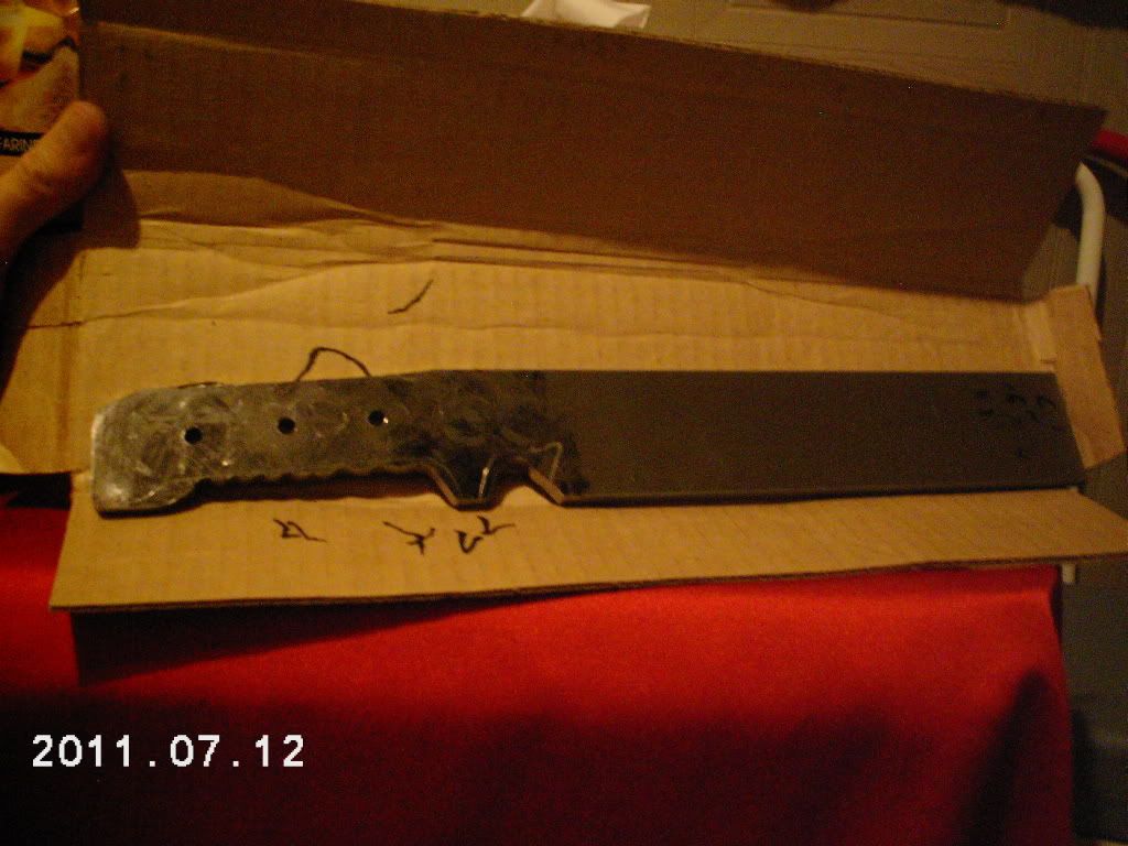

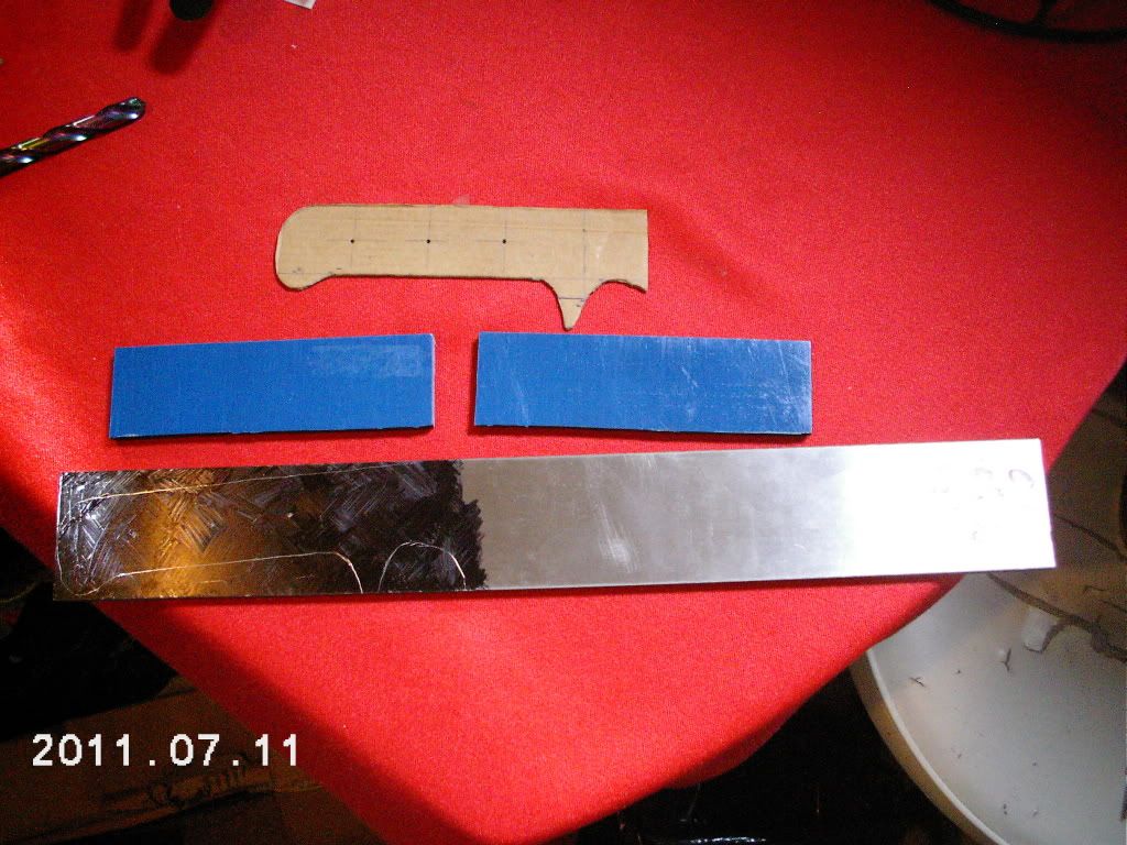

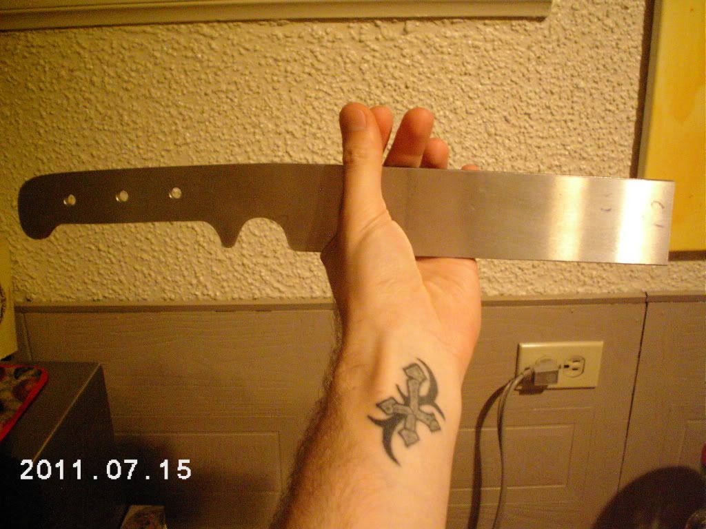

The starting materials: Blue/black G-10 and 1/4" thick O1 steel, 2" wide:
DCFN0001-1.jpg~original

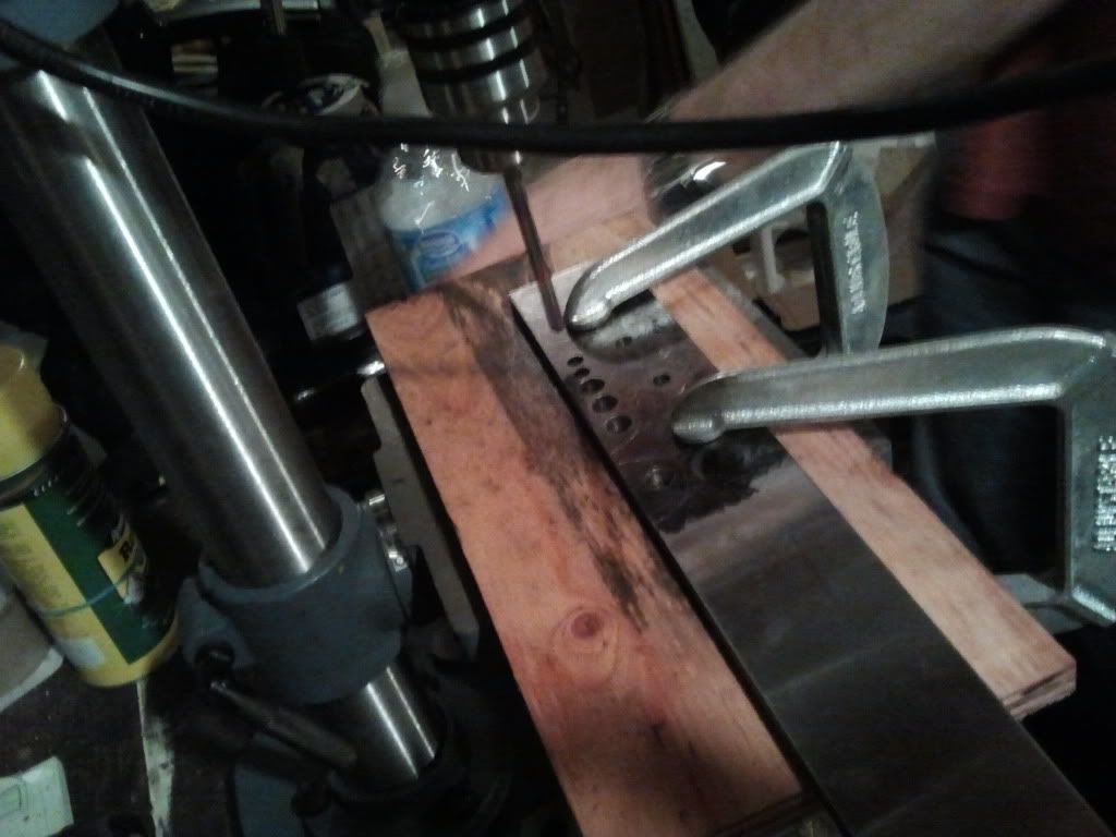

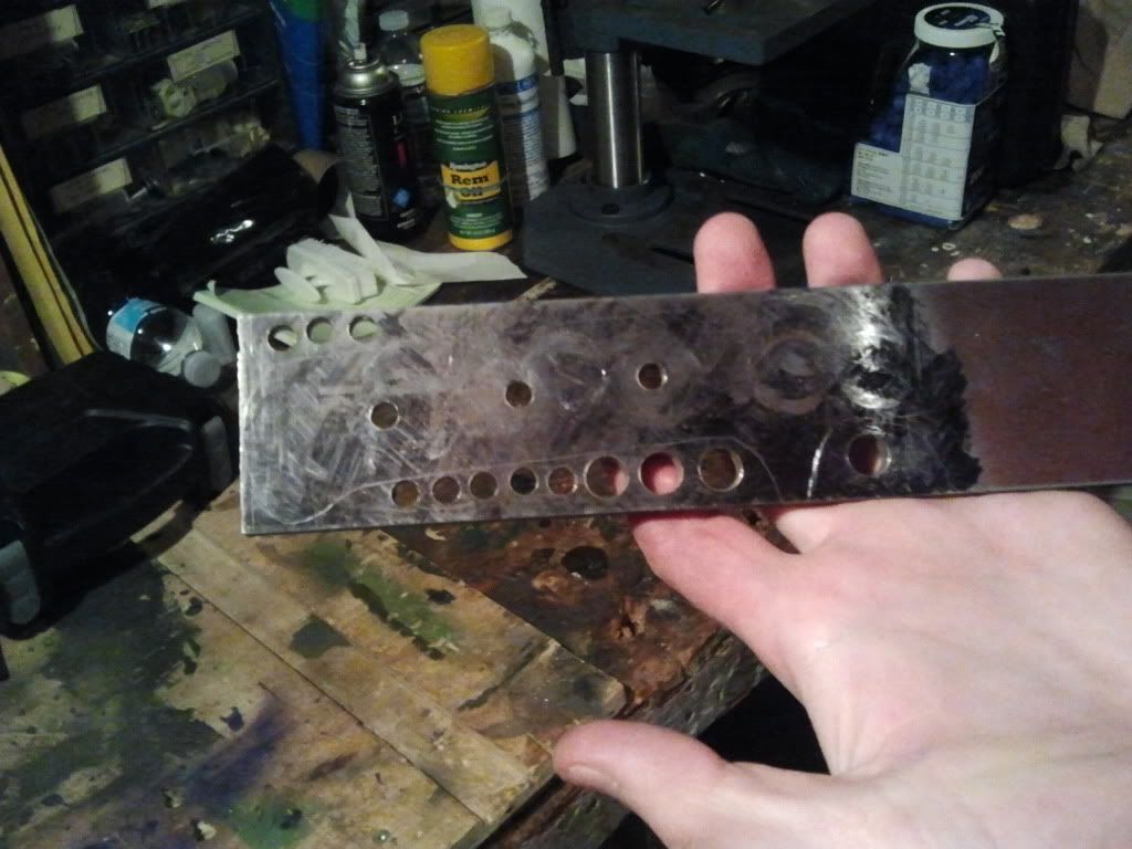

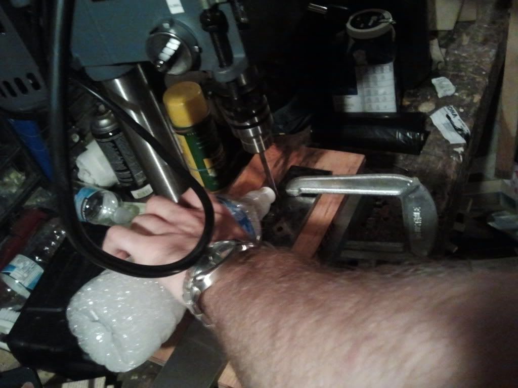

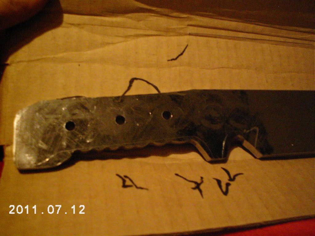

Drilling:
2011-07-11212626.jpg~original
2011-07-11212634.jpg~original
2011-07-11220117.jpg~original

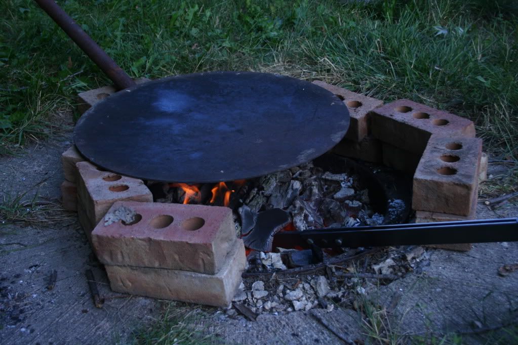

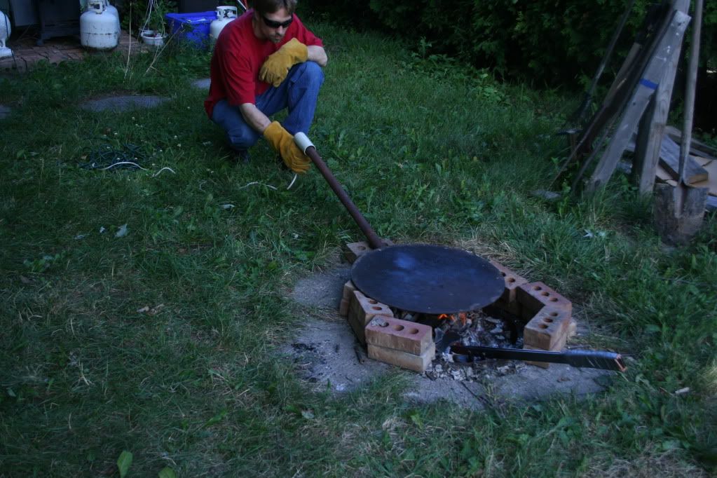

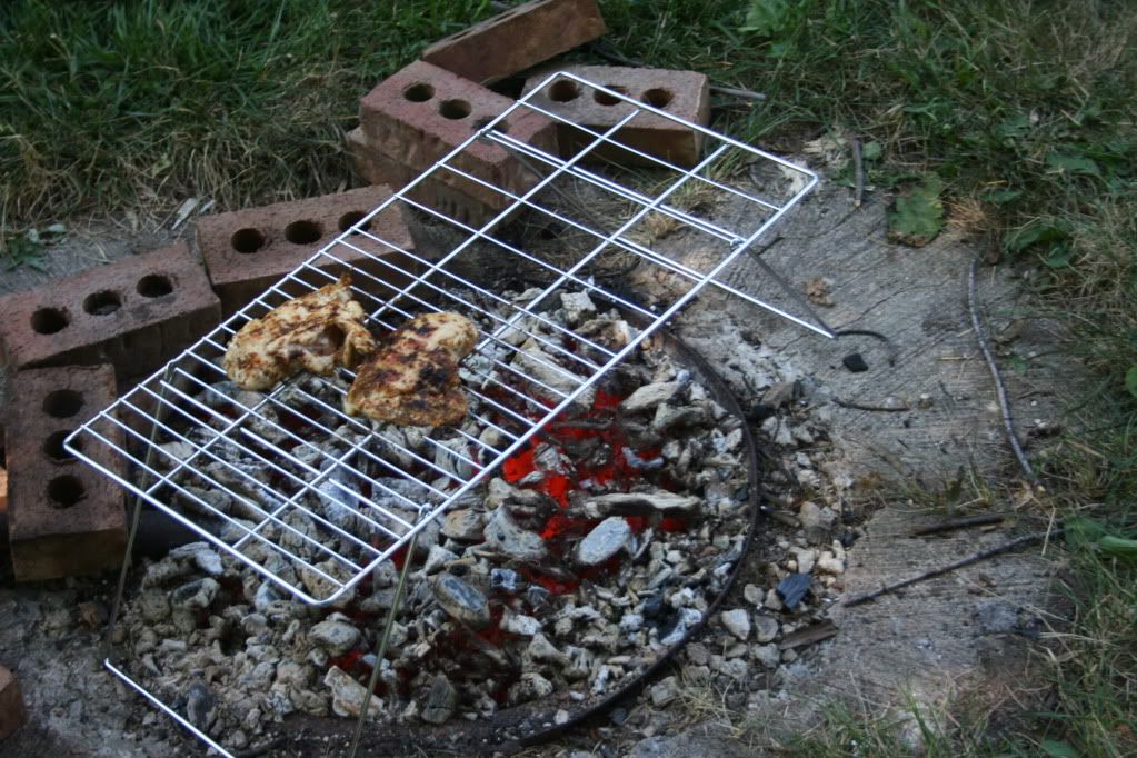

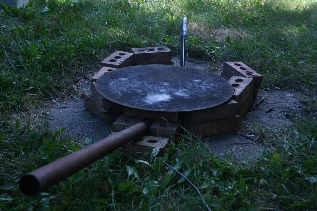

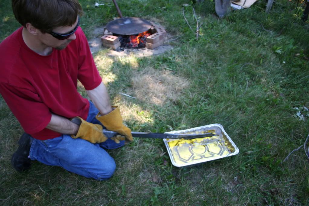

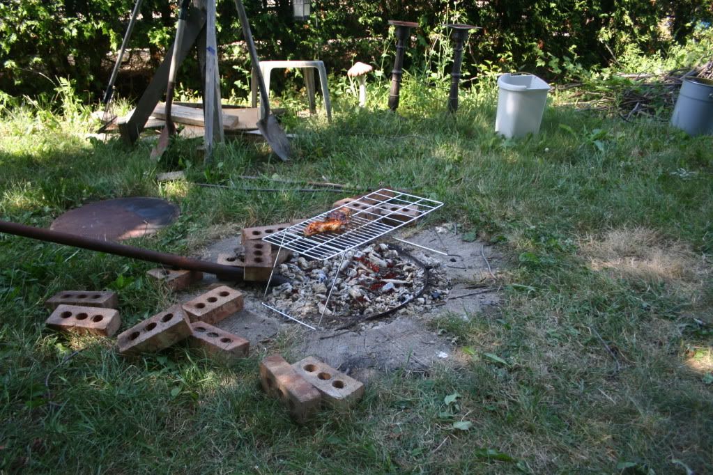

The forge:
IMG_7520.jpg~original
IMG_7521.jpg~original
IMG_7524.jpg~original

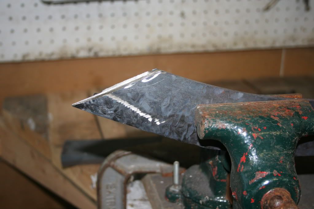

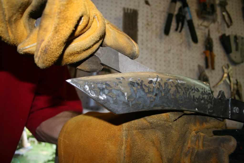

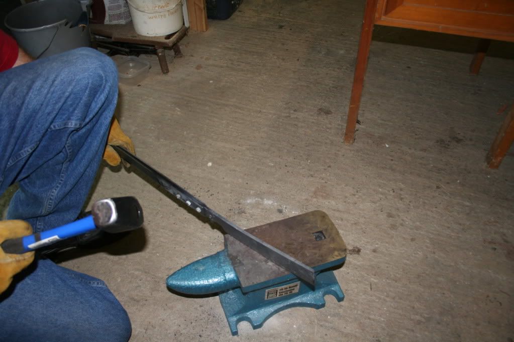

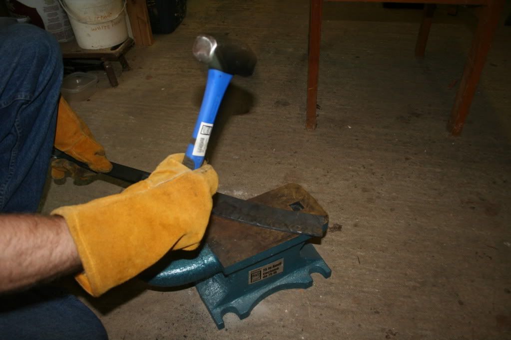

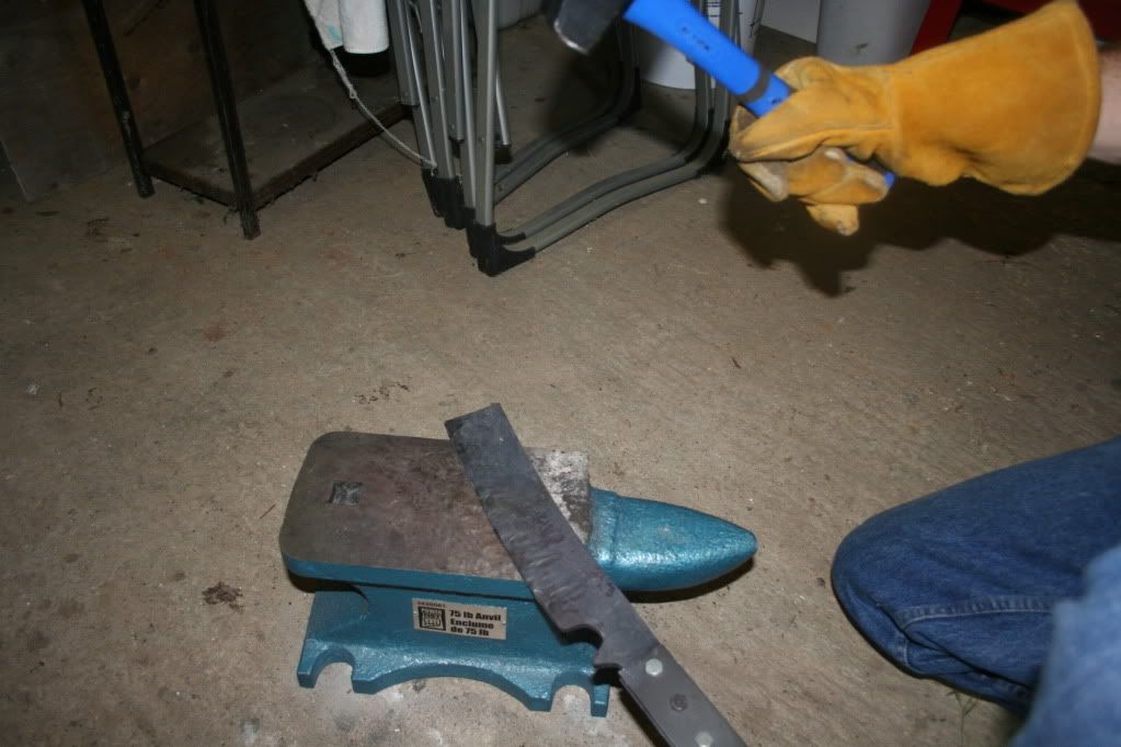

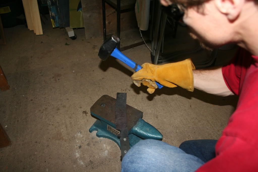

Hammertime!:
IMG_7534.jpg~original
IMG_7535.jpg~original
IMG_7539.jpg~original
IMG_7540.jpg~original

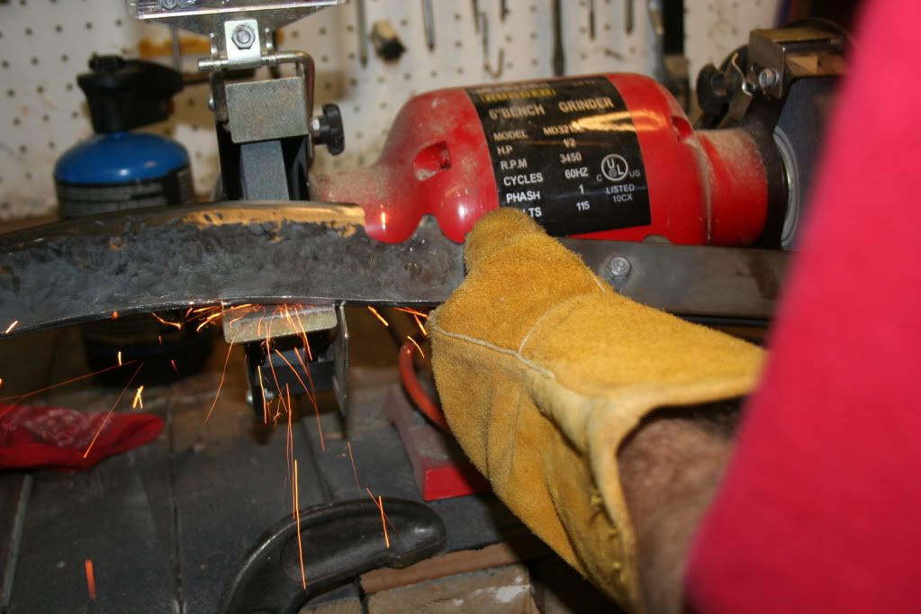

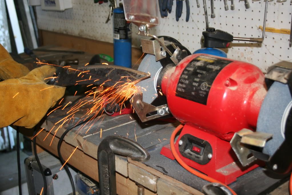

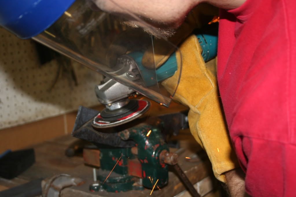

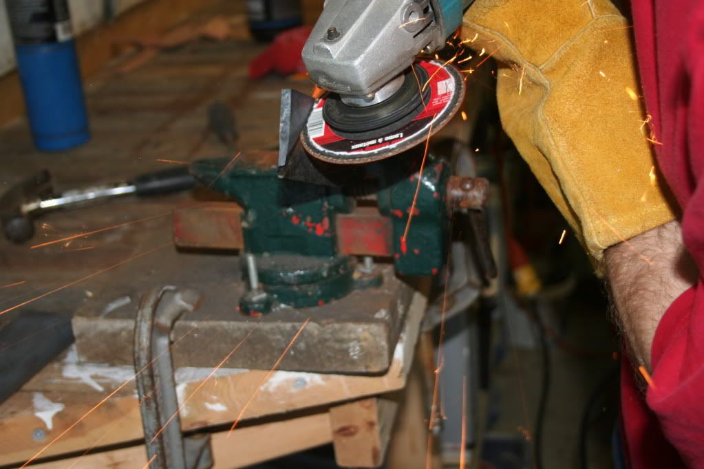

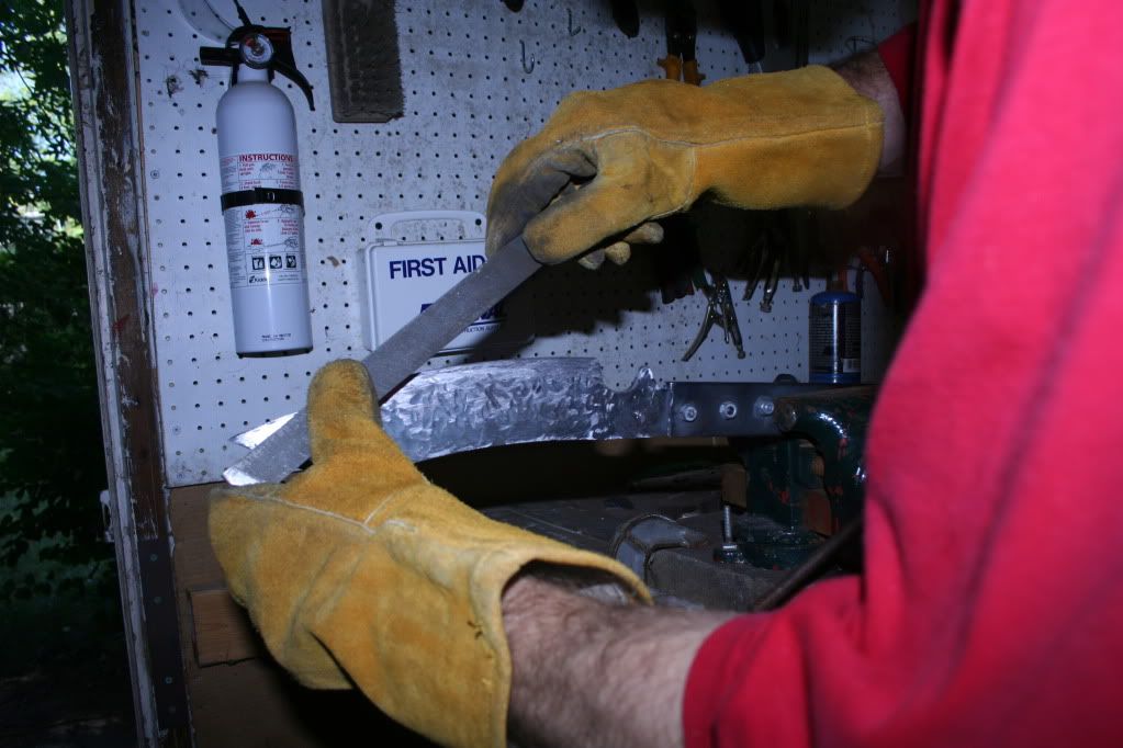

Grinding:
IMG_7551.jpg~original
IMG_7554.jpg~original

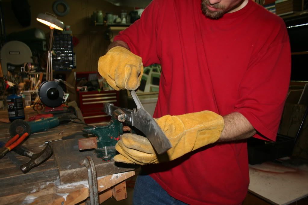

Filing:
IMG_7563.jpg~original
IMG_7571.jpg~original
IMG_7588.jpg~original

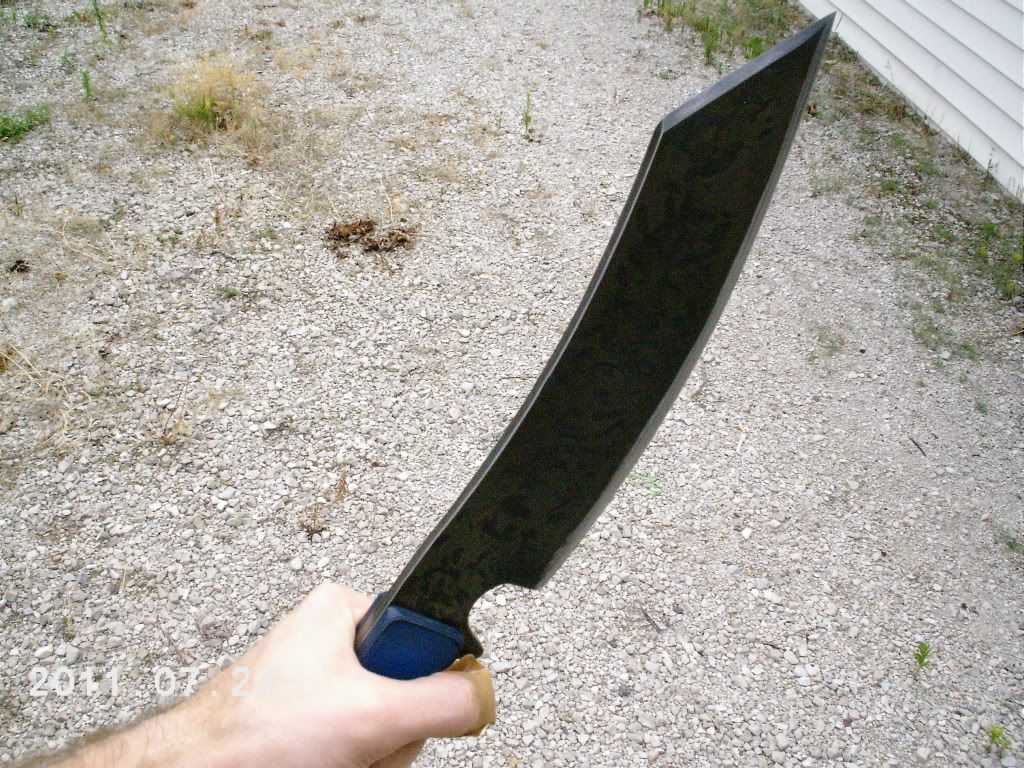

Quenching:
IMG_7598.jpg~original
The omens are good...the heat treat is a success!:
IMG_7602.jpg~original
IMG_7606.jpg~original

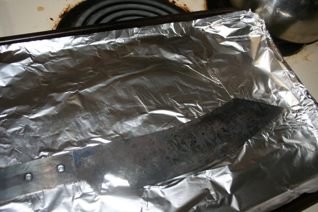

After first tempering cycle:
IMG_7629.jpg~original

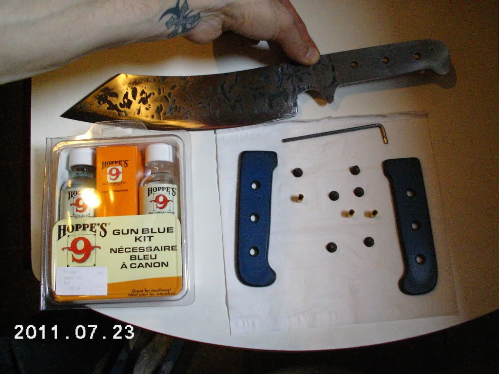

Time to blue:
DCFC0140.jpg~original

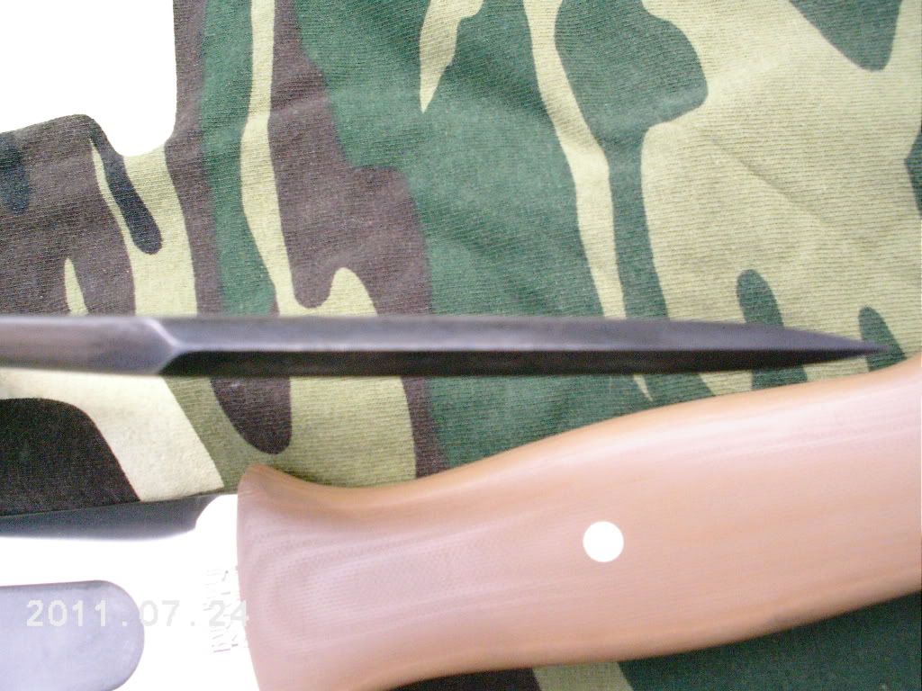

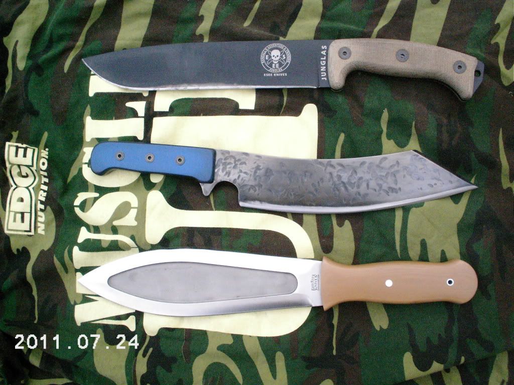

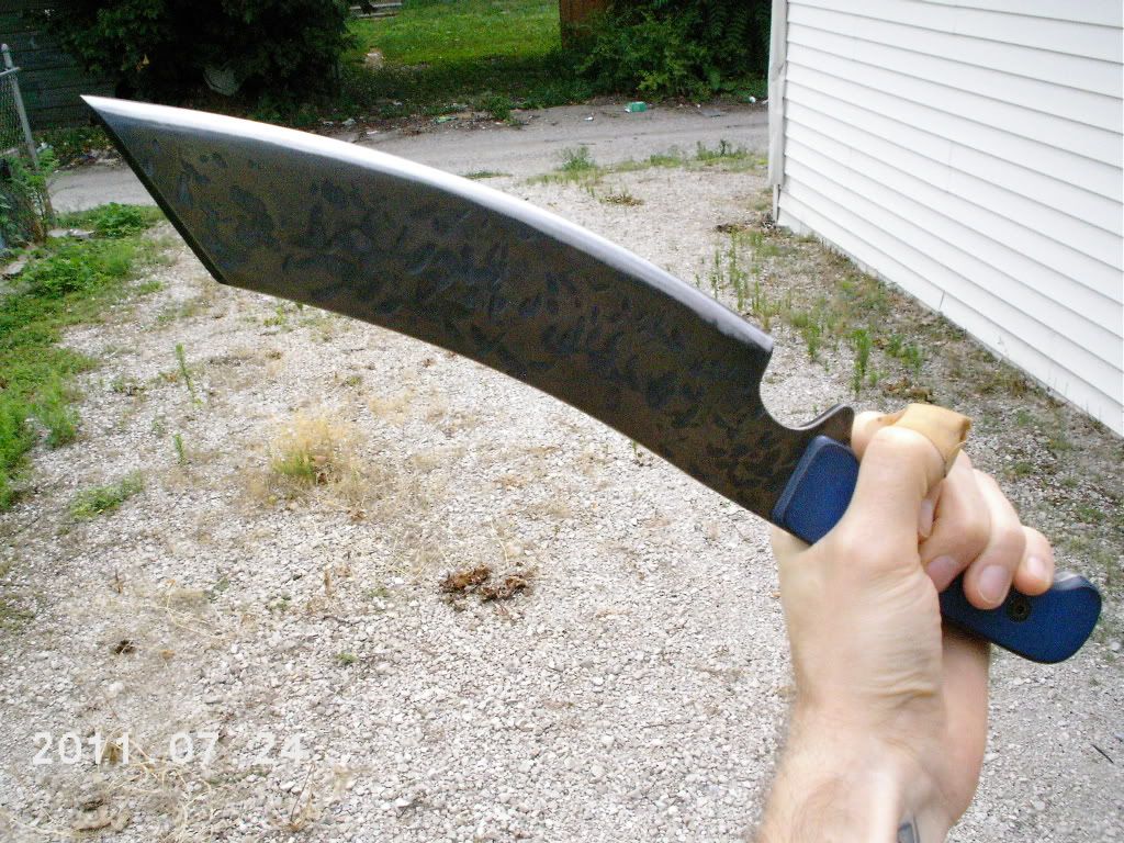

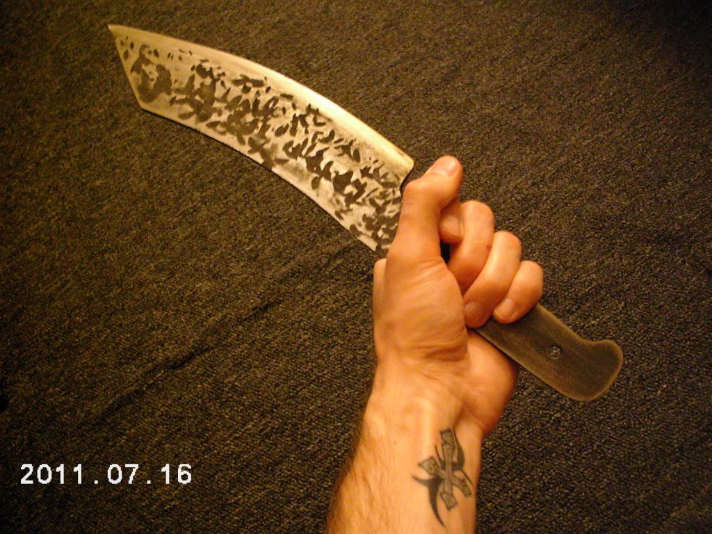

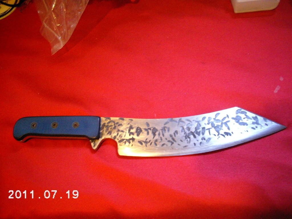

Finished!:
DCFC0148.jpg~original
DCFC0149.jpg~original
DCFC0155-1.jpg~original
DCFC0156.jpg~original
DCFC0158-1.jpg~original
Final Specs:
1 pound 13 ounces (29 ounces!!!)
9.5" of blade past the choil
Blade is 2.2" wide
15.5 inch overall length

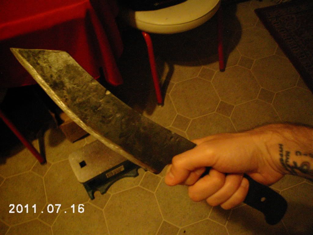

I see the beginings of an awesome chopper there! I look forward to watching this progress.
It looks like its done guys. I'm no knife maker but it doesn't look like the metal got hot enough during the forging process so the hammer didn't move much metal.
The metal was hot enough for much of the time, but it was tough with a rudimentary forge set up.
The curve was the big thing I was going for... which as you can see was accomplished nicely enough.:)
WIth an actual forge, it would be easier to get to temp quickly.
But, it got the curve I wanted, it got hot enough to do a proper hardening, and it slices paper already...it'll be sharper yet once my thumb heals (bashed it open yesterday with a hammer:eek:).

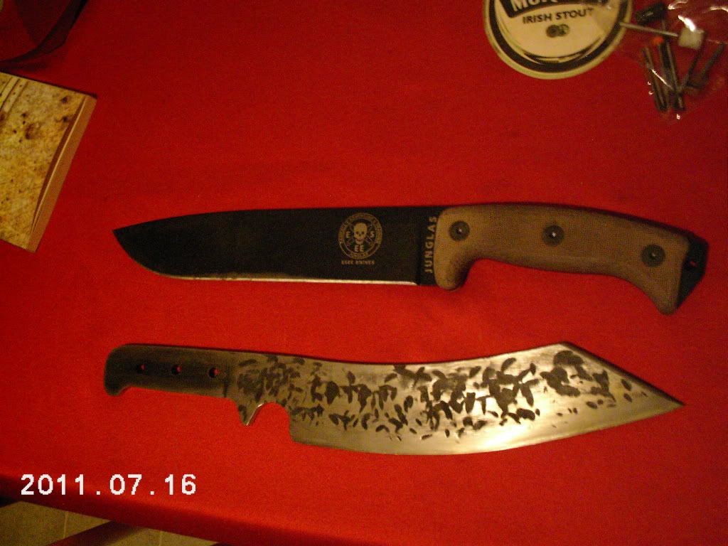

It looks like its done guys. Is this your first knife?
Second one forged from scratch.
The other one thinned to a tapering edge more, which befitted it's intended use as a kitchen cleaver.
This one is intended as a tough as all hell knife, so although a TAD more taper would be okay, it wasn't needed.
I bet it'll outchop the Clax...the stock is thinner to begin with, it weighs 7 ounces more, and the edge taper is less acute on the Clax (doesn't show as much on mine yet as I didn't polish the convex bexel up all the way after bluing yet).

IMG_7619.jpg~original
IMG_7624.jpg~original

Just curious, what method do you use to determine enough heat for forging and quenching temperature? How long did it stay in the fire?
For hardening, I went with non-magentic (when the magnet won't stick).
That's also a glowing cherry red type of colour.
For forging, I was generally going for red hot. I had to run from the forge-pit-thing to the shed where the anvil was.
Sometimes it was in the coals for 10 minutes-25 minutes. For hardening, I had it in there a good 10 minutes at full heat at least, between 10-15 minutes. I normalized it once, and after that, I had it in the coals for about 30 minutes before cranking the temp up for getting it ready for heat treat.
A proper forge with an actual read-out would be SO much better and easier. The magnet can let you know when you're about hot enough, but not if you get too hot. I doubt that it got too hot, given the time it took along the way at times.
At least the omens were positive.;)
Went through 38 POUNDS of charcoal that day!:eek:
