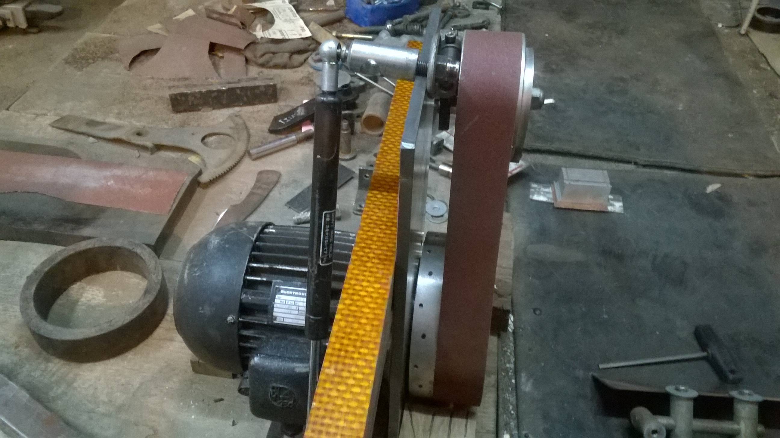

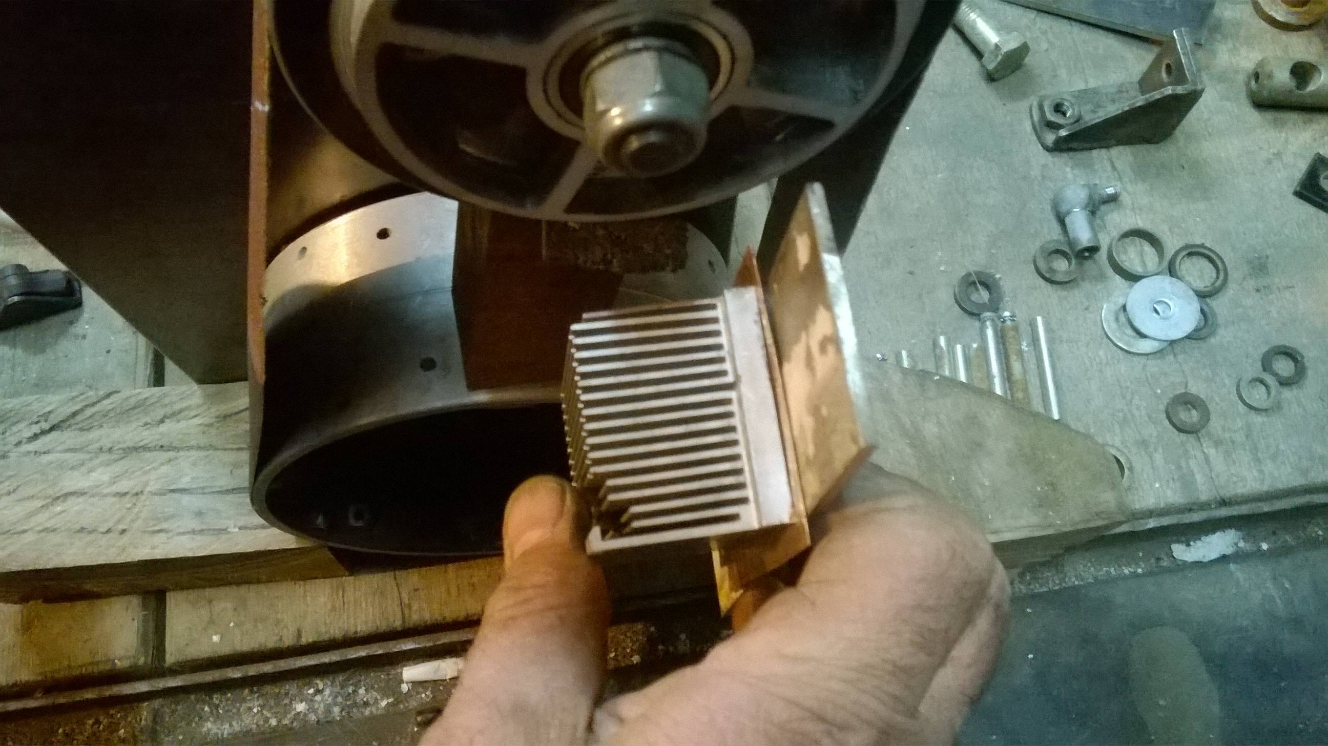

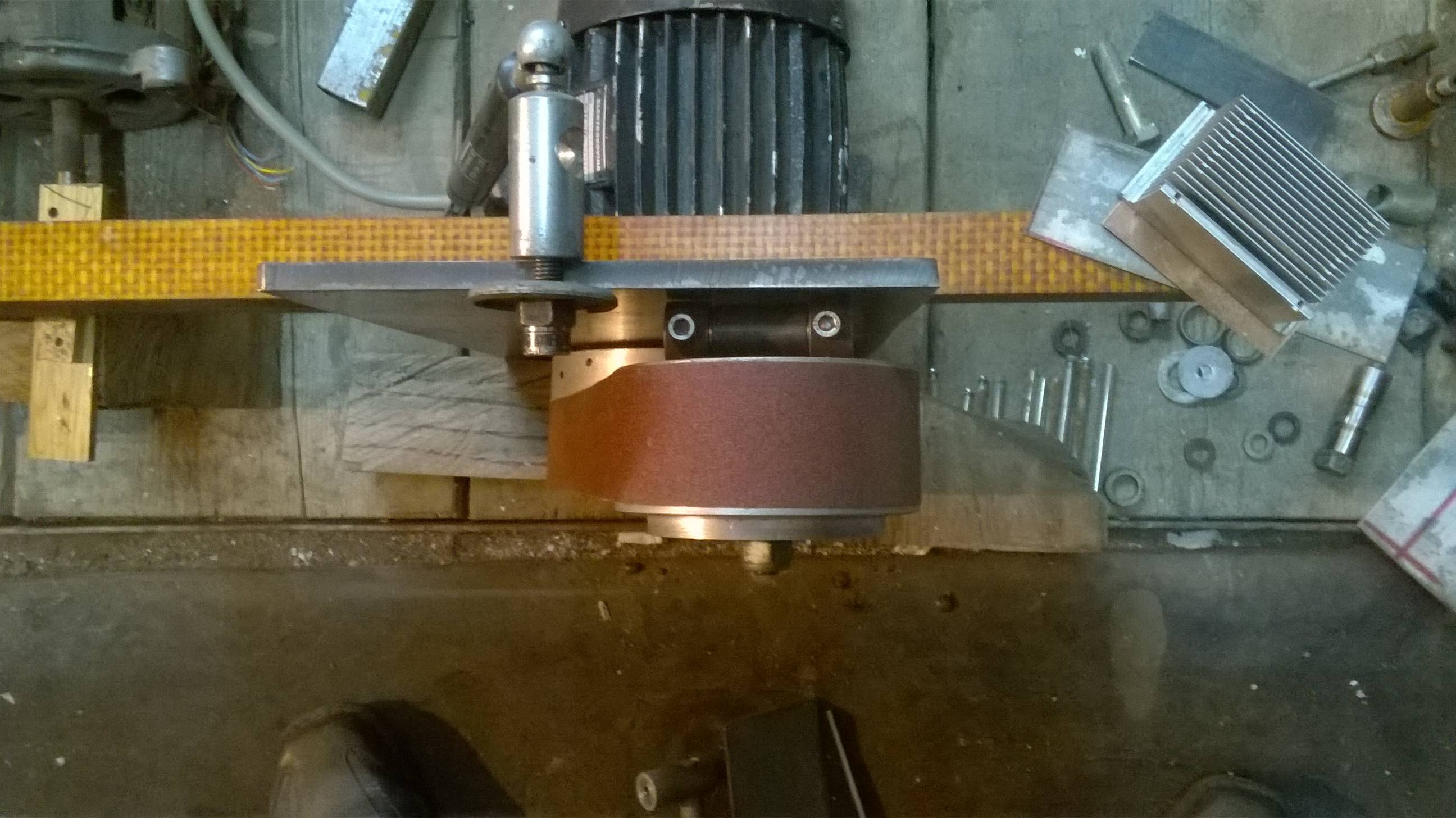

I drill hole for motor in plate , M10 thread and installed motor . Now things will go faster .I decided to make complete grinder with option for 2X72 belt with big contact wheel .Need to decide what to use for arm ...both a heavy :mad: I order steel plate little bigger to make me easy to take precise dimension where will be tracking wheel and position on tension arm . Basically , I will cut tension arm from plate .It s 9mm. thick which I think is enough.Work rest /stainless/ is almost done , need to drill only two hole and as you see on picture will be adjustable in two way ....Steel plate which will go behind belt is from very wear resistant steel /it is from long straight saw with diamond for cutting marble and granite / and will have cool cooler behind :D

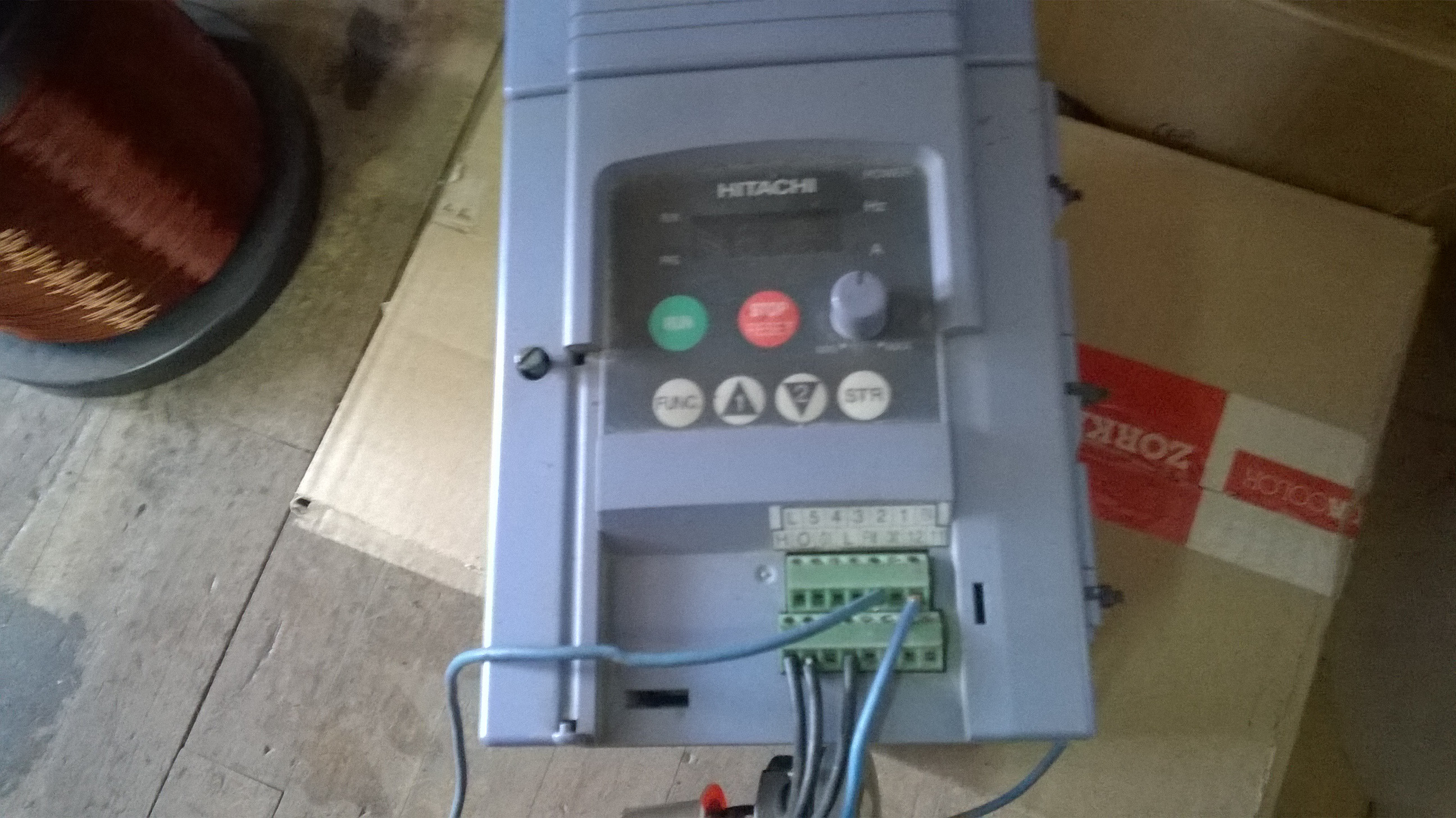

One more question and I will no more boring you :) Can I run my 2HP motor with this 5HP VFD ?
That VFD is a 300-460V in/out type .... do you have 400 VAC in your shop? IIRC, Macedonia uses single phase, 50Hz, 230 volt two wire as the standard line voltage.

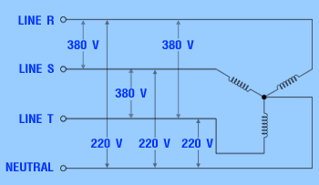

Sorry Stacy .I avoid AC current all my live .Know nothing . All I know is that here between two phase we have 380V ? If that helps ?
I can get this Hitachi inverter for 100 euro?
Sounds like you are on a 380v 3 phase distribution with 220v single phase wye drop (400v 3 phase, 230v single phase European standard). Unless you have multiple phase drop it will not work.
