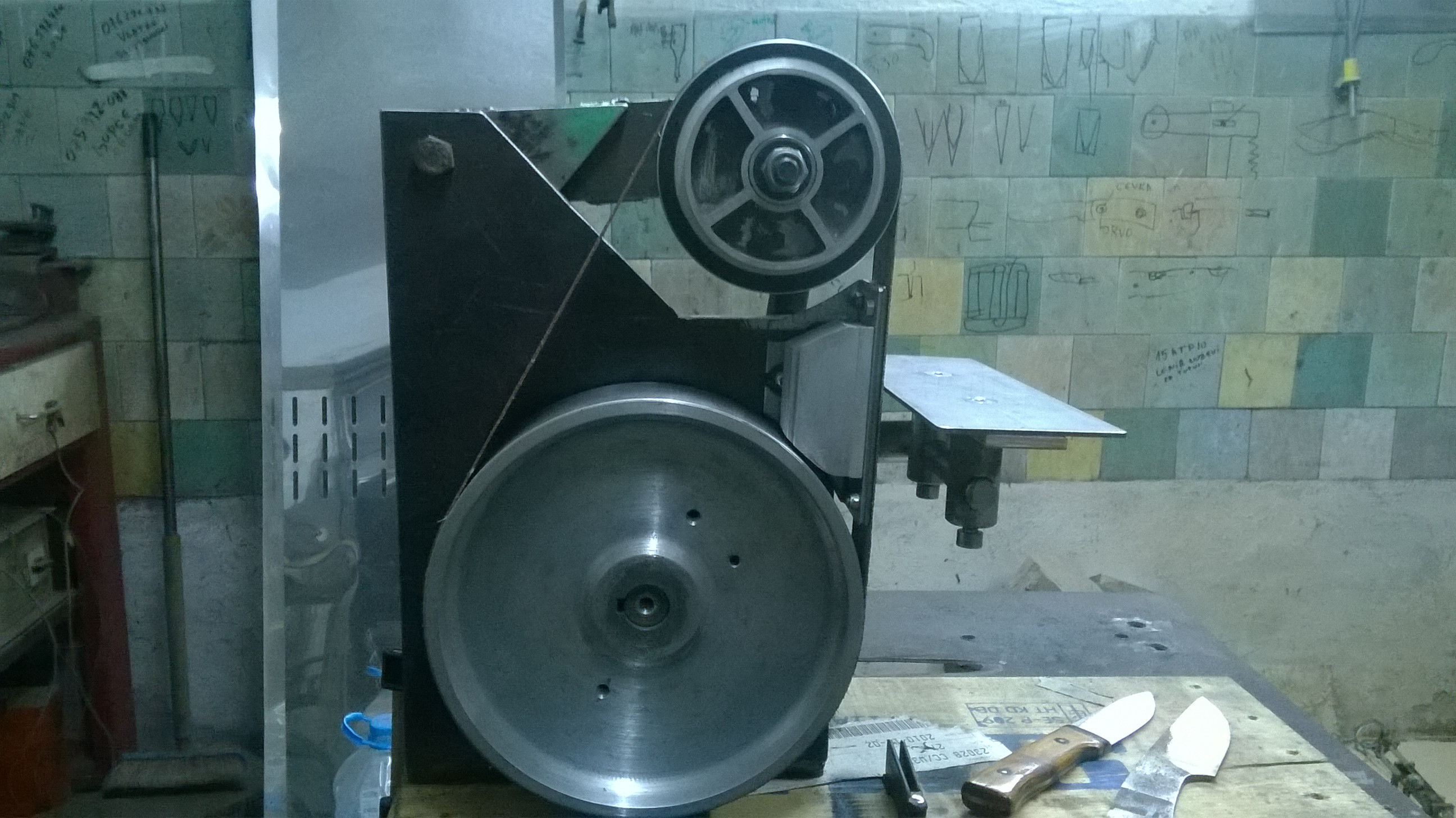

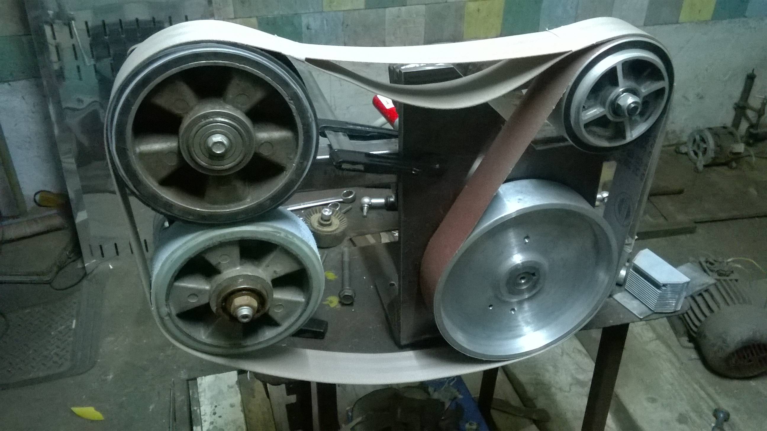

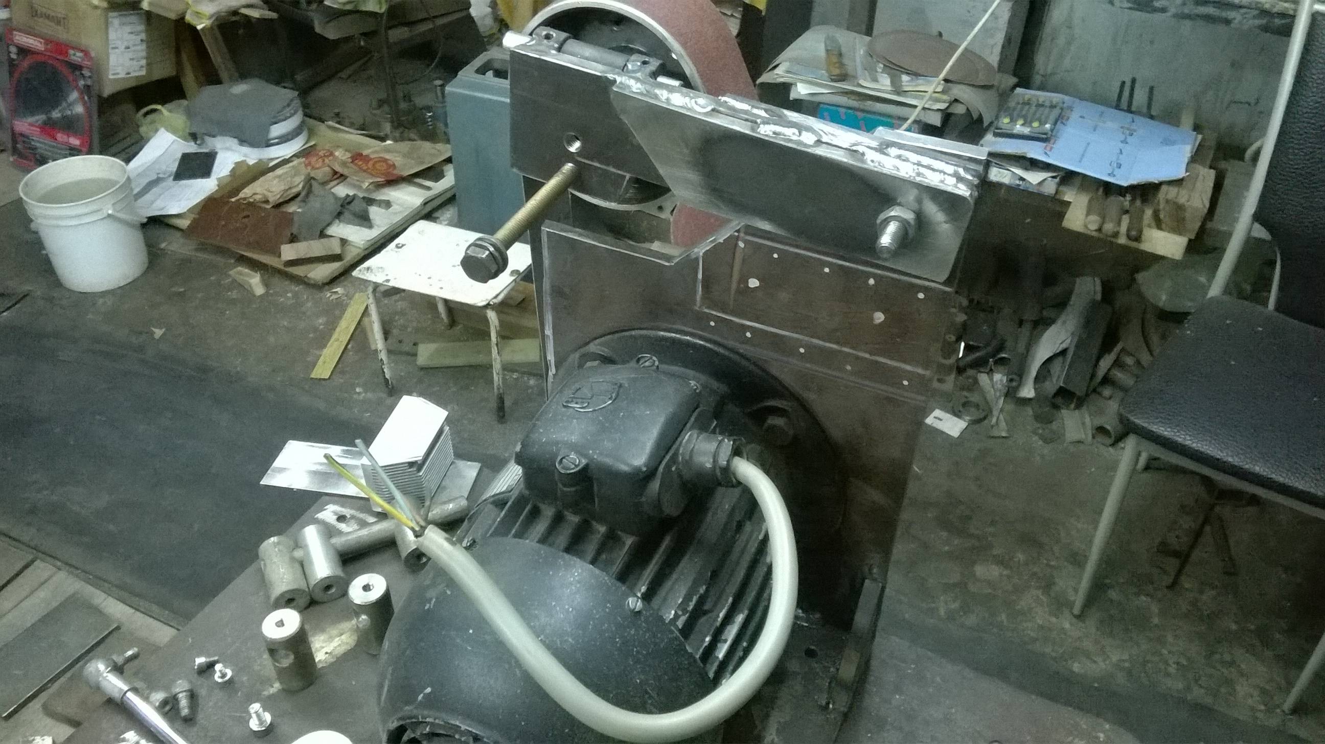

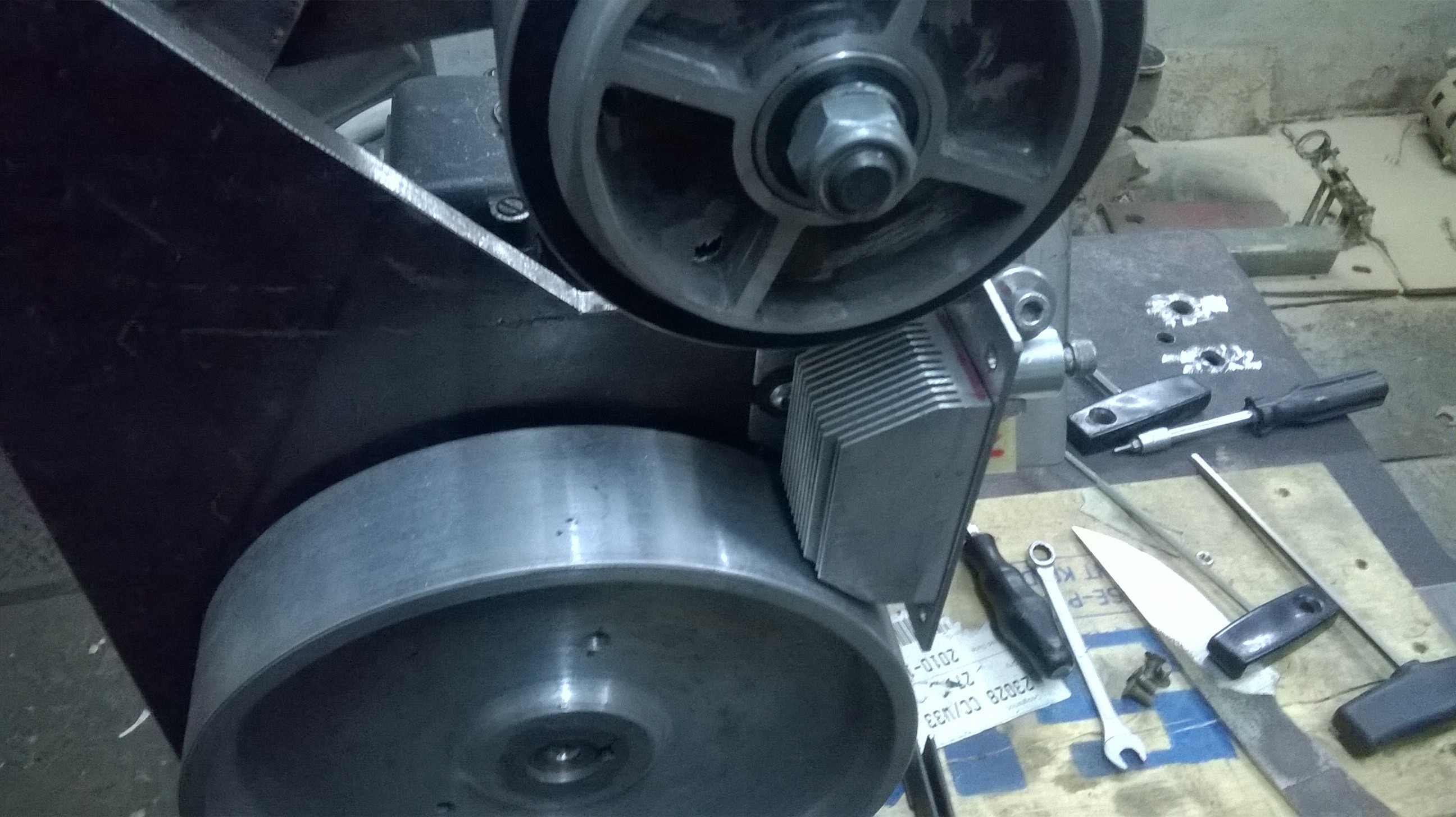

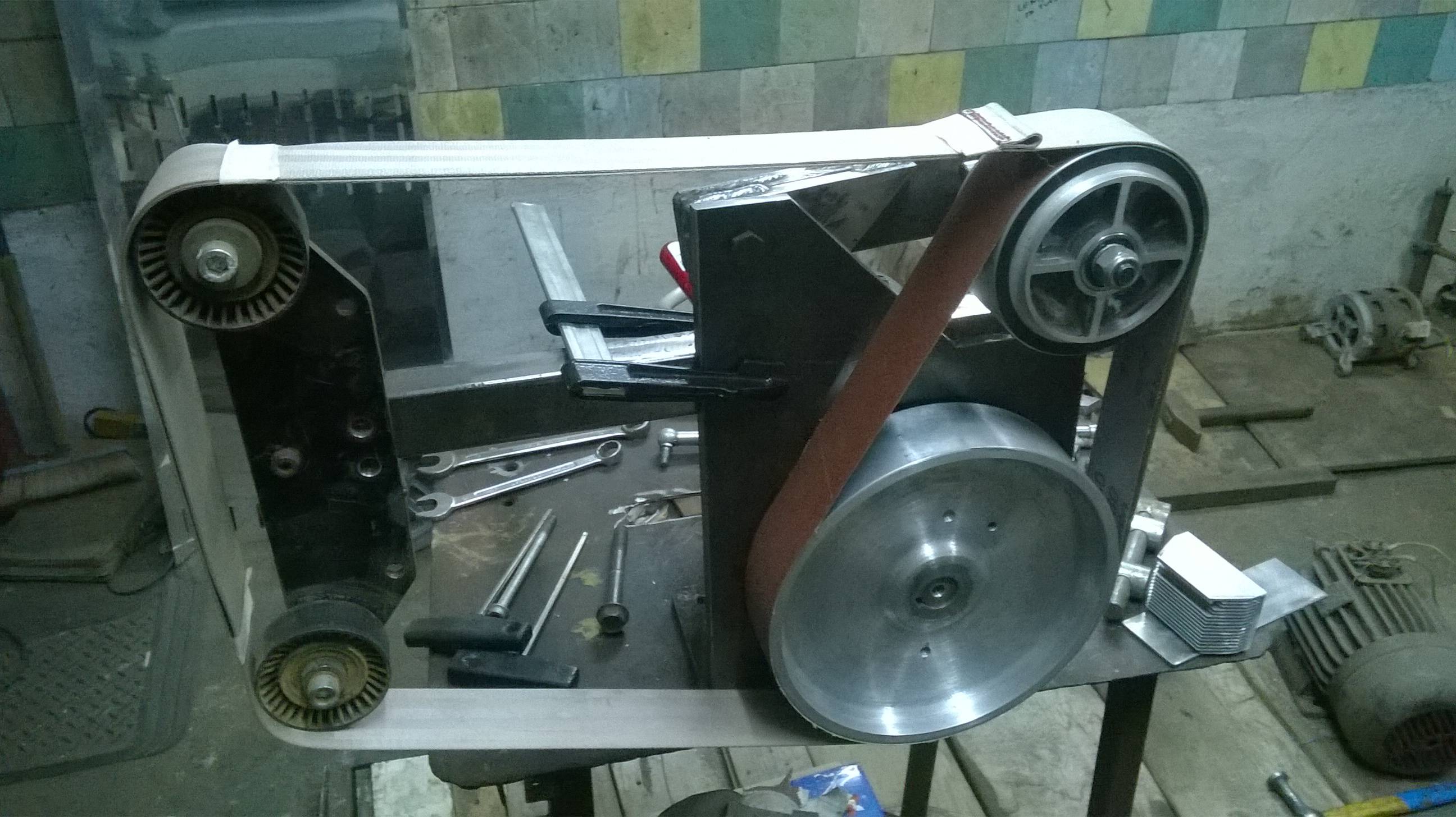

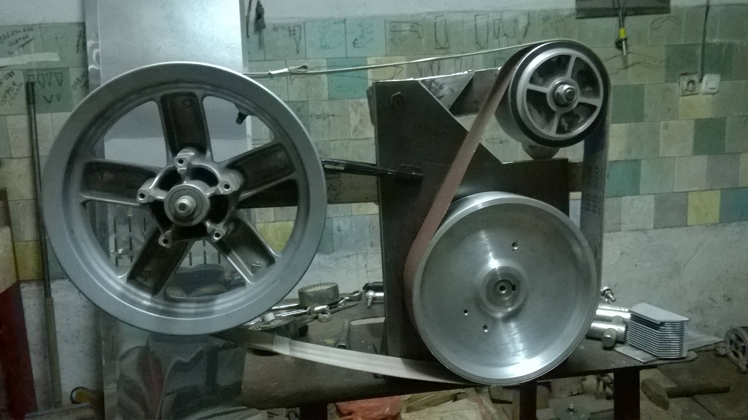

OK , one side for belt 50 X 1020 mm. is done . I must drill another /

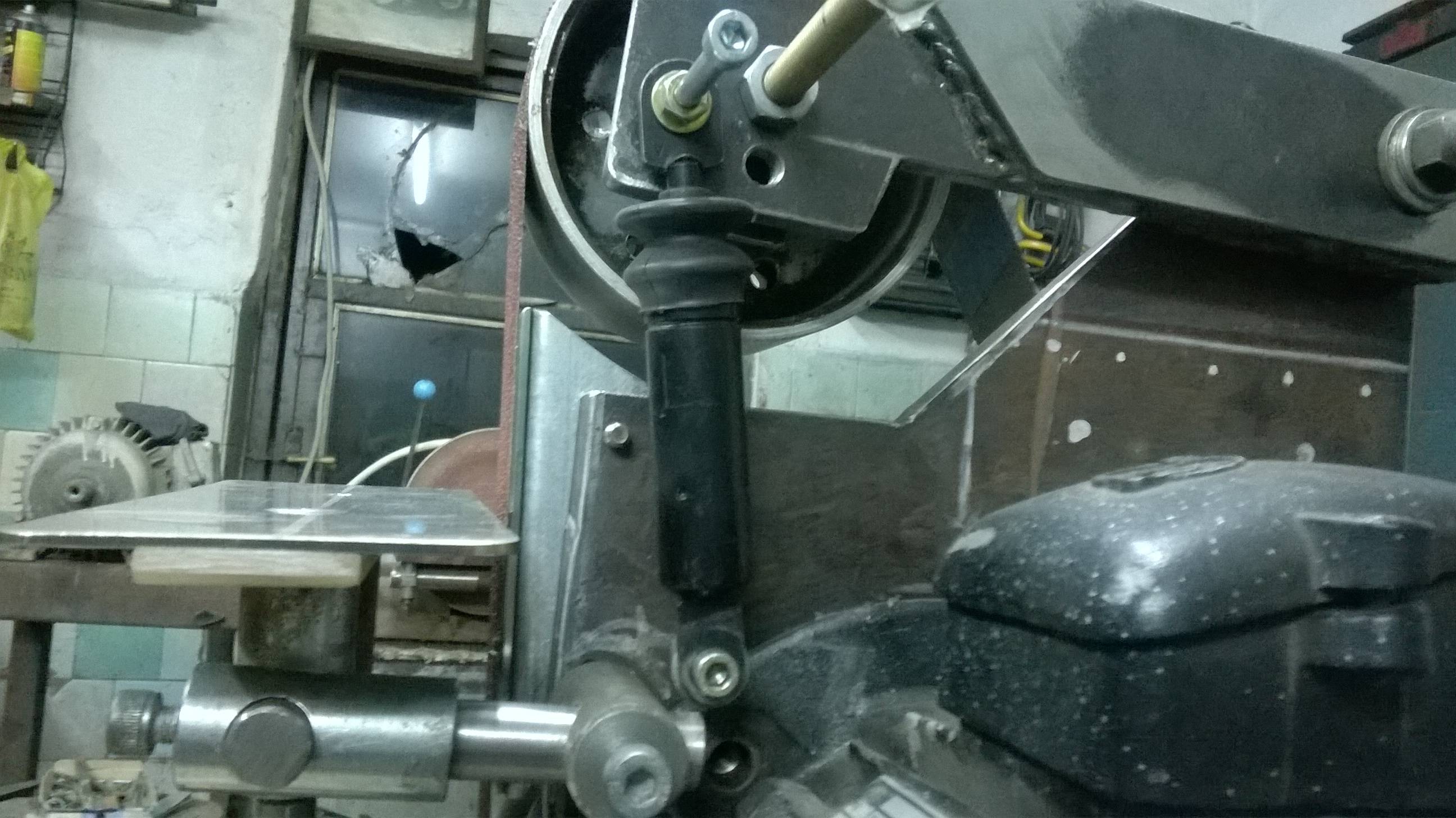

third/ hole for tracking bolt , this two a too sensitive .....I think .But tracking is excellent .I changed the drive wheel ,now is 22cm. dia. which i think I must balanced ? That translate in speed is 32 m/s or 6400 SFM on 2820 rpm/min and 50Hz.With VFD much more :) Remain to install proper tension gas struts . I think spark will be a problem with this setup . . . ? Is there some way to catch them? Strong magnet ?

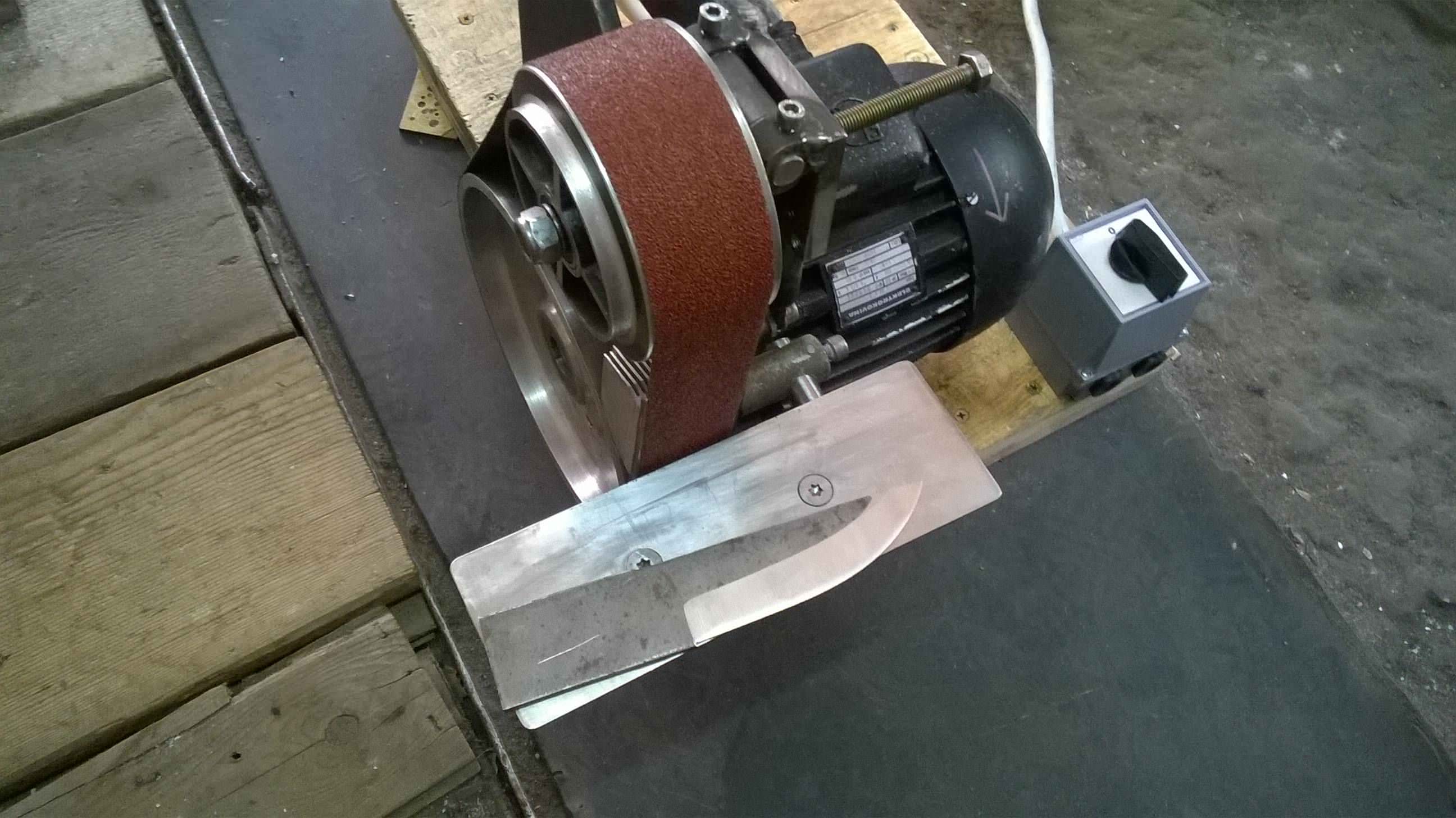

For the other side I plan this . . . . . 50 X 1500 mm.grinding belt....ordinary two 2 inch wheel setup , then one 6 inch wheel/rubber/ alone or in pairs with 2 inch wheel or with another 6 inch and last combination with one big contact wheel .So far I like how it turned out , what do you guys think ?

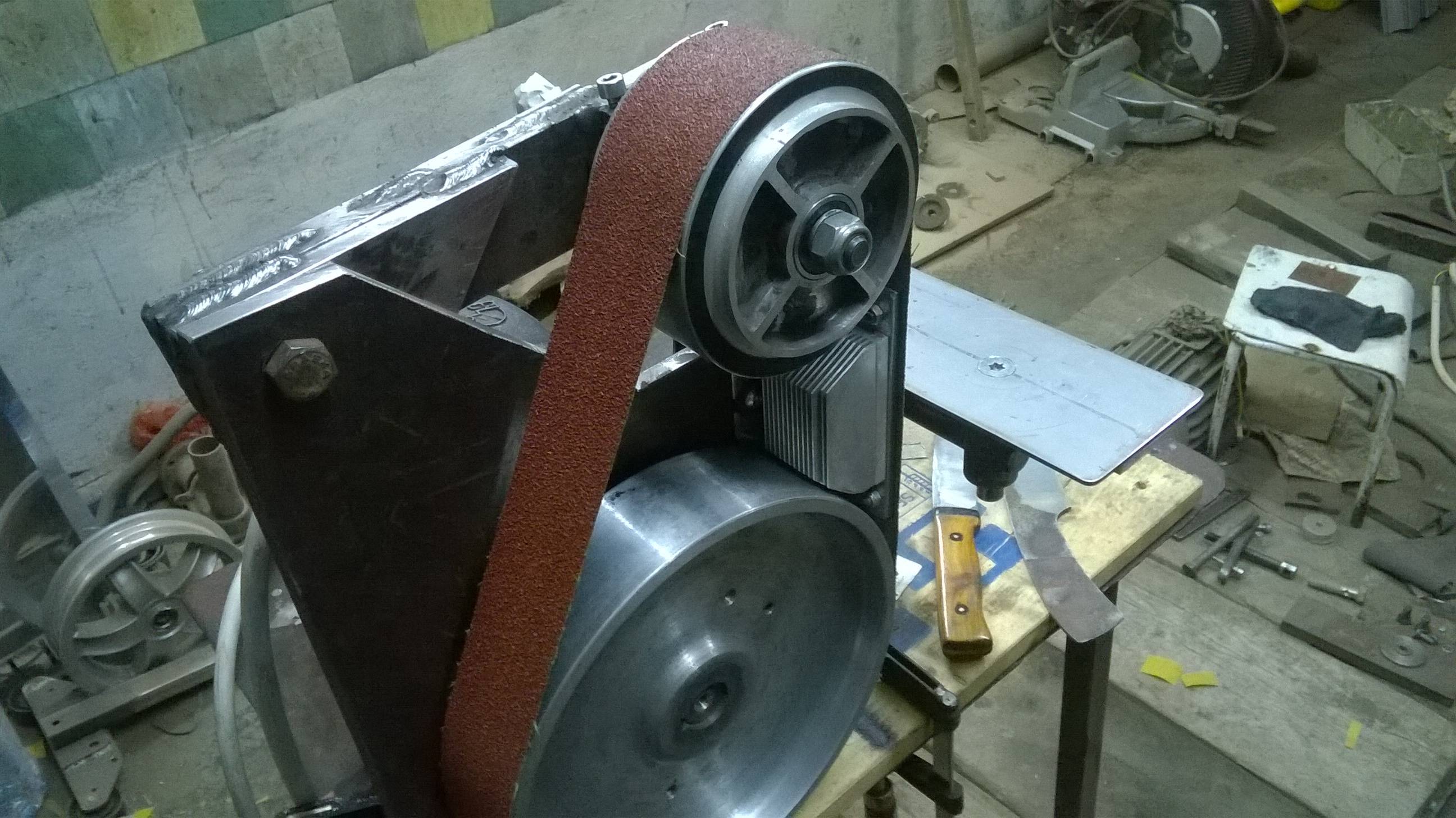

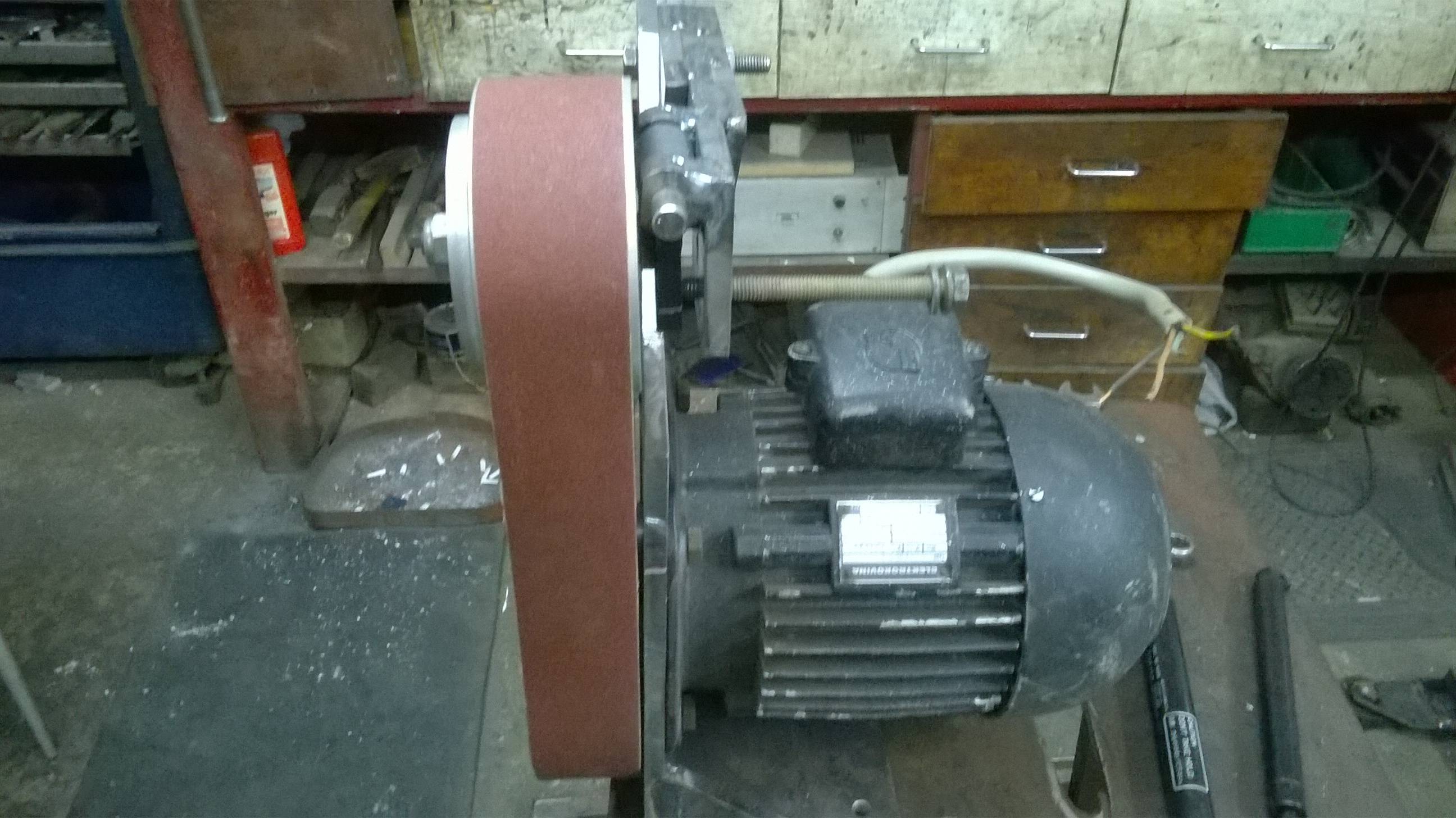

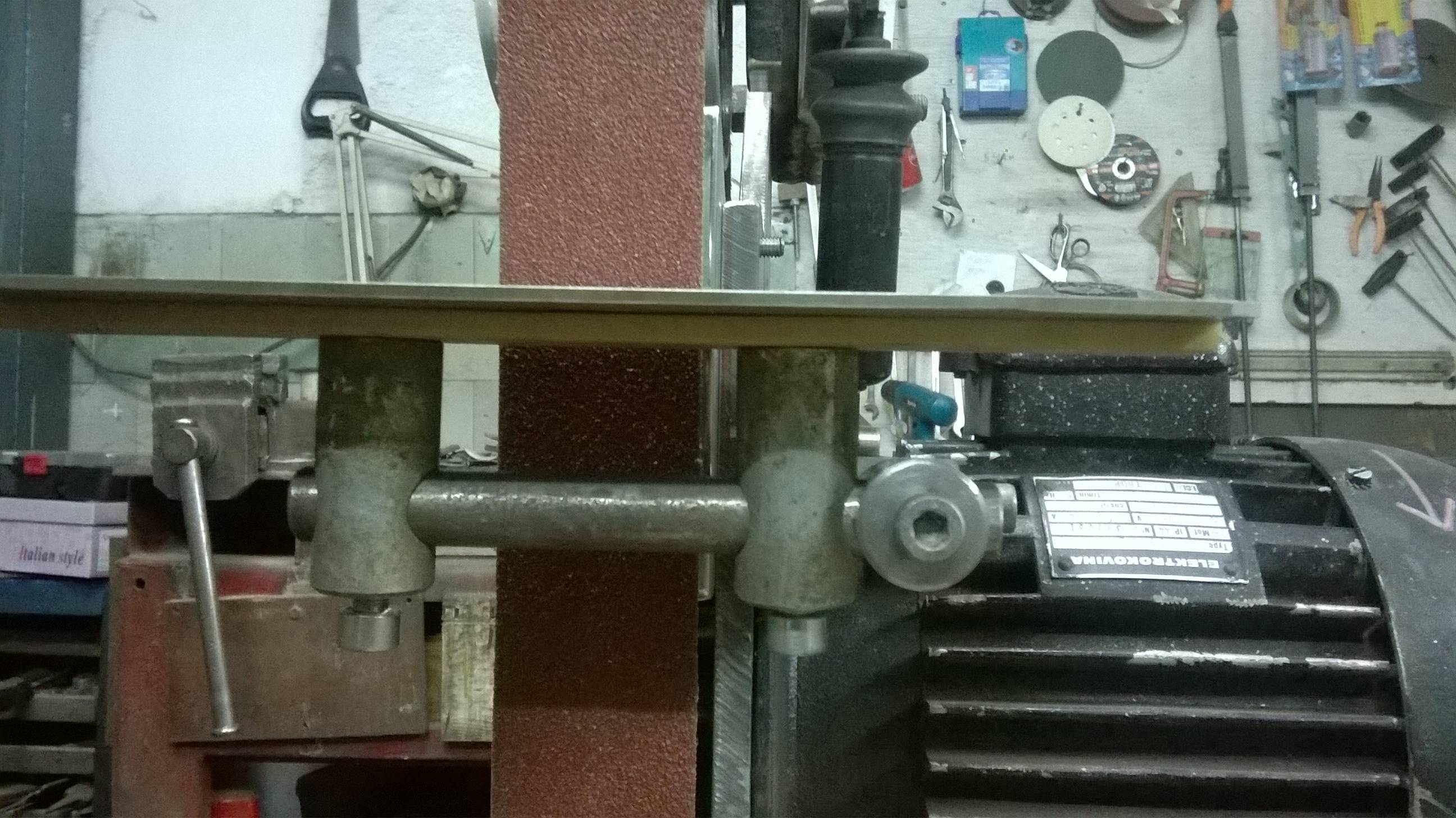

Thanks David ! Well , finally he's alive ...I've created a monster guys :) On 2800 RPM belt speed is 32 m/s and is hungry for steel . I'm not connected yet VFD ... according to my calculation on 60Hz belt should go 39 m/s and that is more then enough for me and safe for motor ...I hope .Now I can not wait to arrive ceramic belts I buy .I bought 50 X 1500 ceramic belts too for other side , in the fall I will do it that side . There are still some small things to do but that is that .I mounted rest plate upside down ,tomorrow I will fit it properly .Here are some pictures how it turned out . I will try to make short clip when I mount grinder on bench . Good news is that it looks like I can grind free hand from the left side too ;) And Finally I can clean the garage ..................

I think it is wise to protect gas spring from dust . . .

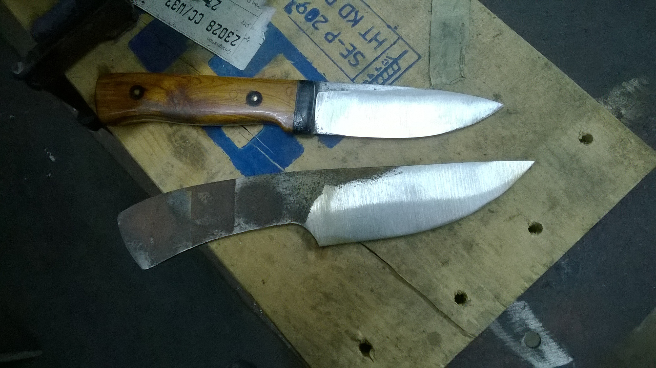

Probe successful . .. . . :)
I hope you like it :thumbsup:
I don t think it looks good , but she works good :thumbsup:
I use google translate every time when I need to write this comma ' I use German keyboard , letter Y and Z have changed place . . . blabla :) Yesterday I tried again to grind same waste steel . I really like how fast removes material. . . This fancy cooler works , get warm real quick but not hot .I will install small fan....maybe :D Pulley , belt and motor creates enough airflow to cool this cooler . This is my first contact with belt grinder / if we do not count bench grinder with belt sander in my service / and now I understand what all you talk around the grinder.

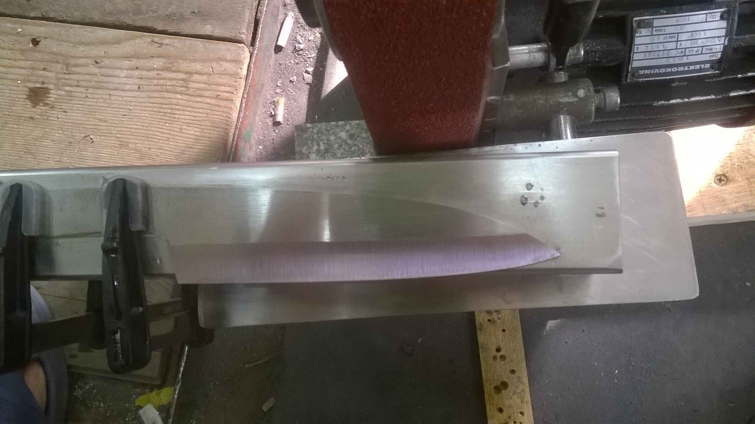

But now I have crazy idea how to make jig for perfect convex grind . . .

To late ......it was already named SCRAP-YARD-MONSTER :) Tracking is perfect , once adjusted on one belt and I've tried all belts I have and no need for additional adjustment . Belt running straight ,there is no walking left - right . I quick learn that plate behind belt MUST be perfectly flat and fine surface without any recesses . After half an hour of grinding I can say it's great tool and very quiet . I give up from the first idea. This one remains like this .I work on another one . WFD , three-wheel and 4 x belt . . . .. and scary fast .
I think that this is good place to ask .Well this scarp yard grinder works perfectly ,with VFD is screaming fast which I like . Problem is I cant slow down this thing , motor is not inverted rated and heat very fast if I try to slow down . . .so I can t use fine grit belts and to do some work on woods . Now I am building another one and I will use step pulley .Here is how I think to make ratio on step pulley . . .

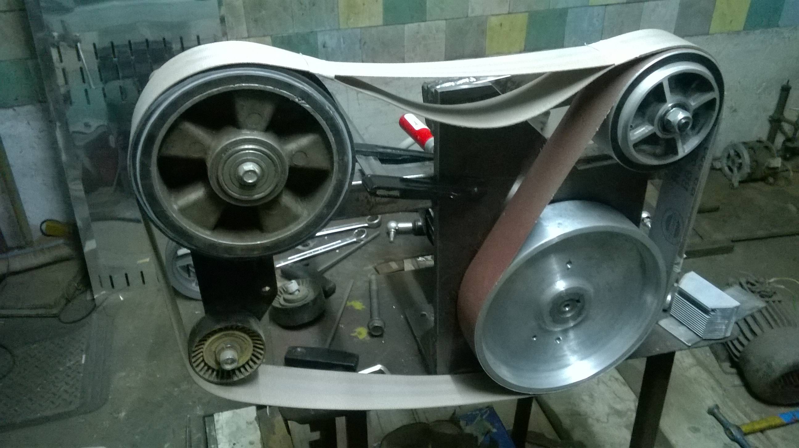

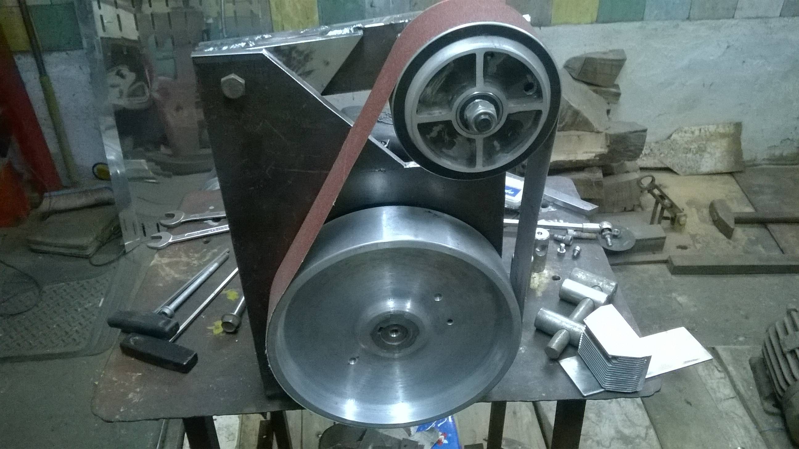

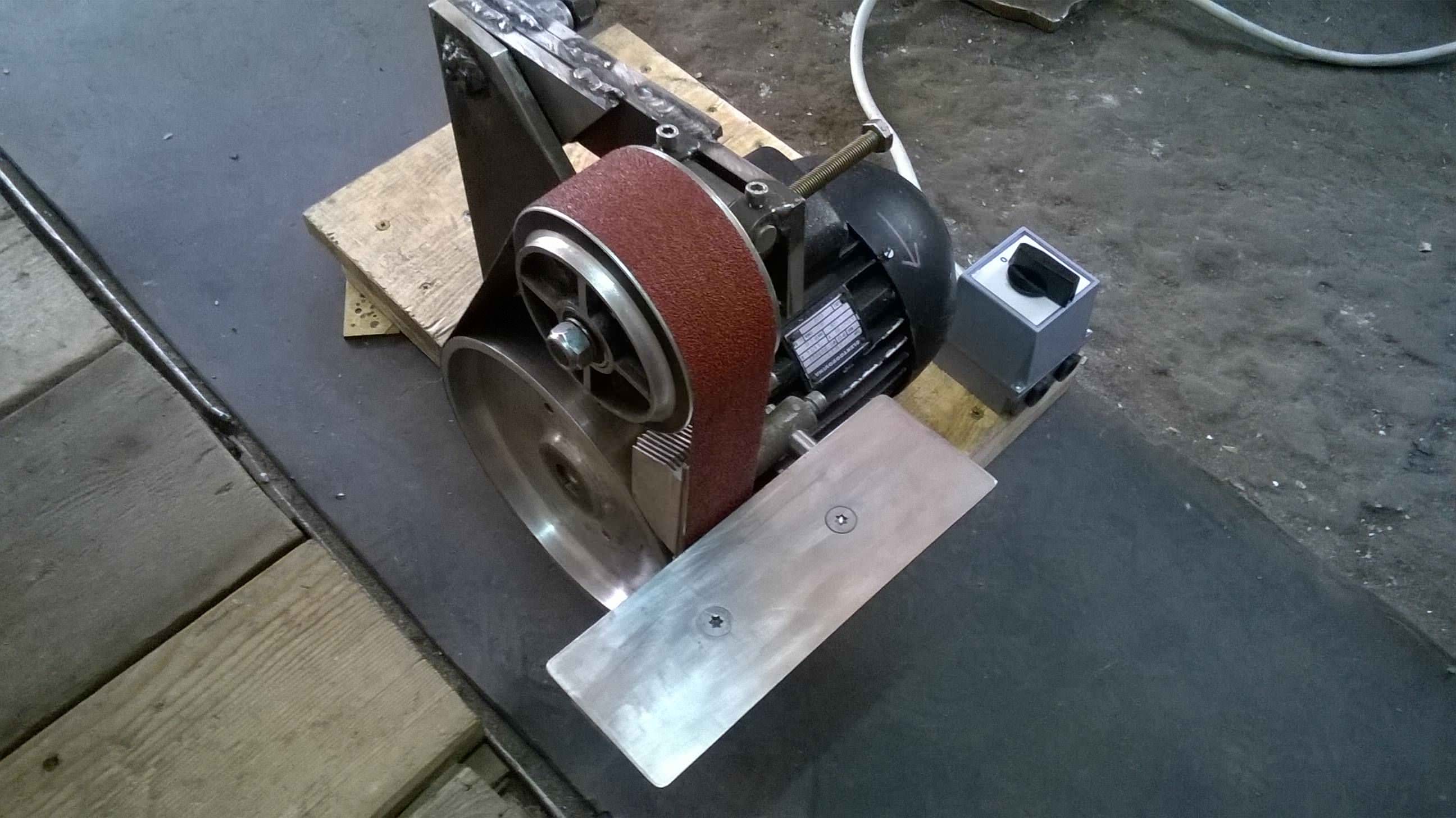

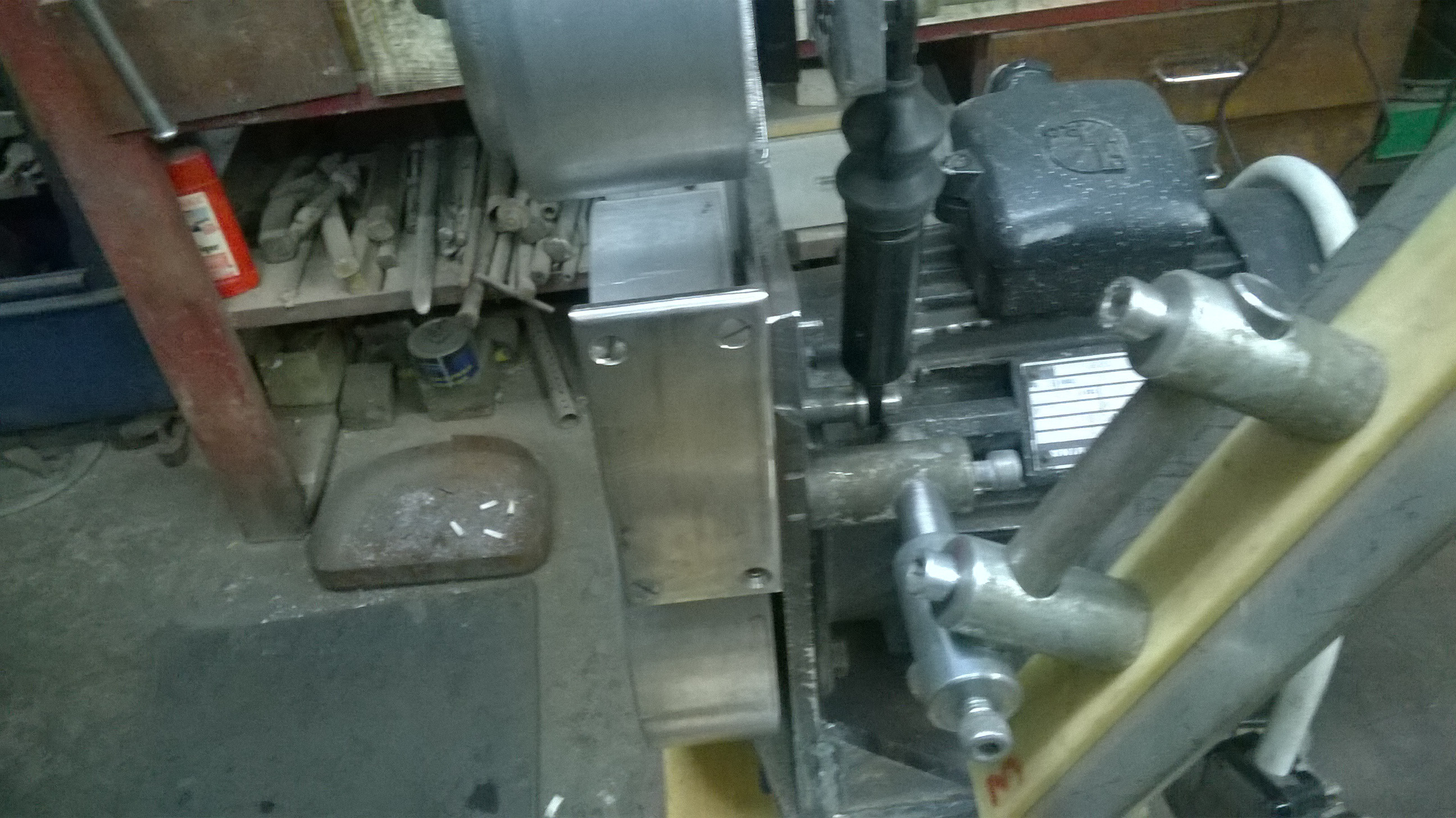

OK , I did not give up .........I will make double side belt grinder .
Something like this ..........

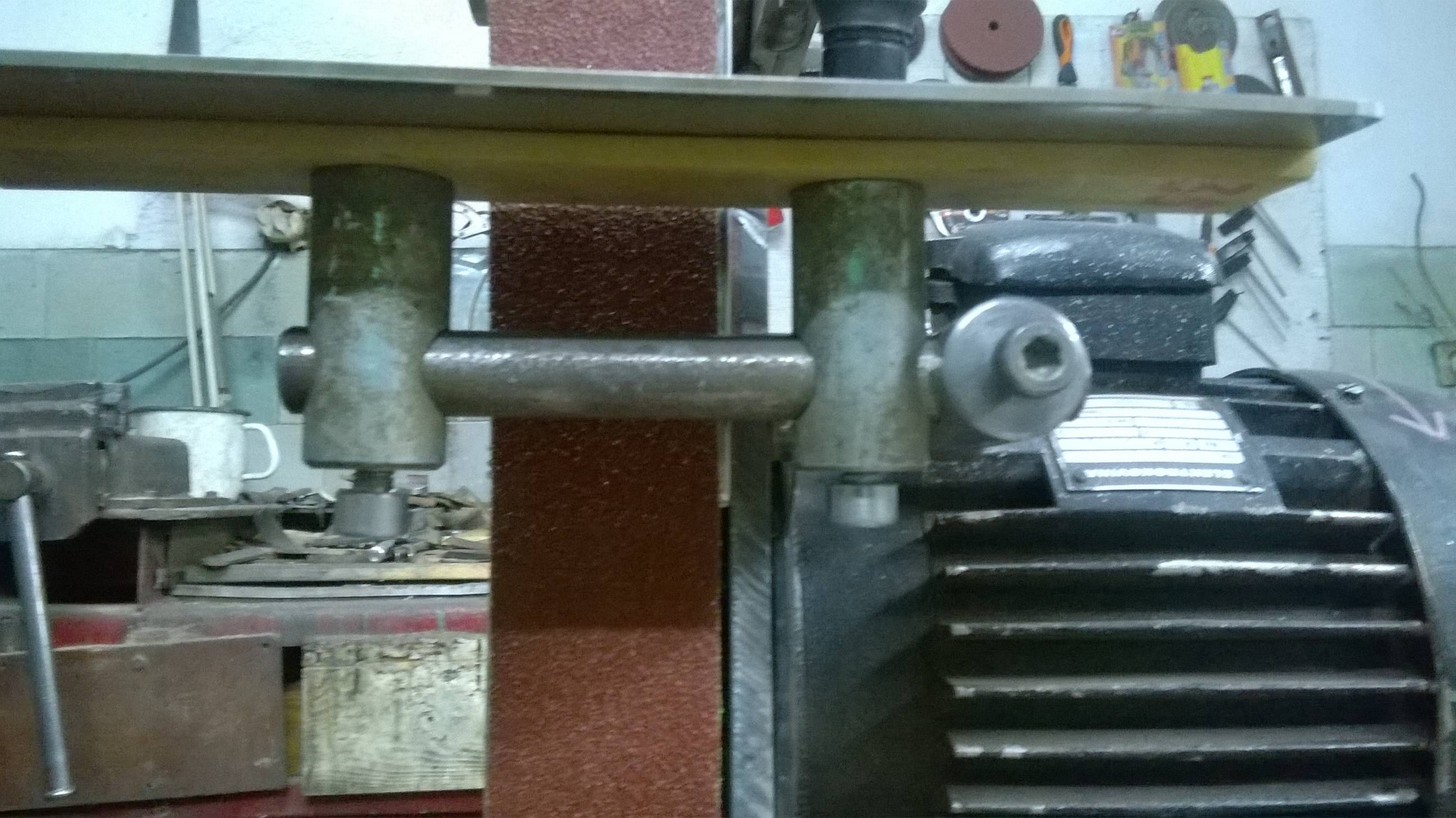

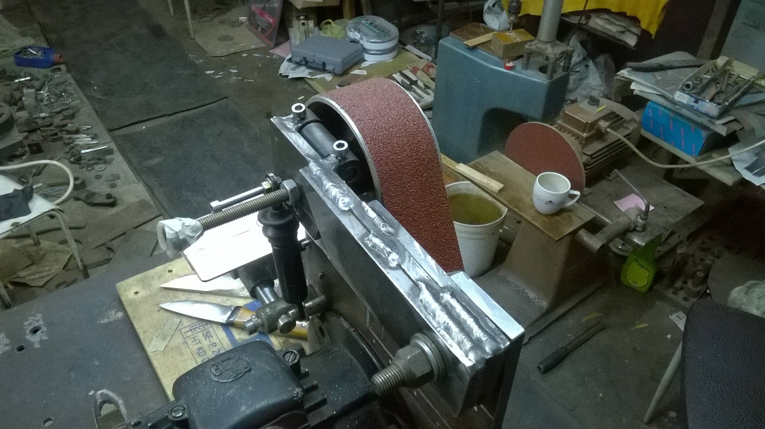

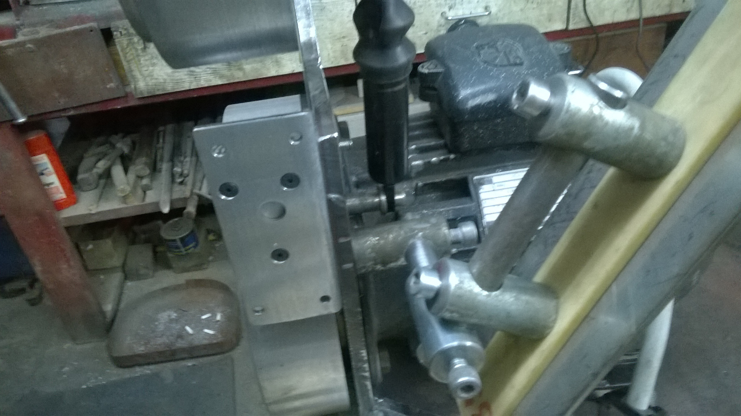

So far I m almost done with one side . ..... I think you would like to see how I make tracking arm and tracking wheel .Simple to made but solid and would last forever ..........I use two 6201 ball bearing for tracking arm and three 26x10x 8mm ball bearing for tracking wheel part . I like to use whatever I found around garage ...........It will be very ugly belt grinder ,but masive and overbuild :)
More picture.....
This bolt is for tracking arm for the other side , for contact wheel side....

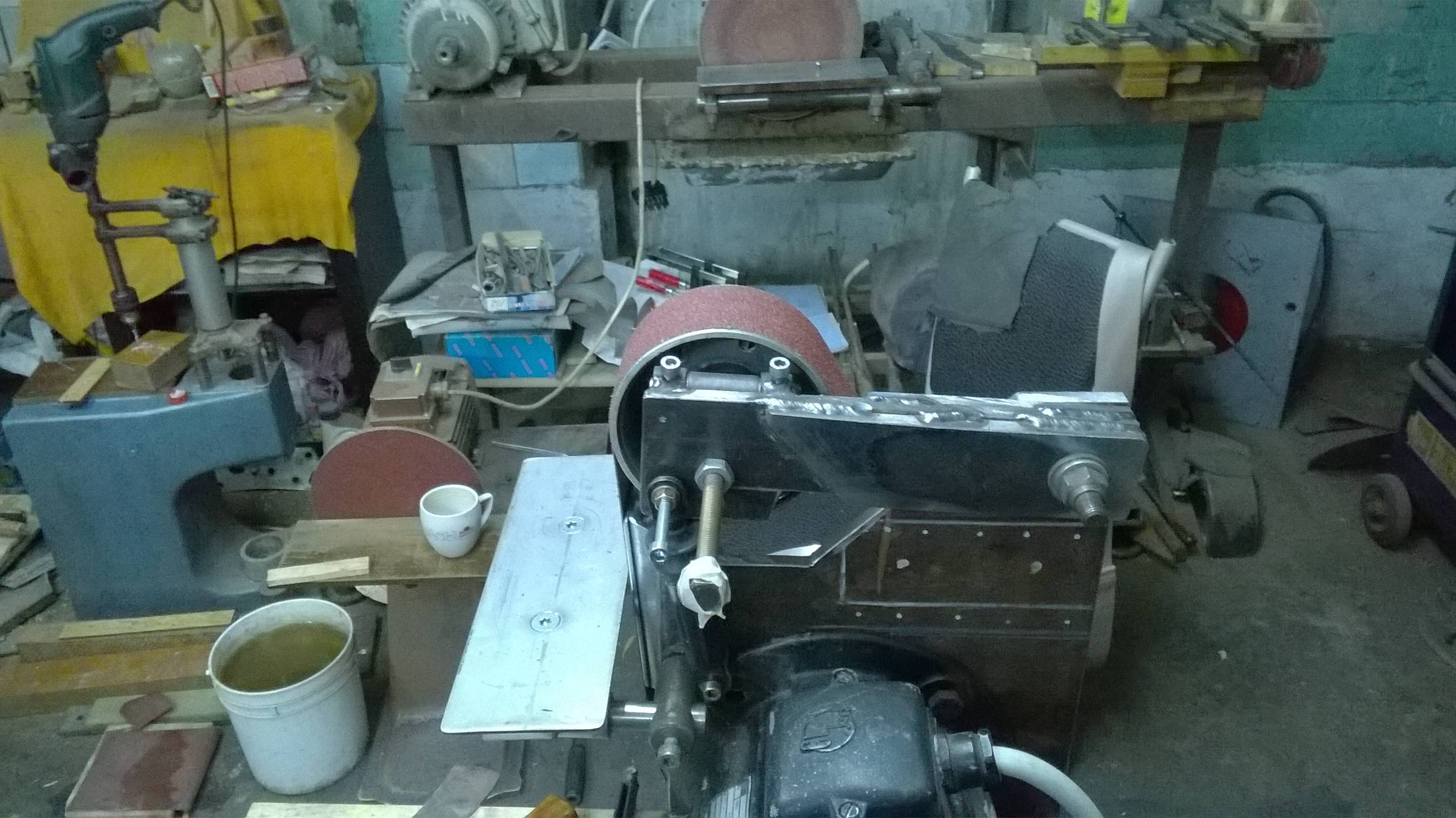

So , what do you guys think about this scrap monster ?
PS . I forgot to mention handle for suppressing gas spring....I can push it with two fingers when I want to change belt ;)
