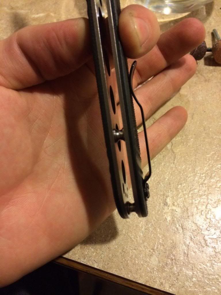

Another problem happens to be the most common issue with this model: The blade contacts the backspacer when it is closed. Many people are installing barrel spacers in place of the plastic, so I gave it a try. I didn't care for how they made the knife feel in-hand, and I felt like they took some of the structural rigidity out of the knife. I sanded the plastic backspacer down where the blade was hitting it, and re-installed.
Here's a photo of the problem:
Here's a crappy picture of the barrels I put in:

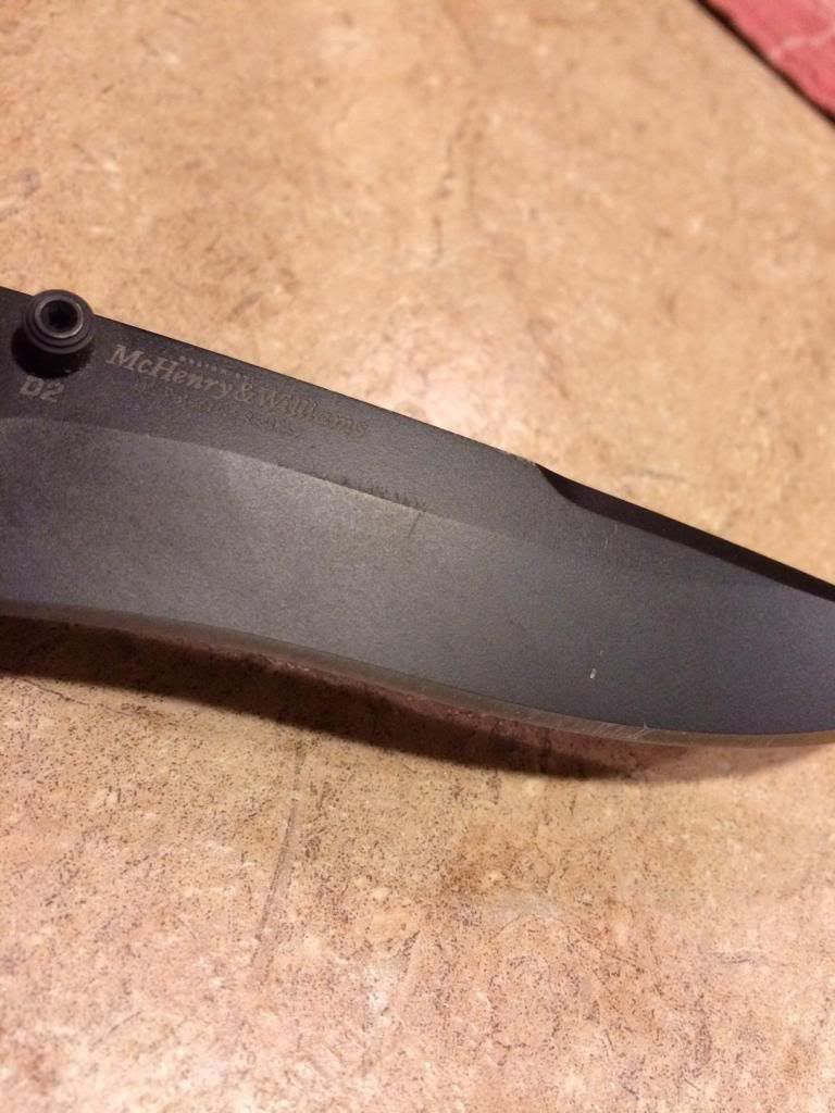

D2 seems to hold an edge about as well as S30V, but it's nowhere near M4 or M390. I usually start new knives at 17 degrees per side and broaden it if needed. 17 was just too thin for this blade. I recently replaced 16 lightbulbs in the house with LED units, and they came packaged in the usual hermetically sealed packages. The 710 went to work on the packages (which damn rear require a plasma cutter) and cruised through the first half. After the halfway point, the knife had considerably more resistance pushing through the plastic. Afterwards, I checked the edge and saw what I had presumed; A neatly rolled edge :( My S30V Paramilitary 2 rolled and chipped while cutting through denim, so 16 hard plastic/cardboard packages seems about right for this blade.
In order to remove the rolled edge, I put a 20 DPS microbevel on, and intend to just continue touching the knife up at that angle from now on. It's not as "freaky sharp" at the new angle, but hopefully the sharpness it does have will last a bit longer. If I can ever find an M390 version of this knife for less than $275, I'd buy it in a heartbeat.
The coating is standard-issue Benchmade - weak. The edges of the spine are wearing off from unknown contact, and the lightbulb packaging put a nice rash on the transition from the flat to the bevel. There are other dings in the coating, but I am completely unsure as to where they came from, and the pocket clip looks like a Picasso painting.
Spine rub
Bevel rash

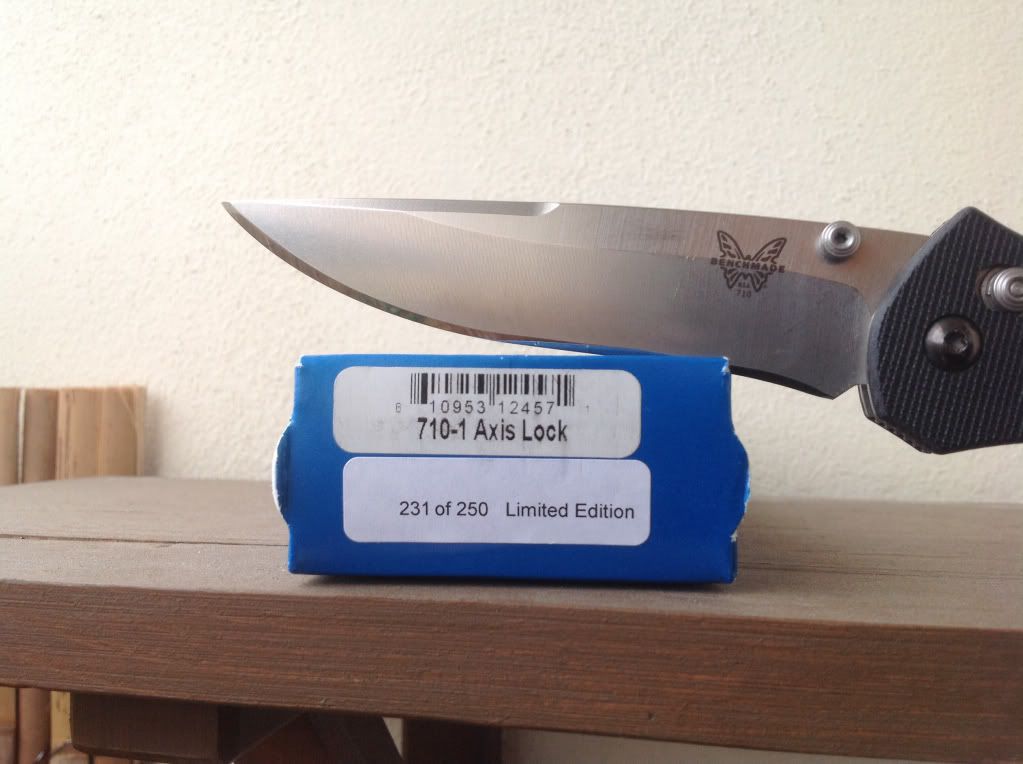

Thanks to 45Shooter, I now possess a 710-2 with the always-delicious M390 steel.
After carrying it for a few days, I can't figure out why it took so long for me to get one of these. The fit and finish is better than that of my 710D2 by leaps and bounds. The pivot has 1/8th of the play, the bevel is straighter, the blade is centered when closed, and the action is smoother after disassembling it for cleaning. However, I did need to shave the backspacer as there were slight signs of touching.

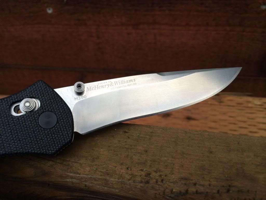

The M390 is as expected; Outstanding. It took on an EXTREMELY sharp 34º inclusive edge and has held it without any sign of performance loss with use. The D2 couldn't take an edge this fine, and it seemed to prefer a very toothy edge due to the large carbides.
The sharpness of this edge made itself known when my pointer finger slipped off of the rounded spine (the D2 version is square). When I retracted my finger it brushed against the edge, cleanly removing a disc of skin from the tip. I only noticed the event when I saw the skin still sitting on the blade before feeling the blood running down my hand.
Skin disc
Just the tip
Overall, I would say the addition of M390 to the 710 has turned an already good knife, into a near-perfect knife. My only qualms with the knife are the plastic backspacer (which the blade hit), and the very tiny amount of the thumbstuds that sits above the curvature of the spine. I know this is nitpicking, but moving the studs towards the edge ~0.7mm would make the rounded spine look a little less "afterthoughtish".
