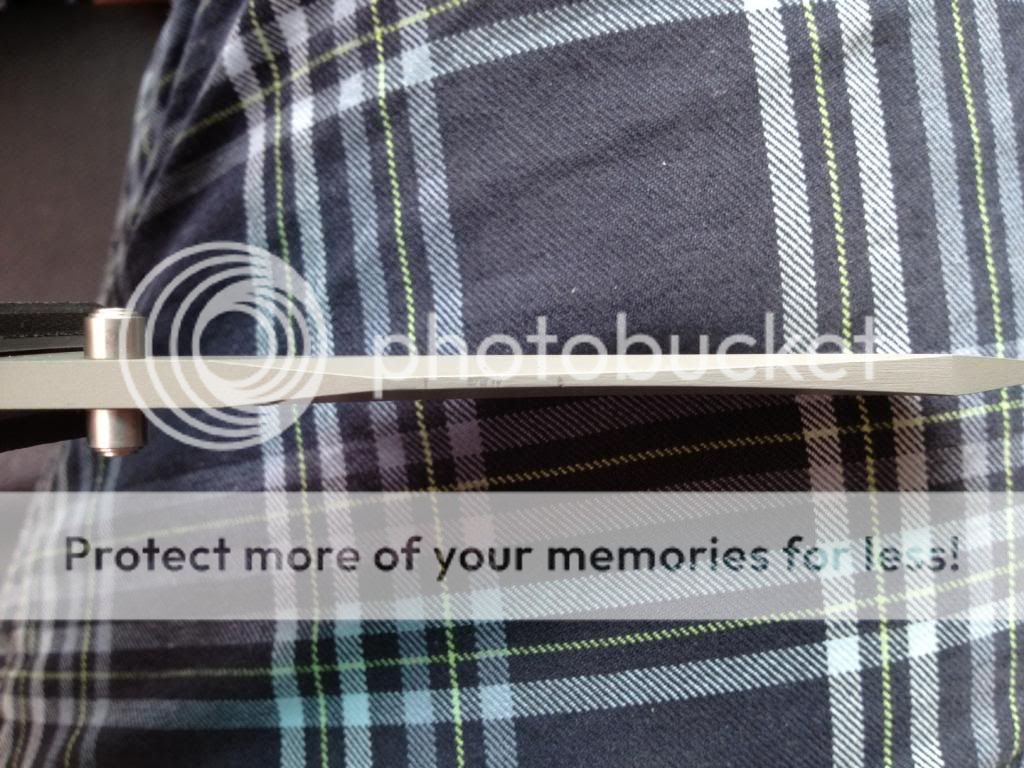

Even more unexpected was the front-to-back blade play I noticed a bit later. After further inspection, I noticed that the batonning (or something) slightly damaged the liners where the engaged Axis bar sits. If you look closely at the liners in these pictures, you can see the bulged material...
The blade play is slight, but noticable if you know knives. This won't prevent me from using the knife, but I will definitely be dropping this one off at the factory next time I drive up to Portland.

Now I understand why they recommend when you baton with an Axis lock, you leave the blade unlocked and baton on the blade only. That is unfortunate what happened to your new knife. I just have to ask.... Why baton with a folder?? NOT being a troll, please don't take offense, but it just seems like an unintended use for a folder.

I was batonning as a means of pushing the limits of the knife. If I was stuck in the woods with only the 810, I need to know what it can do. This run was purely experimental, as I have choppers.

I understand the concept of testing equipment, however, I believe we could have told you, definitively, that your action was ill conceived. Some would question your intention of asking BKC to warrant a product that was tested to failure. Personally, I don't see anything wrong with them fixing it for free so long as they understand what happened.

If Benchmade doesn't warranty it, I'm cool with that. I went above and beyond what could ever be expected from a folder. Besides, the knife is still fully functional. Who knows... Having the dented liner may provide a secure pocket for the Axis bar to sit in, making the knife even safer :D
