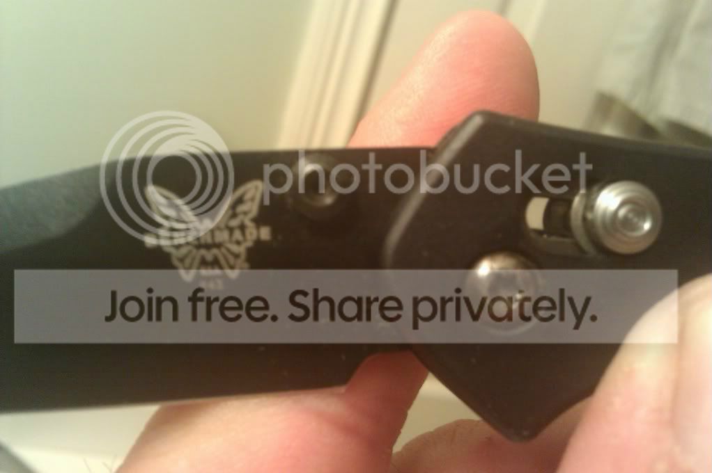

About a year and a half ago I picked up a Benchmade axis lock. A 943 Osborne, witch I considered a high end/high dollar knife that would last me, and maybe I could pass down... But just tonight... the pin failed to set the lock (pin should be up in pic).

I thought the Axis lock would still engage as long as at least one of the springs was working. I can't imagine both springs broke at the same time, so either something else is wrong, or it actually needs both springs to function.

It looks like the blade isn't touching the stop pin...thought it's hard to see from the pictures.
There wouldn't happen to be something in between the stop pin the the back of the blade? Broken omega springs are pretty obvious (I've had two), since moving the Axis bar back suddenly becomes easier and grittier--yet even on my broken ones the blade still locked solidly open.
I've had 3 broken springs by now (2/2 on a 710HS and 1/2 on a 707) and the axis lock works with one broken spring - it's just easier to engage. My guess is that one broke and highwaychild just didn't recognize it until the second one broke.
