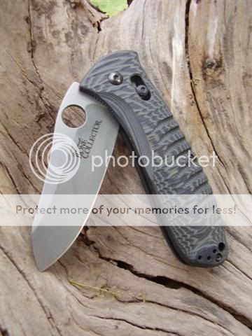

This is going to be a bit of a criptic review and hope you can bear through it.
Stats:
• Sizes (what blade size and what handle size?)
Blade Length: 3.36"
Overall Length: 8.20"
Closed Length: 4.84"
Blade Thickness: 0.125"
Handle Thickness: 0.735"
• Materials (what's it made of?)
Blade Material: D2 Tool Steel
Blade Hardness: 60-62HRC
Blade Style: Drop-Point
Weight: 5.59oz.
Clip: Tip-Up, Black Steel, Reversible
Lock Mechanism: AXIS
Initial impression
General observation, its hefty, but a nice feel to it. About same size as my Insingo, blade stock just larger spine to incorporate hole, thicker handles. Texture is great on the handle. Did some quick hard cutting on wood with knots, the hotspot on my pinkie due to framelock cutout (thinner area on handle) is not there on this. Same hotspot between my index and thumb, soft piece of skin. Will do some more cutting with gloves. Pocket clip is very nicely done, far enough from scale for thick pants yet not uncomfortable.
Introduction
Blade is not perfectly centred. Edge did not come shaving sharp. Cut out line due to laser cutting in thumb hole.
Comfort
Freaken awesome. Looks great, feels great especially when harder cutting. Little to no hotspots when hard cutting.
No blood yet on handle, but with soap became a bit slippery, think some aggressive jimping and more thereof would help in this regard, but that might create unwanted hotspots?

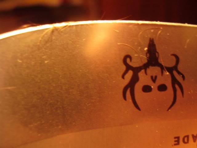

A lot of food prep, fuzz sticks (video) and a few boxes, had to do a few small fixes around the work place and did some cutting on a tile, the edge did not want to cut telephone paper cleanly but is still able to cut 80gsm with some drag on the edge (video), inspecting the edge revealed no chips, but slight role near the tip on the belly after a week of EDC and no touch ups on the strop.
Stropped on 1200grit wet and dry sandpaper and then on leather. 60 Strokes per side and then altering 20 strokes brought back to shaving sharpness and put a nice little convex on the edge.

I have read many people complaining about sharpening D2. In my experience this has not been the case.
I used 1200 grit wet and dry sandpaper with a metal polisher. It made stropping the edge and maintaining it very easy. Then strop and it is shaving sharp.
EDGE (initially)
Stropping on 1200 Grit and Leather
