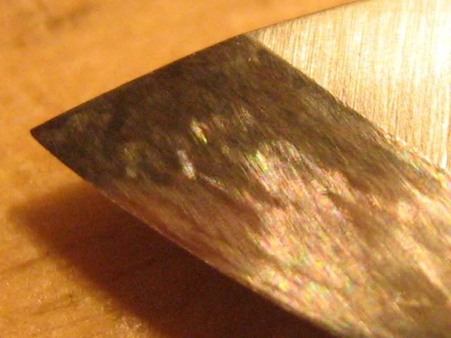

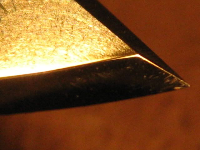

As requested. Sorry for the crappy pics; my poor little point and shoot isn't much good for this kind of stuff, even in macro mode. That said, here goes:
Thanks for looking!

I must really not know how to do that then. Do you really consider this tip to be badly rounded off? Here are some closer-ups:
Good pics and glad things are working out for you but yes that's a very rounded tip. When you get to the end of your sharpening stroke DO NOT swipe the tip off the stone, STOP when you get to the tip and lift from the stone. You also need to sharpen a little more with your coarse stone to get the profile of the edge closer to a Apex. From the pics I can see flat spots and small deformations especially near the tip.
Try and hold a more consistent angle and not sweep the blade in a slicing motion down the stone. Yes, I know this is how most are taught but it is the wrong way. As you push the edge down the stone just lift the handle and in your case only about a 1/2 inch lift is needed to follow the belly of the blade.
With practice you tips will look like this
Thanks for the tips! (no pun intended :D)
