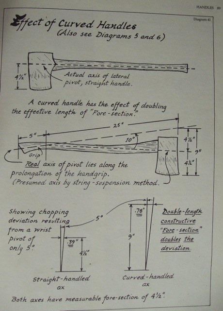

I think the term is 'axis of lateral rotation'. I found an image:
That drawing is very clear about what the term "axis of lateral pivot" refers to. However, I've only seen that term associated with Dudley Cook. It's not a term used in any discipline that I could find. I don't have access to the book that drawing came from so I don't know if he goes on to make a logical case of how/why it is significant. I'm a little skeptical, but my mind remains open. :)

It mostly has to do with assessing the overall hang and balance. If you were to be assessing, for instance, how the length of the bit affected ease of tracking then you'd need to measure the distance of the edge from the axis of rotational balance rather that from the eye.

I think most will tell you the axis of lateral pivot does matter, and that Cook is correct in regards to it. Where people disagree is in where he takes this discussion. If I remember correctly, his main argument surrounding the axis is for the shorter bit. Peaking at the book, this is due to 'wrist-pivot deflection error', which means that a longer bit results in greater cutting errors (less accuracy). But in another chapter he discusses the differences of curved and straight handles, and he is clearly opposed to curved handles as he says they effectively, at best, double the axis of lateral pivot. This would mean that accuracy would be twice as bad with a curved handle.
This is where people disagree. Some are quite opposed to this theory and say there is no difference. There was quite a long discussion on it, probably easy to find. In my thinking what he says is true, and this is proved in that for the same distance swing the curved-handled axe must be held at an angle which is equal to the fore-section. Or in other words, the curved-handled axe creates the same situation as increasing a straight-handled axe swing by the length of the fore-section. You can test this by comparing your wrist position on both handle-types, your wrist is always turned further back to the same degree as the curve in the handle, which effectively means that you can always get a longer swing for greater accuracy with a straight handle.
This may not seem like much, but in axework accuracy is king. One can quite easily begin doubling their time with missed swings. Of course, the advantage of the curved handle is that you can increase your power due to increased leverage. But if you do not pull the axe back further than you lose this whip advantage.
Note that my argument is one I developed on my own through the curved/straight discussion here on bladeforums. Cook's argument, or at least the one people take issue with, is that the curved handle effectively doubles the wrist-pivot deflection error. Their argument is that turning your wrist does not change the distance on a curved handle compared to a straight handle. But this argument misses the point, as Cook is not discussing intentional wrist deflection, but rather unintentional wrist deflection. And I feel that my discussion of wrist position at the starting point of equal distance swings is good proof of this: for an equal distance swing you are indeed moving your wrist the equivalent of a fore-section further.
Cook also discusses other shortcomings of curved handles, including the necessity of the wood finishing thicker and thereby losing some of the whip advantage of thin straight handles. This would mean that the whip generated from the extra lever in the design first has to make up for what is lost in the handle thickness. It gains only after it has lost in the first place.
Although I should state the other side in that a slight change of stance with the curved handle, made possible by end wrist position at the cutting line, allows for a safer foot position while generating more power (angled stance rather than perpendicular).
The spinning weight method works, but I find the comparison of two suspension points way easier than having to hang the axe up, spin it, and fiddle with a weight. Just pinch at a point, envision a line straight down from your fingers, and see where it's pointing relative to the axe. Then do another suspension point and see where that line points. Where the lines cross, that's your center of gravity, and any single suspension point will point towards (and naturally pivot around) the axis between the CoG and the grip point.
Cook's main mistakes are that his assertion regarding deviation of the bit is based on supination of the wrist rather than orienting the axe with a twist of the forearm, (which is what is more commonly and easily done due to the comparative weakness of the wrist in that situation) and the fact that he overlooks the ability for the axis of rotational balance to change if the handle isn't aligned in such a way as to have the full length overlaying a single axis (meaning that the single axis found through his method can't be applied to other grip positions along the handle on a "7"-balanced axe.) Now, a bit sitting further forward of the axis will also see a great deal more twisting if you strike a glancing blow from poor alignment with your stroke, and that can beat a fellow up pretty quickly.
