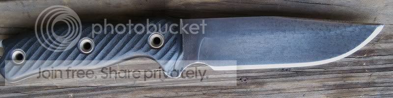

I have had good luck with Marine Tuf Cloth, but a patina is not the worst thing in the world. I have carbon steel knives from WWII that still cut fine. Here is my Ratmandu in 52100 steel with a patina.
