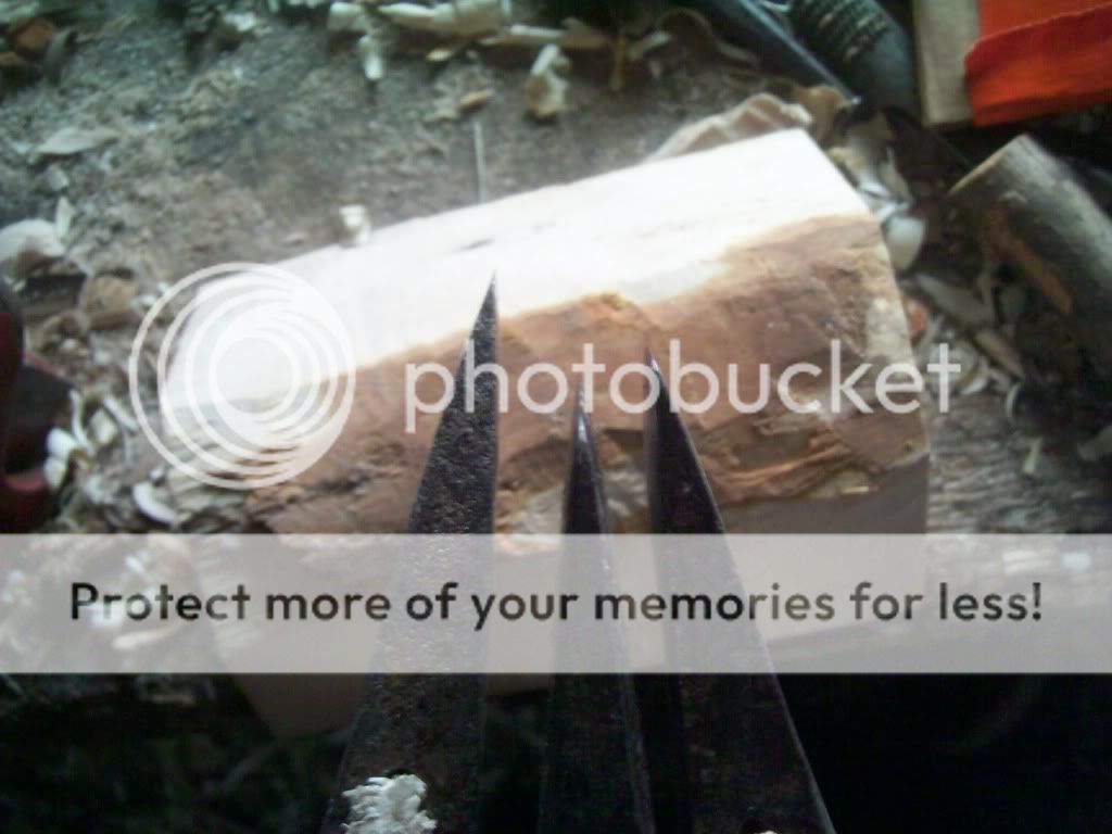

Do Maine patterns have flat cheeks, G-pig? The ones I've found on Google look almost like a perfect wedge. Similar to some of the Euro Felling/Forest Axes out there.

No. All of the Maine patterns, with the exception of a few later made Snow & Nealleys, all have a high centerline. However, it's not as defined as a typical north american pattern of axe, like an old michigan or something.
You can see there it is not as definite on any of those three. but if you check with the flat edge you will see a definite high centerline. The thickness and wedge shape, along with a generally narrower bit from top to bottom enables it to function well without a super prominent high centerline.

G-pig- thanks for the info, I see what you're talking about. It's an interesting pattern that I haven't seen around much.
