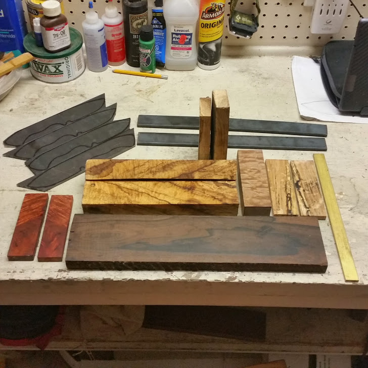

I have a birthday coming up and I am in need of a saw more suitable to cutting wood and other handle materials. I have recently gotten quite a bit of wood that I need to rip thinner and cut smaller.
All I have, at this point, is a table saw and a few hand saws. That has gotten me by but has led to some pretty frustrating situations when I want to cut exact angles- like on this piece:
If you look really close, the spacing of the materials on that knife are less than perfect.
Is it too much to ask for a saw that makes very thin cuts (yet is still powerful enough for very hard woods), makes perfectly straight cuts, and cuts at exact and consistent angles?
What do you guys use?

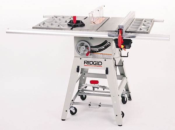

Ranger, I love the idea of adapting something I already have instead of getting something new! My table saw is the first real power tool I got and it's supposedly really nice. It's an old Rigid TS2424 I got for really cheap at an estate sale. It's a 10" blade and I feel like the cut is just way too thick when I want to cut thin pieces of precious wood. Here it is:
Do you have any tips or know of any tutorials on how to set this up for my uses? Can I get a smaller, thinner blade for this? I've found a few tutorials on making zero clearance inserts which I do really need. I would like to cut some really thin pieces of Purple Heart as liner material.
Table saw with a 10" or 12" blade....... and a Freud Diablo fine cut blade (60-80 teeth "Ultimate").
They do make a thin blade, its about 3/32, I have a carbide that cuts smooth, like bladesmith said 60-80 teeth, more the better. You will also need a jig to hold the wood and a zero clearance insert for the blade, its too difficult to push small wood between the fence and the blade.
I prefer a bandsaw with a fence and a 1/2" 3 TPI blade for stability to make book matched scales and rip blocks a little thinner. I then clean the both sides up with a 6 x 48" belt sander.
The Grizzly Bandsaws are a cut above HF in quality without getting into really expense pro grade stuff like Laguna bandsaws. a 14" will tackle more than most need for these two tasks and some crosscuts in knife making

Get good at using your table saw, and save the cash for a tool you need more. If you want "book matched scales" use a table saw blade that the width of the kerf matches the thickness of the tang.(.125" thick steel=.125" Kerf, ect.)
If you need to cut small thin pieces of wood you can always do the following:
1) square up the end of a scrap piece of 2x4 using the table saw.
2) glue the wood you are cutting to the 2x4 with 5min epoxy and a clamp.
3) cut the piece(s) you need using th 2x4 as a guide.
4) last cut is to part off the "good wood" from the 2x4.
With a little planning and practice you can cut almost any shape you need.

Red flag warning a using a table saw to rip small pieces! It's dangerous!
If you must, buy or build a jig to hold the workpiece and keep your fingers well away from the blade.
The table saw excels at making long, straight rip cuts, square & mite cross cuts, & some joinery cuts like tenons & dadoes. A Bandsaw can do most if that, especially if supplemented with a router table.
If I had to pick one, I'd keep the bandsaw (which I did.)
