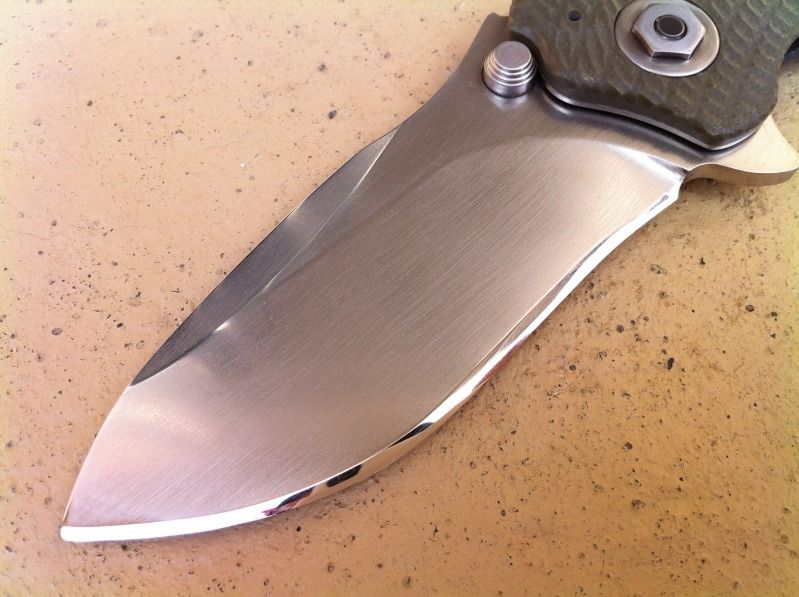

Dmt aligner gets my vote. You wouldn't think so but I get these types of results every single time, with any steel, whittles hair effortlessly, and even bevels on both sides

Impressive. I just ordered one today What is your final stone/grit to get such a polished edge?

I'd like to see a demonstration video... looks like a great alternative to an edgepro. I can't get anything like that on a sharpmaker.

That's a beaut!! Love how you brushed the blade and pivot bolt, looks like the liners too! How about a full pic of that beast it looks sweet, not to mention that awesome mirrored edge you attained...

+1. Sorry to bug you with this, I was actually going to PM you, but I'd love to see some more pics of this knife because I've actually been wanting to pick up a Blem ZT 0300 and do this to the blade and pivot and possibly do some other sorts of mods on it. Make it a project knife. This makes me want to do it even more :)
