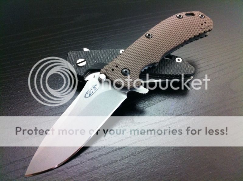

Thanks guys..extra fine, extra extra fine, then for final polish I also use their 1 micron diamond paste on a flat piece of balsa wood. It takes a lot of patience to get these types of results
Here's the full pic of the knife: I sold it here a couple months ago, then it was traded..not sure where it is now
Then here's my ZT 561..may put it up for sale soon as well:
..more recently I've done a para2 in m390, two umnums s30v and s35vn, and my xm18 in 20cv, with retarded sharp and perfect mirror edges
Dmt aligner gets my vote. You wouldn't think so but I get these types of results every single time, with any steel, whittles hair effortlessly, and even bevels on both sides
Nice edge! Are you using extra fine stones? Because I've never gotten an edge like that using my DMT aligner! Wish I could though!

I guess you can do that but it has to be the same thickness, otherwise the angle will be off and you're not gonna polish the bevel evenly. When you do it freehand, it's easy to tell if you're hitting the entire bevel because it feels glassy smooth
Not trying to be a smart ass but have you ever used that knife for anything else beside using it as a mirror?:confused:
Beautiful edge for sure, no lying there. I don't have the time it would take to obtain such an edge. No need to carve 1/4" circles in a piece of paper. Few passes on my Sharpmaker and it's back to work, cutting more crap. My knives are collectable, they are tools, and tools that get used. Doesn't mean I don't enjoy knife porn though, lol!!!!!
