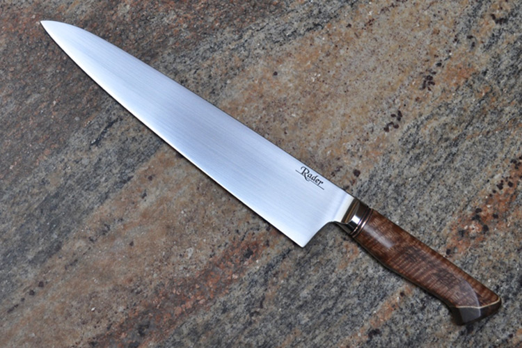

A Mastersmith has been forging a nitrogen stainless steel called Z-FiNit. Here are the results:
We will be releasing the Z-FiNit soon. Several knifemakers have been testing the steel. The test results are looking very good.

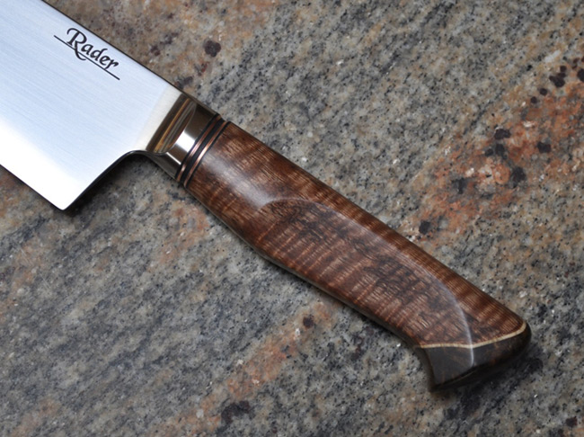

Only one person was crazy enough to forge it. I think the integral stainless bolsters look great.
