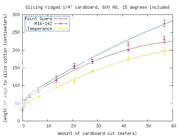

That is an excellent point and one of the problems I always had with people willing to write off steels like 440A, AUS-6A but hype Buck's 420HC readily. These are all in the same class, in fact the first two are superior from a hardness/wear resistance perspective. There is more to the knives than the steel, often the performance is more influenced by geometry and other factors of general construction. There are differences in the steels, but even in the extremes such as 420J2 the edge retention isn't as bad as often implied :
That is 420J2, AUS-4A and VG-10. Yes the Temperance has an advantage how much so depends on how you look at sharpness. But it isn't like you can not do significant work with the 420J2 blade. I also doubt that CRK&T has it at optimal performance either. To clearify this cardboard comparison doesn't cover all aspects of edge retention, it is a low angle check of slicing edge retention on abrasive media, there are other types of cutting and the relative performance will change. I am curious about wood cutting due to comments made by Landes about the drawback of large primary carbides in steels like 440C so the steels with a lower Cr/C ratio can do better, not worse. The main reason I have not done it is that it is annoying to measure push cutting sharpness in comparison to slicing aggression.

AUS-6A isn't a lesser quality steel than S30V any more so than S7 is a lesser quality steel than D2 (the same relationship exists for those pairs). As I noted in the above you can show that 440A is a more optimal steel than 440C for some knives, see the references I noted origionally. The same arguements hold for many of the steels called "low quality", see the references provided for details.
