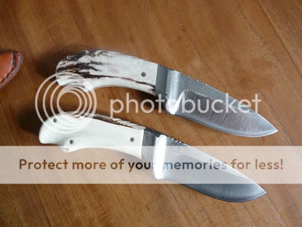

Hi all...
This one is a skinner, made by Pierre reverdy as pwet said. It is not forged but machine cutted. Hardness for K190PM is -if you use the heat treatment Boehler recommend for it- of 63,5- 64 HRC. Pierre Reverdy used another heating process, and the hardness is of 60 HRC.
A very nice knife, big cutting performances, easy to maintain. Only one thing is to notice: the patina wich is long to come is very hard to clean.
The first skinner of this model was made by pierre reverdy in 1993, almost 20 years ago, designed for hunters. He uses to produce 4 or 5 of these knives each year. 3 years on his waiting list :-).
Pics:
Pierre Reverdy , Fox-Trotte.
7,5 inches overall
A full tang, but a nice work to get it so thin at the end...
Mine, with a 1998 model:

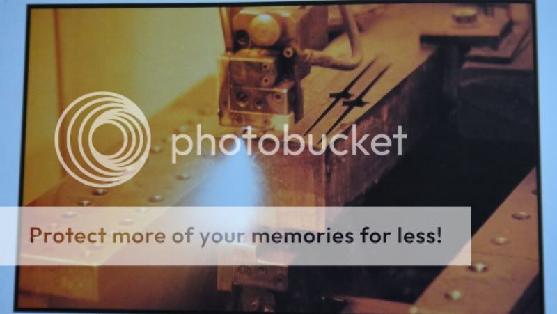

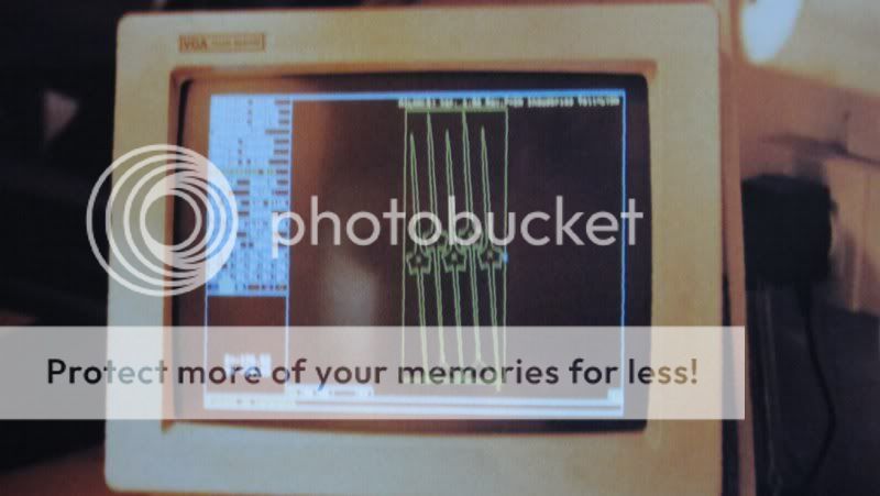

design and cutting process in 1994 :D
If he is only hardening to RC 60, why not use a far cheaper steel? :confused:
One of the points of using good steel is the ability to harden it properly.:p

reverdy choosed to modify The original heat treatment to lower The hardeness at RC 60. 64 is maybe much too high for a knife you will have to resharpen on the field. The interest to use this steel is not only to have a very hard blade but one of the most performant cutting steel. Precisely, I love the knife for it's cutting power, very impressive. Fir me it is more or less like a "super D2".
As a matter of fact, it is not cheap at all.
