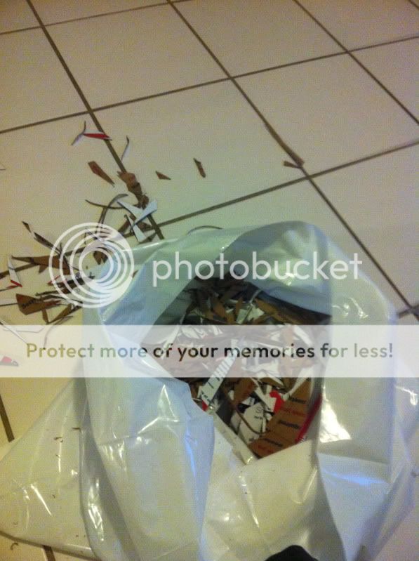

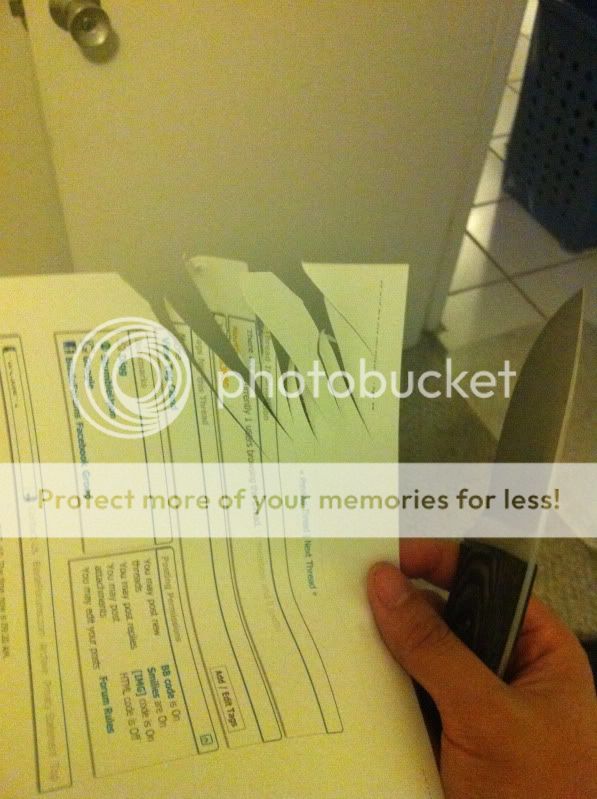

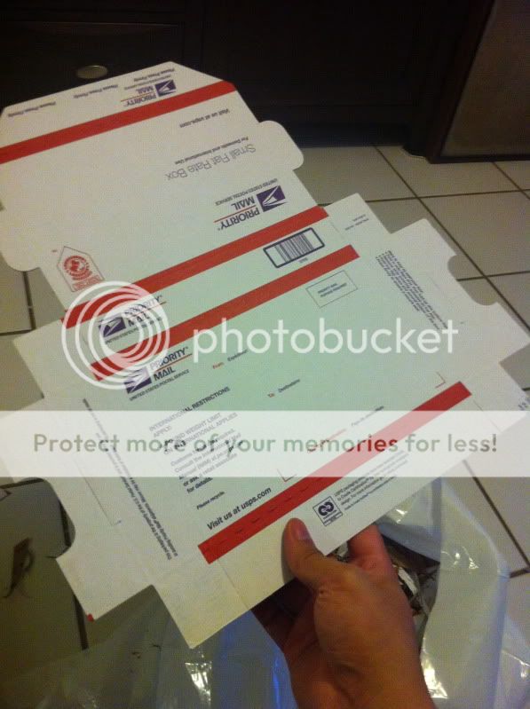

Reporting back on my light use results.
I cut up a couple of Small Flat Rate USPS Priority Mail boxes into little ribbons. Would've done more, but my arms got tired:D.
Edge was still paper slicing sharp afterwards, though it won't shave.
I noted some tiny glints along the edge, but most were gone with a quick run on my polishing belt, so I assume it was just rolled(weird?). Damage was less than expected, probably on par with ZDP-189. I don't think I'll have to baby the knife. Just so long as I beware of staples and bone.
