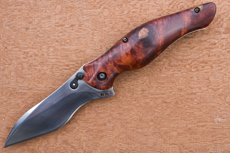

I sanded off the bead blast finish on my Speed Bump:

I stripped my Camillus Beckers with a belt sander and finished them up with some fine paper.
