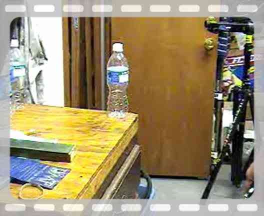

I was a little surprised to hear that some think cutting a water bottle or paper tube requires much technique or is dangerous :eek:. I really don't think this requires much technique beyond hitting the bottle with the edge without spazzing out. Certainly safer than chopping with an axe or big knife, or using a chainsaw, and requires less technique than hitting a golf ball poorly.
I finally had a little time (though I'm up too late) to take a video of some water bottle cutting, in hopes of showing that while you do have to hit the bottle with the blade (can be tough depending on blade length), it doesn't require much technique. I did "tip" the fourth one and only cut it partway through. While cutting a water bottle may in some ways require less sharpness than whittling a blonde child's hair, it still requires a high level of sharpness, and has some other differences, like the sharpness must be developed along the entire edge. One rough patch will send the bottle flying uncut. And it is funner and might even win you a few bucks sometimes if you have some cocky buddies you can talk into betting you. :D
Knife is an S30V Spydie Military.

The S90V version cuts five bottles! ;)

The demonstration involves cutting cleanly through the bottle. I thought that was pretty apparent in the video. So obviously those dull edges did not cut through the bottles cleanly - swinging your knife at the bottle, sending it flying through the air in one piece, and seeing you've cut a third of the way through a bottle, is not the same as zipping cleanly through them. So obviously to cleanly split the bottle requires a sharper edge then what you have shown in your post about how easy cutting a water bottle is (without actually cutting one in half) - and cutting a paper tube is harder.
