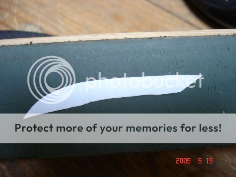

I don't have trouble sharpening knives. Just this one. I've spent the morning reprofiling it. The angels are correct. I've used the Sharpie. Under an 8x Loupe, the edge looks as good as my Manix edge. I don't seen any problems, just a very fine edge. In the skid test on thumbnail and plastic pen, the BG-42 grips like a champ.
I've stopped it 'til hell won't have it. When I put the paper that I've cut under magnification, it's easy to see that the S30V is cutting cleanly through the paper and the BG-42 is tearing its way through. I suppose, when it hits a tough spot in the paper it just rips.
I don't think it's my sharpening, although I'll acknowledge that's the safe bet. This steel will just not get that last bit of sharpness.
Here's a photo of the paper. It's not great, but hopfully you can see the difference. The S30V cut is the top edge and the BG-42 cut is the bottom edge.

From the cuts in the paper it looks like both knives have burr's.
