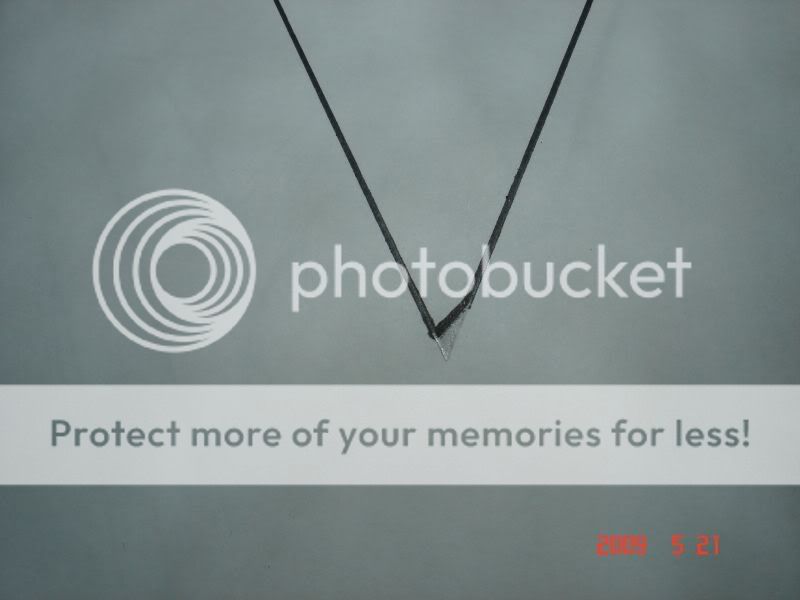

Just to close this out. I again painted the edge with a Sharpie and scraped it off with the Sharpmaker stones planted at 30 degrees. The stones scraped the edge clean, except when I looked very closely and could see a very thin line left on the tip edge on one side of the blade. So one side of the blade had a steeper angle at the very tip of the edge.
I reprofiled the edge to 30 degrees with a coarse diamond rod. It took quite a while. Finally, I got rid of the last of the Sharpie paint and went through medium, fine and extra fine stones.
The blade shaves and slices paper well.
Here's a drawing of what I think the blade edge looked like and the reason I couldn't slice paper very well. The black lines are the actual blade angles. The penciled in tip is where the blade should have been. This is exaggerated to illustrate the point.
Seems to happen a lot, especially if one freehands. I've learned that light pressure is best to get that deliciously sharp edge working.
The sharpie comes to the rescue to explain why you were getting a burr. Now you are all set for 15 per side edges, but your sharpening will go way faster if you thin the backbevel more and get where 15 degrees only puts a tiny microbevel on the edge (sharpening at 20 per side now would accomplish the same thing). On high wear resistance steels it is much easier to sharpen a tiny strip of steel than the full bevel, especially on a Sharpmaker where the rods can load quickly.
