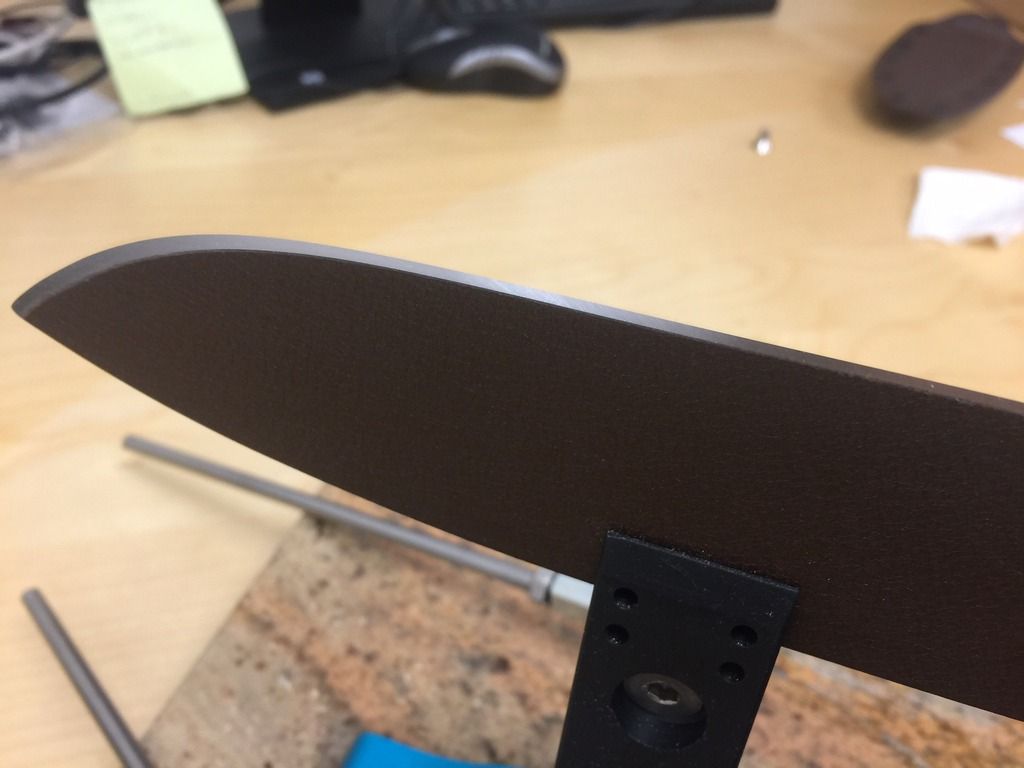

I picked up a Wicked Edge at Blade Show this year because I have quite a few Busse's and folders that I would like to be able to consistently sharpen well. I have sharpened a couple of small folders with the Wicked Edge, but not any fixed blades until this point. I know that there have been a few other Wicked Edge threads lately, but I thought that since it was my first time using the system to sharpen a Busse I would show my results.
It's definitely not as easy or quick as the Wicked Edge produced videos on YouTube make it look. That being said, it's not difficult either. I got a tip from someone that suggested that until comfortable with the system to use more of a up and down sanding motion instead of the full strokes like the videos show; I think that helped quite a bit initially. By far he most time consuming part is re-profiling the blade, which which I chose to do for the BG ASH-1. I had heard that the re-profiling is rough with the 100 grit diamond stones, so I ordered the extra course 50 and 80 grit stones. It took a long time as it is, I can't imagine how long it would take with the 100 grit stones, but I'm glad I didn't have to find out!
I think I really like the system overall. It does take time, but it is easy to precisely control the sharpening angle, which is the most important thing to me. My results are not professional by any means, but I'm pretty happy with how it turned out. I my grit progression went from diamond stones at 50, 80, 100, 200, 400, 600, 800, 1000, to ceramic stones at 1.4 micron, 0.6 micron, and then finally strops at 1 micron and 0.5 micron. When I received the BG ASH-1 it was fairly dull, and would not cut computer paper. The pics below aren't great, but they are the best I could do with my phone.
Edge after 80 grit:

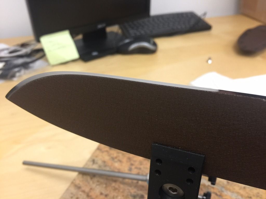

Edge after 1000 grit:

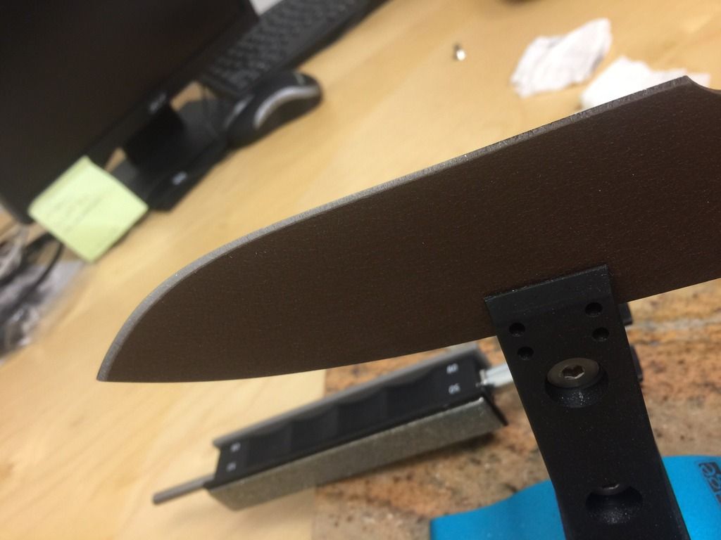

Edge after 1.4 micron strop:
Edge after 0.6 micron strop:

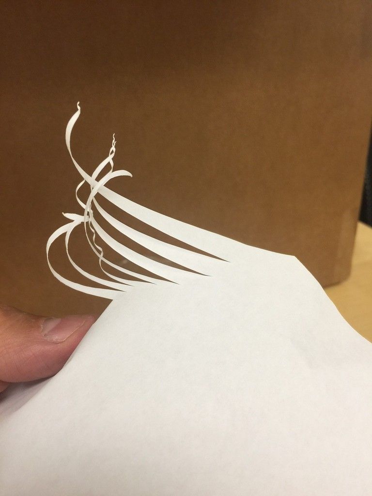

Now it will cut paper, and is shaving sharp:

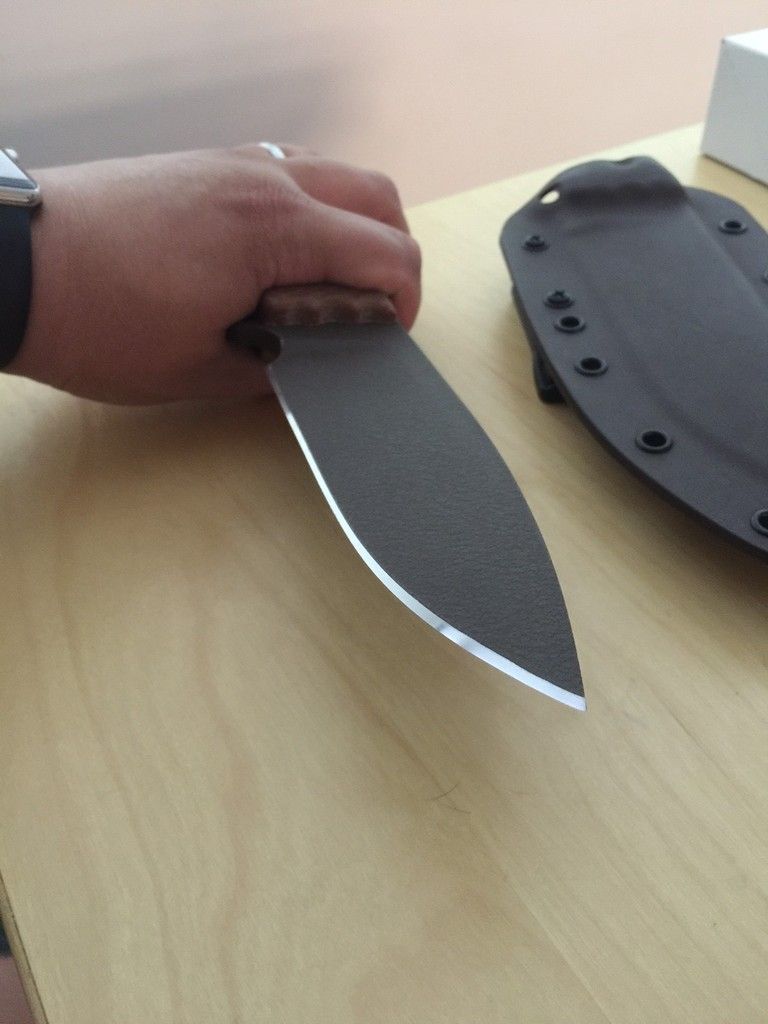

About 20 degrees?
Yeah, about 19.8 degrees actually (I just didn't feel like adjusting the fine adjustments on the WE to get it any closer). That brings up a good point though, the digital angle gauges are really helpful. Depending on the blade height and the exact mounting location in the WE, the edge angle can change quite a bit. To get the 19.8 degree angle I used the 22 degree setting on the WE. The angle can of course be calculated with good ol' fashioned math, but the digital angle gauge makes it much quicker and more precise.
