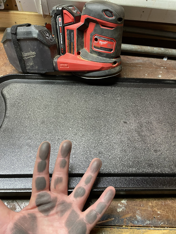

First off, if you’re dealing with an old pan that has a smooth interior finish, you might not need to sand at all.
The above pan had a tiny bit of rust and some bumpy areas of seasoning when I bought it, but I was able to get it very smooth again just by scrubbing with Dawn dish soap, hot water, and 0000 steel wool.
On a newer Lodge or similar pan with a bumpy interior finish, I’d say sand away until that sucker is smooth.

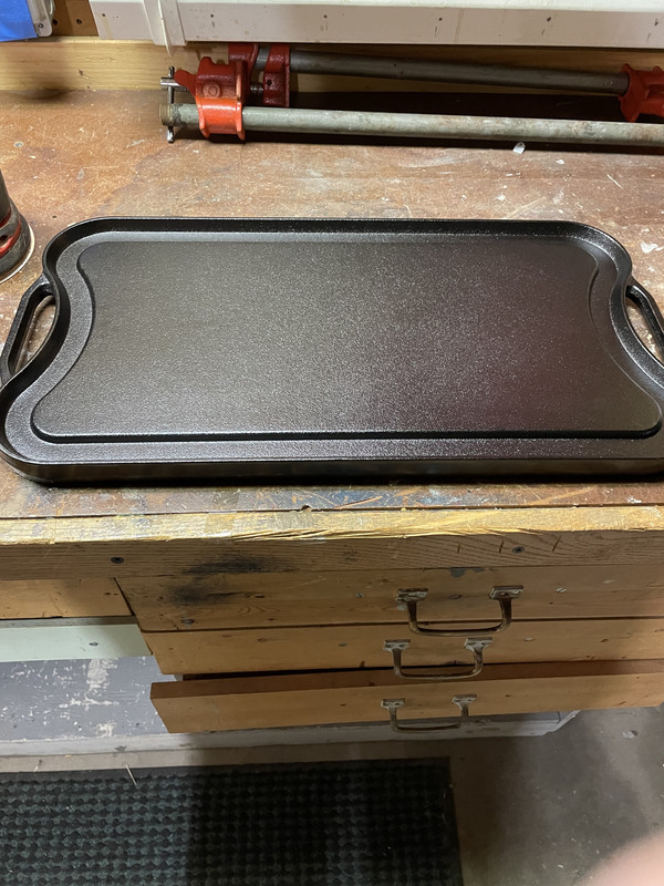

Yes, the Lodge stuff is straight sand cast and never milled in the interior like the classic cast iron pans. It’s a cheaper finish and inferior.
I tried grape seed oil and found it not durable. I’m using avocado oil now.

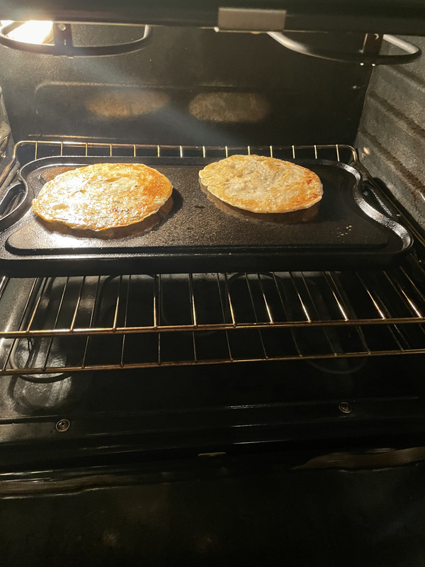

I season a freshly sanded pan with 4 very thin coats baked on in a hot oven - at least the smoking point of the oil. I touch up with a single coat a few times per year. I have a ton of cast iron. Pictures later.
Yes I was going to buy a $98 lodge dual grille after PBS "American Test Kitchen" recommend it then I saw it. I bought the amazon and spent time sanding it and putting coatings on it.
