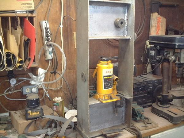

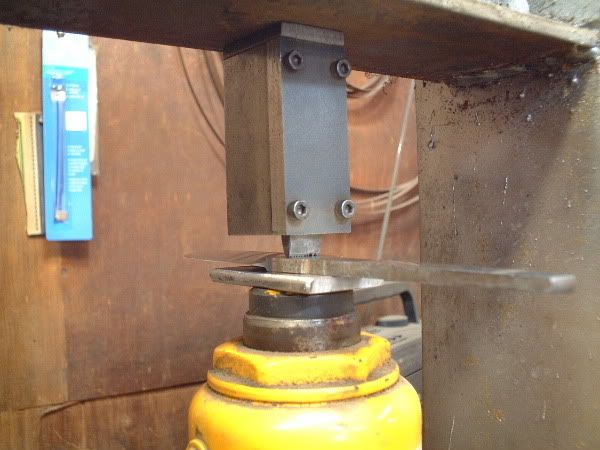

I dont know about hot stamping but you'll never get an nice even stamp with a hammer. I'll go take a pic of my press in a few minutes and post it here. Since I built it I get nice even impressions. I find I also have much more control over where the stamp goes also.
Thanks Darrin. I got the stamp from Buckeye, you mentioned them and they did a great job on the stamp, thanks! I bet I need a jig. I can't even write well, lol.

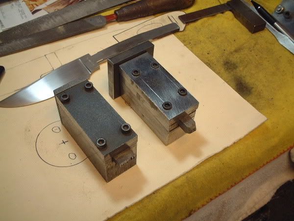

I threw together some tooling to help that may work for you.
I milled out a couple slots in a block of steel to hold the stamps and press them in:
I will try that if it comes down to it. Thanks for the great photos! I have never tapped anything so I was hoping to hold off on building a fixture but I will do whatever it takes to get this right.
