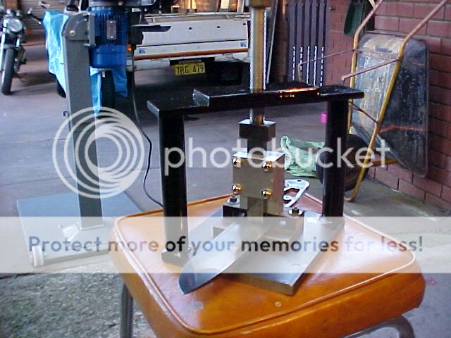

Got to say I'm glad I went with the personalizer etching machine. Doesn't mater if the steel is hard or soft, and can get it as deep as a stamp. If I was going to stamp I'd probably go the rout of a press and jig holder, no way I could stamp it perfect with a hammer on the anvil all the time.
I made the stamp holder but the blade still jumped around when hit with the hammer so I made another gadget, works well now.Put the knife under the stamp and tighten the big bolt then give the big bolt a good whack or two .
