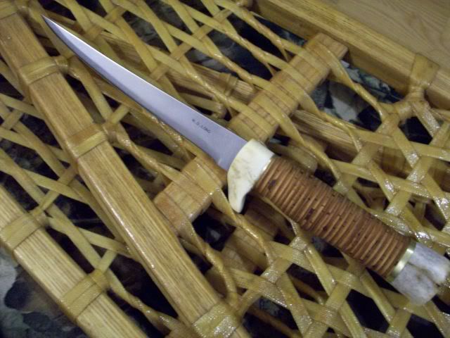

This is the time of year we hunt Grouse while we walk the woods on snowshoes. Nothing gets the heart up to speed like having a bird explode out of the snow at your feet.
My scandinavian heritage has to come out from time to time and a birch bark and rein-deer knife seemed in order. A bark handled knife has the qualities of warmth and good grip no matter what the conditions. It is a pleasure to hold.

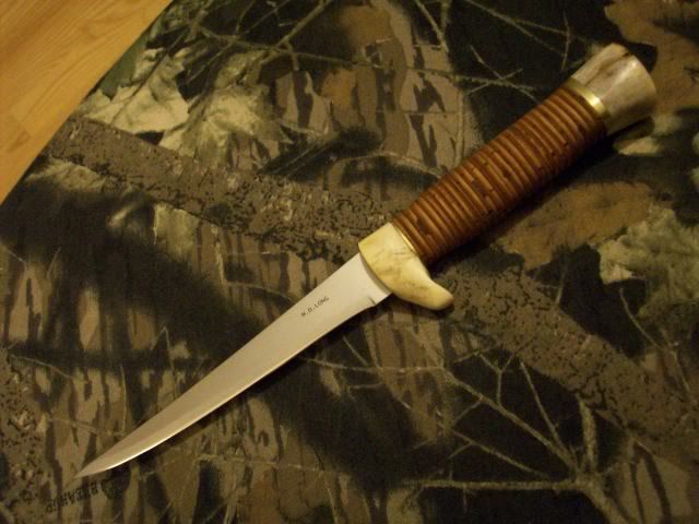

The blade is scandi ground ATS-34 with H.T. by Paul Bos to Rc60-61. It is 1/16" thick and bead blasted. Guard to tip is 5 1/2", cutting edge is 5 1/4" and the OAL is 10 3/8".
Guard and pomel are rein-deer antler, handle is birch bark and spacers are brass.

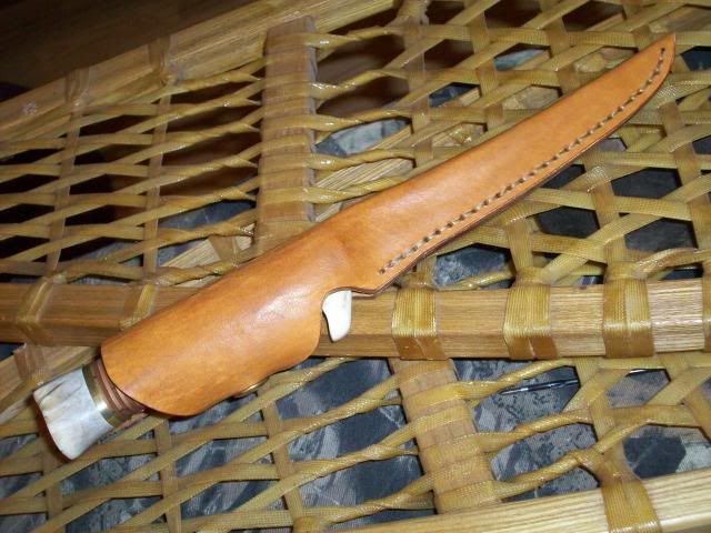

Sheath is vegi tanned and made by me.

I've never seen a birch bark handle on a knife. Is it stabilized or does it not need to be? Is the bark just on the outer part or is it the entire handle, minus the pummel and guard?
What price are you asking?

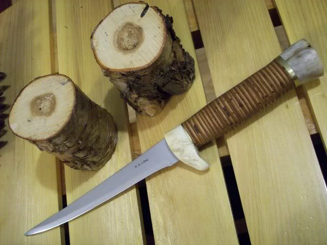

Sorry Woodgood, check out the edited post. Birch bark is a traditional material used in Scandinavia. It needs no stablizer just 50/50 turpentine and boiled linseed oil rubbed on it from time to time. The handle is made of disks of bark epoxyed together and put on the stick tang. It takes time to build a knife this way but the results I think are worth it. Thanks for looking.
Mike, is that a Scandi grind that goes all the way to the edge (zero grind), or is there a small secondary edge bevel ?
roland(happy owner of 1 M.D. Long knife)
Birch bark makes a great knife handle. It is warm in the hand, gives a good grip and will never rot (notice sometime when you are in the Great North Woods that the wood of a windfall birch rots away but the bark is there forever.
Great looking knife Mike.
Hey Roland, the edge goes zero. There may be some secondary edge created when I hand honed the blade but very small. It is very scary sharp and suitable for work in field or stream. Thanks for the interest.

Thanks for the good words Jack, The rein-deer antler is the most dense I'v worked with. The guard came from high on the tine and is just as hard and dense as the crown (the rosenkrans, the part closest to the skull).
