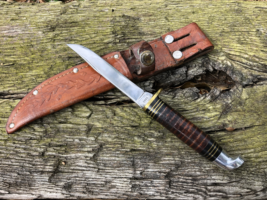

Friend gave me this 1950's KA-BAR small BSA sheath knife. Not really a B&T, blade too wide I think, but short enough to get the job done. Blade has lost about 20% of its steel based on pristine pictures I can find of this model knife on-line. OH
