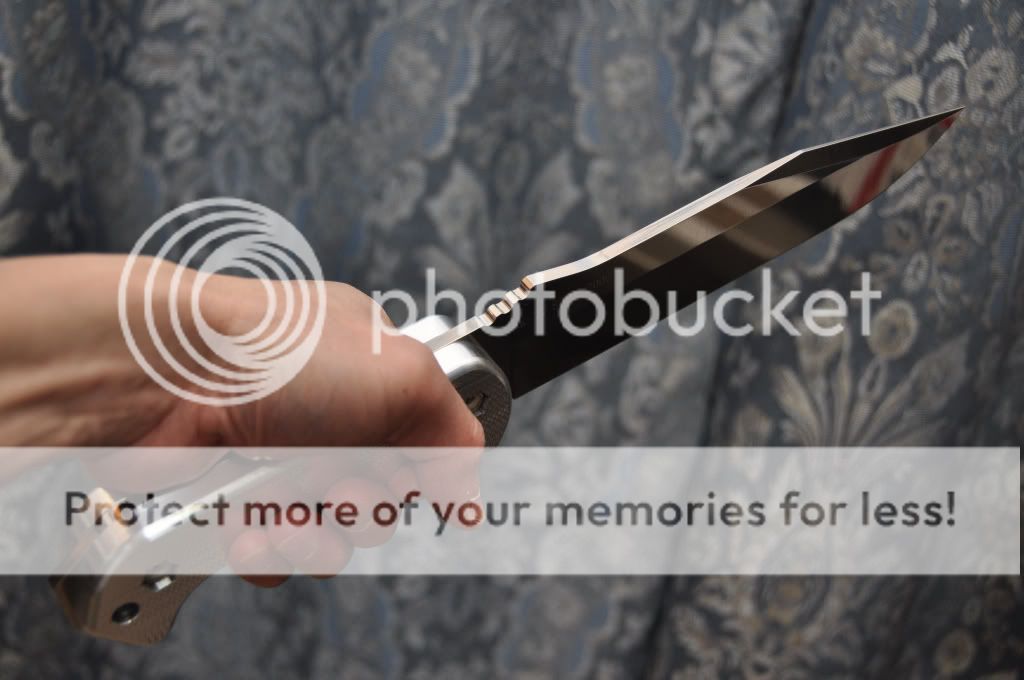

Finally I have a free machine to make the change...:yawn:

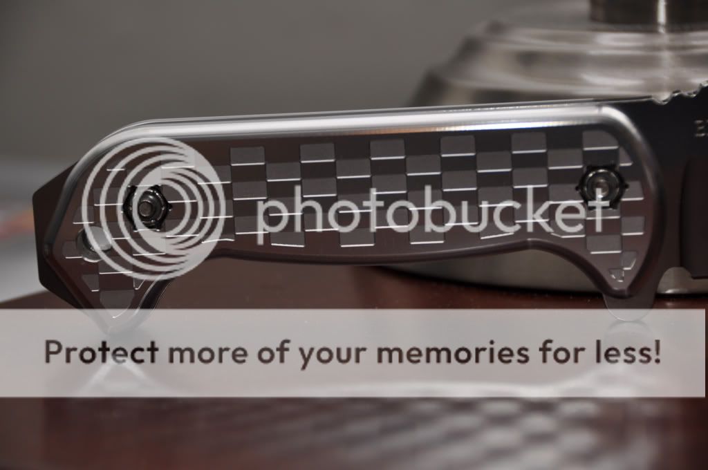

New pattern Texture
The knife...

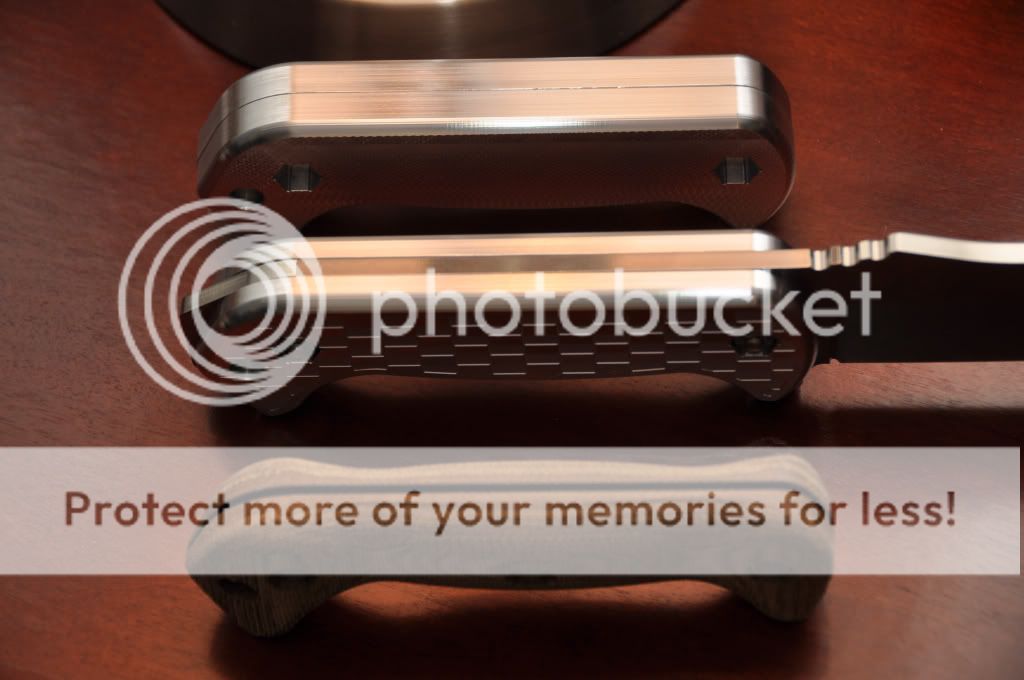

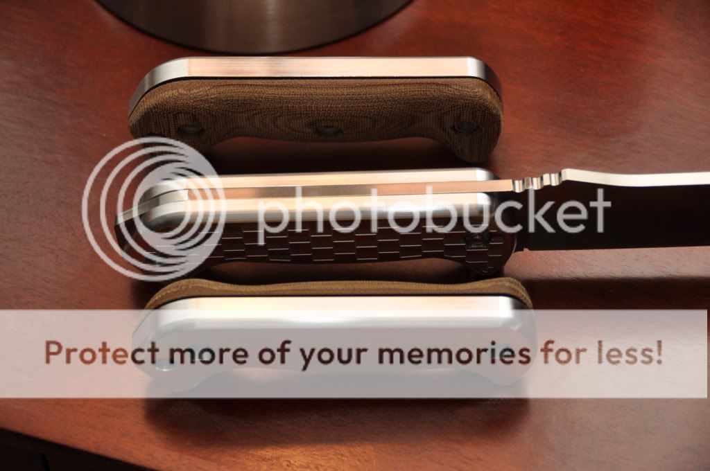

Scales comparison:
Milled down 1/8" each side.

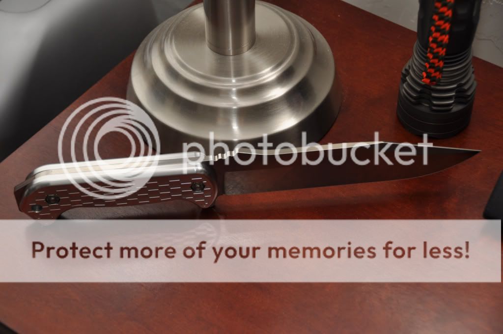

In hand :
before
After
Got a new friend...
OK, this time I like how the scales fit, and the thickness is right on after I milled them down 1/4" total. The back of the scales have not milled out yet and I don't think it necessary anymore. The weight is a little bit heavy compare with the Micarta scales but feel solid in hand and I like it that way. The new pattern on the scales gives it a "classy" look. Now I would love to hear from you all, inputs are always welcome. Cheers!!!
Hey Sh@rp, Love the brick-type pattern. It'll be a long time before I can afford anything after this week (Live in Alabama - House is fine, but no power, lost all our perishable food, had to go buy a generator - blah blah blah - waa waa waa) but I thought I'd give you my input anyway. Lookin' cool as heck right now Bro!
Blues
I like it - cool surface pattern and thickness looks much more comfortable!

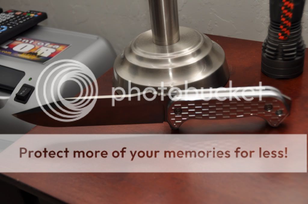

Today I ran the last modification for the scales, added some graphics to them. The dimensions were perfect so did the fits. I'm very very happy how this turned out. Thank you all for your inputs, I really appreciated it :):):). I made two sets today. After this post, one set will go to BluesStringer and the other will go to 1066vik. Enough talk. The pics...
