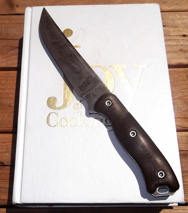

nice job on that patina. kind of a "false san mai" look
scales look grippy too
Thanks. I went for a faux hamon aged tanto look. It came out okay. I recently replaced the grips with the factory micarta...we'll see which I like better with time. This knife is my edc fixed blade...I keep it molle'd to my 5.11 Moab 6 bag. Nobody bats an eye, I suspect because the color of the sheath and scales match the bag.

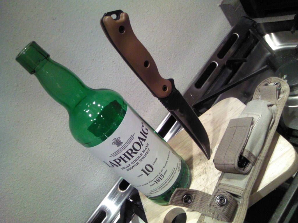

I couldn't leave the brown scales brown. I wanted something a little different so I took 'em to work and put a matte blue finish on them.
Toxic green, Hi-vis orange and yellow have been done and I thought white pearl might be a bit too "Texas BBQ knife":D.
The blue makes it look a bit less menacing or tactical and a little more visible.

What did you use for the coating, is it slick when wet, can it be media blasted prior to adhesion or any media included prior to baking/painting to add texture? Crushed and lightly rounded walnut shells would add some nice texture if small enough.
Thanks Bill.
I used automotive refinish paint. Standox if you're familiar with the brand. I have the Mystic and the other Chromaflair (chameleon) colors here but didn't want to go too flashy.
I just finished it about two hours ago so I haven't used it yet. Cleaned with a soap containing an abrasive designed to clean and scuff plastic bumper covers. Gray scotch pad, cleaned with solvent then waterborne wax/grease remover. Applied an adhesion promoter, then a 2K urethane sealer. Solvent basecoat applied then finished with a 2K matte clear. The same clear coat used on the flat black hoods of the new Dodge Challenger Hellcat :p.
I did the same with my BK7 years ago but added a texture additive to the top coat. We no longer carry the texture additive so I had to skip it this time.
