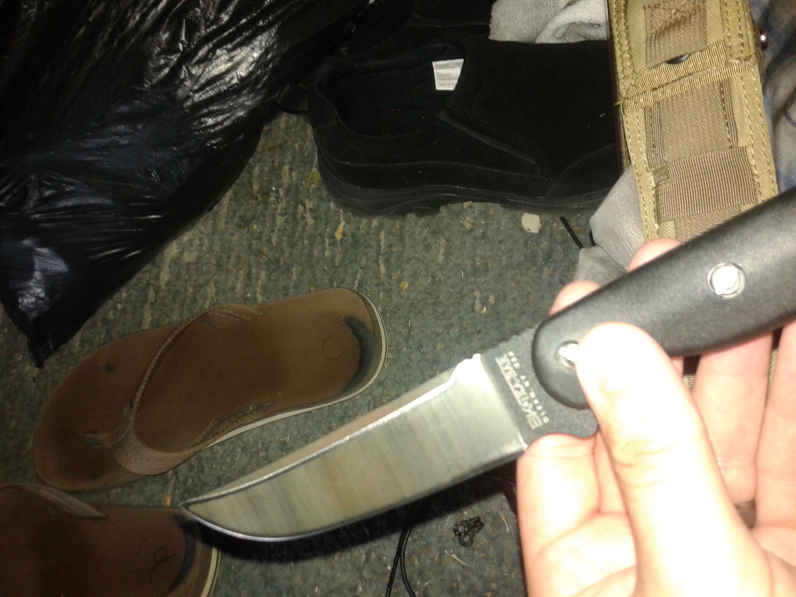

It has a slightly hollow grind, As can be clearly seen in the photo below by the outline from the very edge to the top of the grind where the trailing point begins. I discovered this when placing the blade flat and attempting to grind out the very deep tooling marks that I blame for the severe rust problem on this particular BK15.
Also, observation #2, I have a rust problem that's never been an issue with any other kabar, it rust nearly as fast as my Esee izula which is not 1095 Cro-Van

This thread is mostly about the hollow grind I was unaware on the 15 and didn't know if the other Beckerheads where wise to it as well.

For what its worth, often "flat" grinds are ground on a very large diameter wheel, which makes them slightly hollow. I'd say thats what you're seeing here. I noticed this same effect on my ZK War sword, and asked Toooj about it in the "ask toooj" thread, and thats what he responded with. So its possible/likely that many other flat grinds on kabar/beckers are similar.
And I'd guess that the variations in rust resistance are likely a compounded effect of the differences between grit/polish level, location (humidity/salt content), personal body chemistry differences, and variations within the specs of 1095cv.

Glad this thread has gotten so Much input, I technically was using a slack belt as I went into grinding position with the 120 grit belt on my ken onion work sharp, it didn't work for me because of the hollowness of the grind.

In related news, if you ground it on a slack belt, wouldn't that mean it could have been slightly convex (the belt itself that is)? That would exacerbate the slight hollow grind, if the belt was slightly convex.
