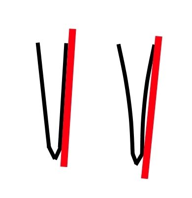

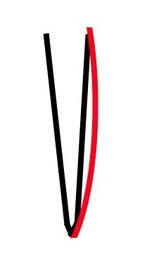

You'll only end up with a full high convex if you'd grind long enough to take out the flat. The blade really isn't hollow, see for yourself and put it on a flat surface. With a worksharp, you will end up convexing the EDGE, just not the entire blade (well, you will if you do it long enough, resulting in quite a lot of loss of material).
Or try picturing this: draw a cirkel and connect one inner end of the cirkel with another with a straight line. Even though the line is flat /straight, you'll only have two connections points because of the bending nature of the cirkel.
EDIT: I just went ahead and made a paint impression of what I mean. The red band is the flexing material. If the blade is flat or hollow, that doesn't really mind. A surface that gives will always flex around the extremes, in this case: the edge on the one hand, and the highest part of the grind before the swedge starts.
This is what either a flat or hollow ground knife would look like on a FLAT surface, like a stone:
I don't think a flexing abrasive like a belt would let you tell the difference between a flat or hollow ground knife. A flat abrasive can.
And Galeocerdoshark, that's exactly what I thought I was trying to explain, so thanks for doing it better than I did :). Grinding on a slack belt will make it pull away and grind more on the spine/shoulders and the edge, if anything, which could make the grind look "more" hollow than if the grinding was done on a stone.
