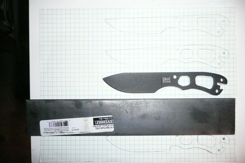

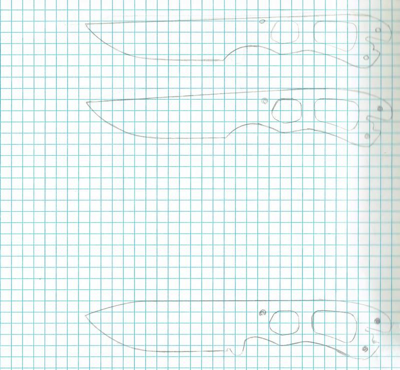

I don't even have the 15 yet, but couldn't help noodling and doodling on the 11.
The big space in there is for the 15 - and hopefully a final draft on the TP 11.
The upper one was to get the spine as horizontal as I dare.
The lower one is to preserves as much of the handle as possible.
Both have the guard knocked off and a choil ala my trusty ergonomic PM2 to give me a tru 3-finger grip.
Obviously the bottom one is bone-stock.
Questions? Concerns? Comments? Let 'er rip!
If Warrior or someone wanted to mock one of these up and put it next to a 15, I would not be averse...

Thanks a lot, TJ.....I unwrapped my custom paracord on my 11 because of this thread. Your drawings look pretty good, I like the third one down...
I've also been playing around with taking out some of the "drop" in the rear of the handle.
Mike - So sorry??? :)
The third down is what I'm calling my "final draft concept" - unless someone points out a valid reason why I shouldn't, that's the one I'm going to try to create.
I can understand wanting to smooth out the handle a bit - but my hands are big and leery of removing any metal I can hold on to.
Of course, if you model it up and I like it, I may pilfer your idea...

I did a little drawing the other night, finally got around to scanning it...of course, my hands are not so big so I was looking to "daizee-fy" the tang a bit:
Of course, it'll need scales after the excess metal is ground away. I might even grow some hair on my chest and give this a try.
#5 down there looks like a whole new knife. Very nice, Mike.

I'm just going to use the bar stock as a guide for cutting/grinding the spine of the "151". I figure I can shape it first, and if I mess up, I can try again on the other side - instead of buying another 11.
It's just cheapie hardware store mild steel so it isn't worth cutting to a useful shape and finding someone to HT. But it's worlds easier to work than hardened 1095!

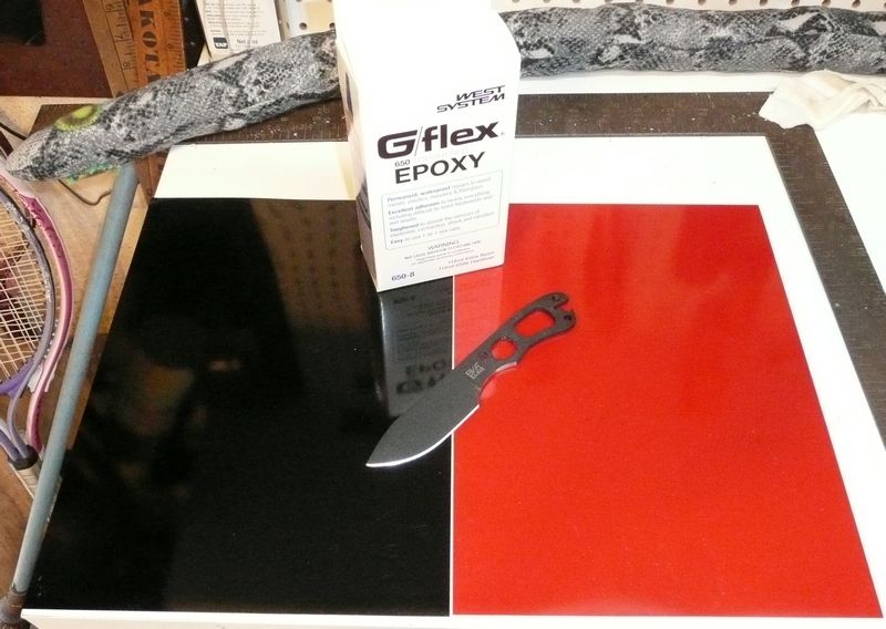

No new work done yet, but the steel "template" is getting cleaned up.
And the G10 liners came in:
