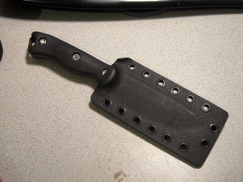

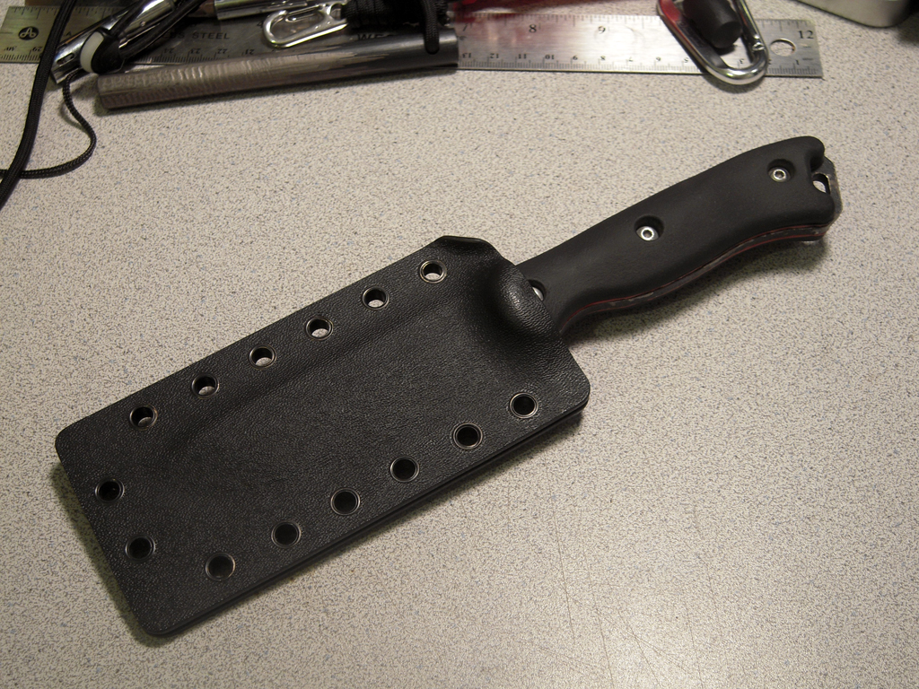

I am stull figuring out what I want my BK-16 setup to be. I spend a fair amount of time in water-especially when I am flyfishing, and I cant decide if I want to strip the epoxy finish or not on my 16, as I like the protection of the finish to help prevent rust). Here is my blade along with a sheath I got from a place called "apocalypse gear". I am really pleased with it and it came with a detachable tek-lok , a firesteel and sleeve, and a small maxpedition pouch that attaches using Velcro straps. Here is the "naked" sheath w blade.

Nice sheath Derek! I'm going to have to try that out!
I am terrible at making those drainage holes... Looks like a far superior design. I think it may even be TOO advanced for our civilization...:D
Thanks Matthew, I am very pleased with how it turned out. I think it is hands down the best looking sheath I have made yet.
Nice job !!! :thumbup:
Is that a 1/2" x 5" fire steel ???
Yes sir, it sure is.
That's a really great set-up. Nice kydex ideas and work.
Thanks for making me feel inadequate.....again.
Aw, thanks. I do what I can. ;)
To everyone else, thanks for all the kind words. I'm hoping Pointy will get his pics up here and maybe show off his sheath too.

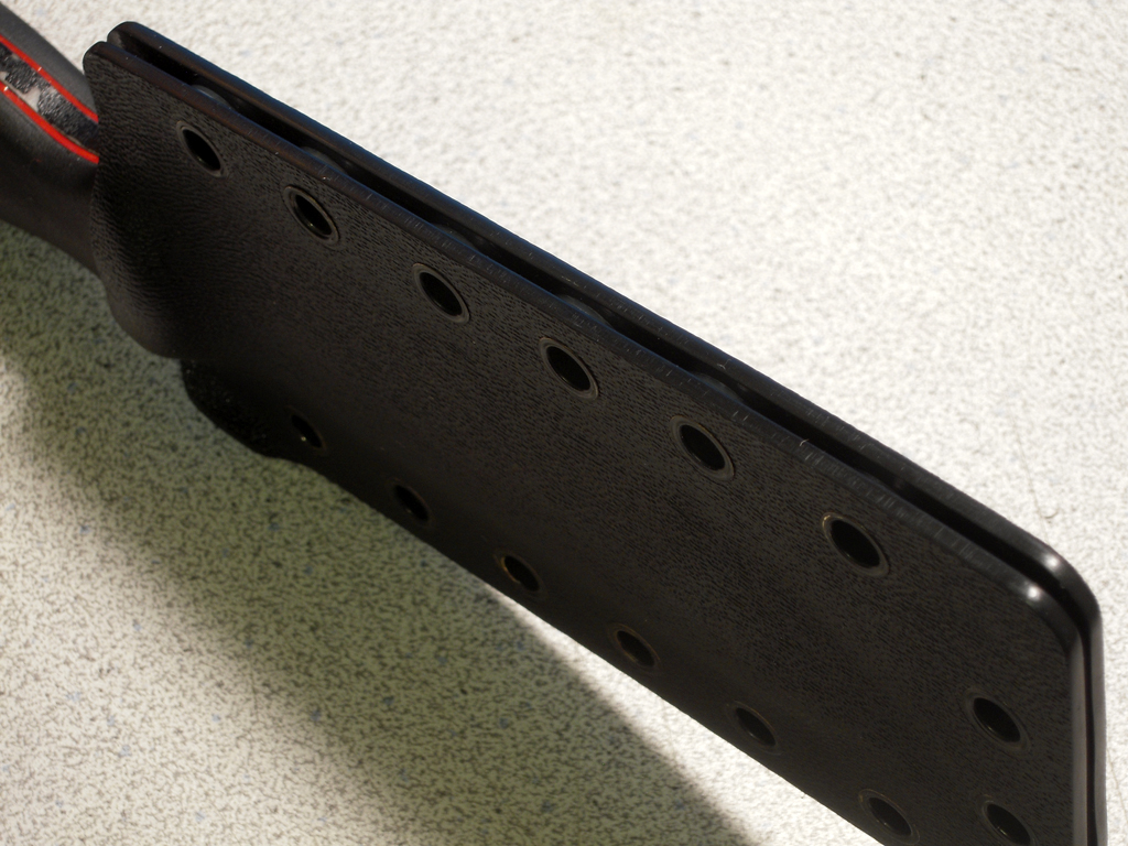

good stuff, derek! i assume the kydex is 0.080" so you used eyelets for 0.090" or even longer than that?
No sir, those are the ones for the .090", and that is .090" kydex, but my arbor press and some gumption compressed them down enough to work. Whereas usually they stick out a little afterwards these are completely flat and ever so slightly embedded into the kydex.

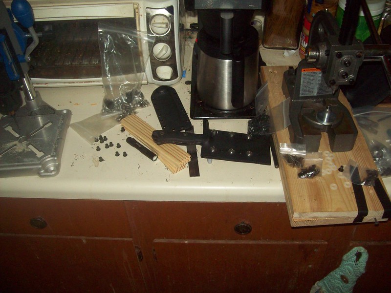

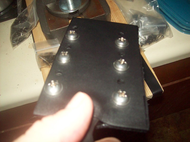

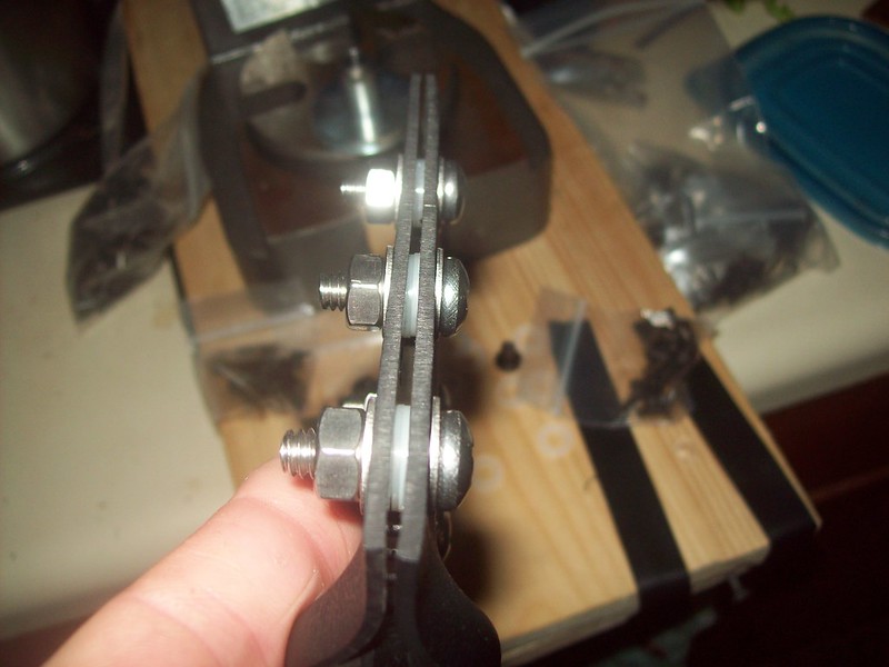

Sloppy workspace pics, and I'm not averse to baking the kydex in the toaster :D

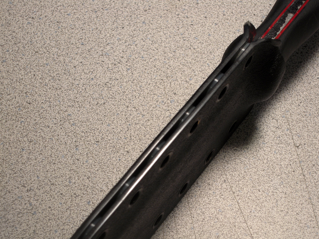

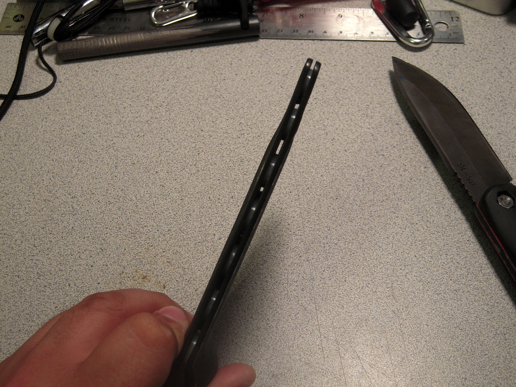

A pre-grinder retention test.
same test, good look at what I've termed the "air-welt"

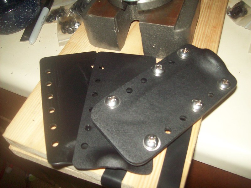

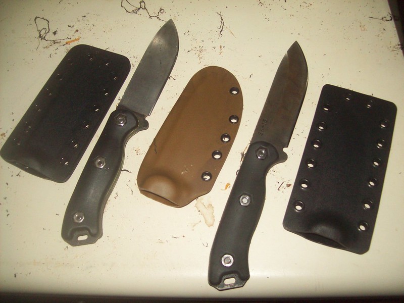

Post grind mockup before the eyelets, the one on top fits FFG, the bottom one (2 pieces here) fits sabre.
Here they are, just needing finish sanding and thumb flares, along with a quickie coyote brown Taco we made.

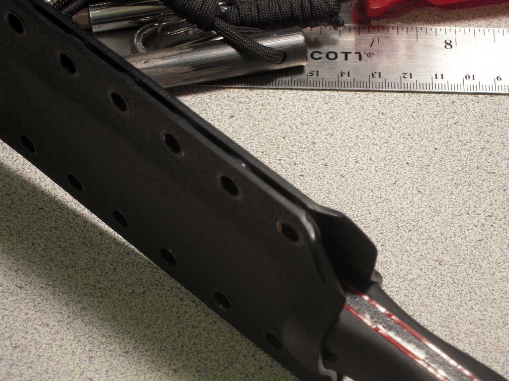

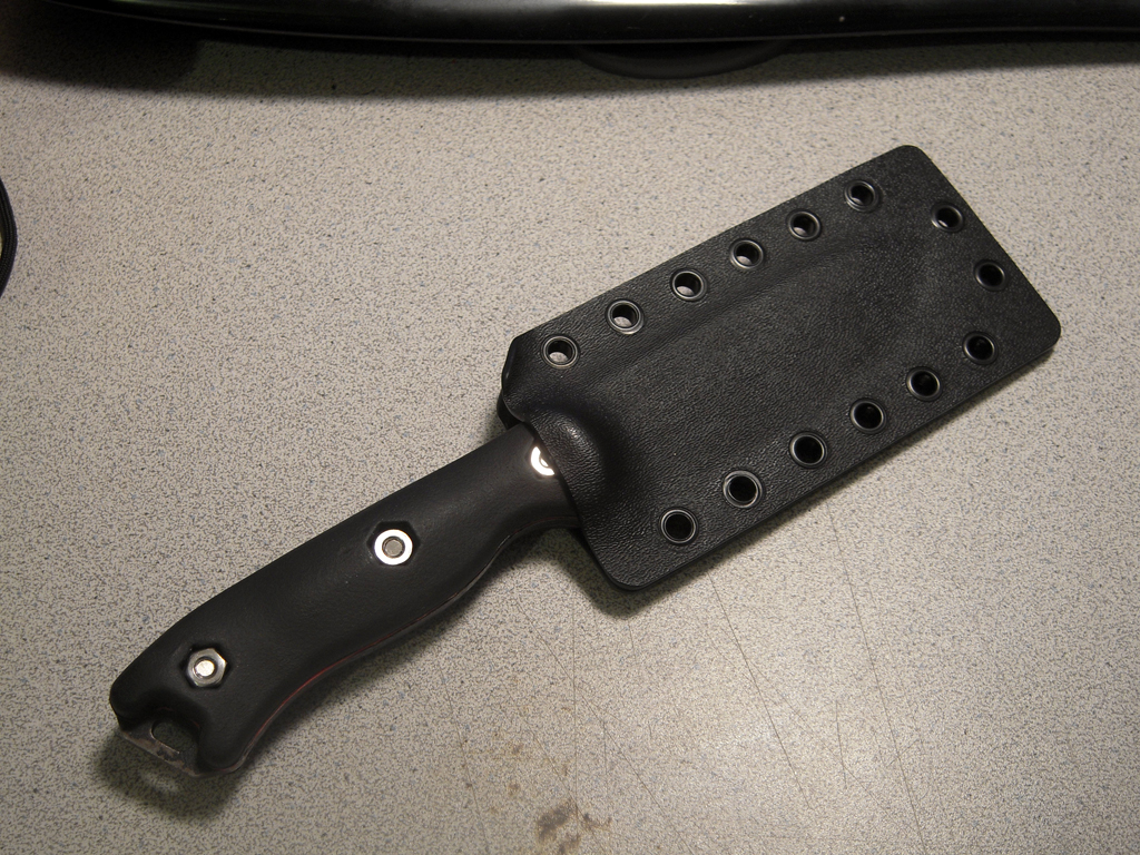

Had all the goodies off the sheath today to mess around with another project and figured I would toss up a few more pics of the sheath without all that stuff on it.
