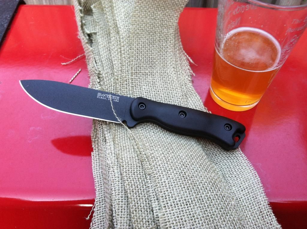

hey all.
i don't post that often, but i just received a new BK16. i decided i wanted to put some burlap "mycarta" on it for a handle.
i like taking pics as i go. so, i figured i would share.
Before...
It is very important to start with a clean workspace...

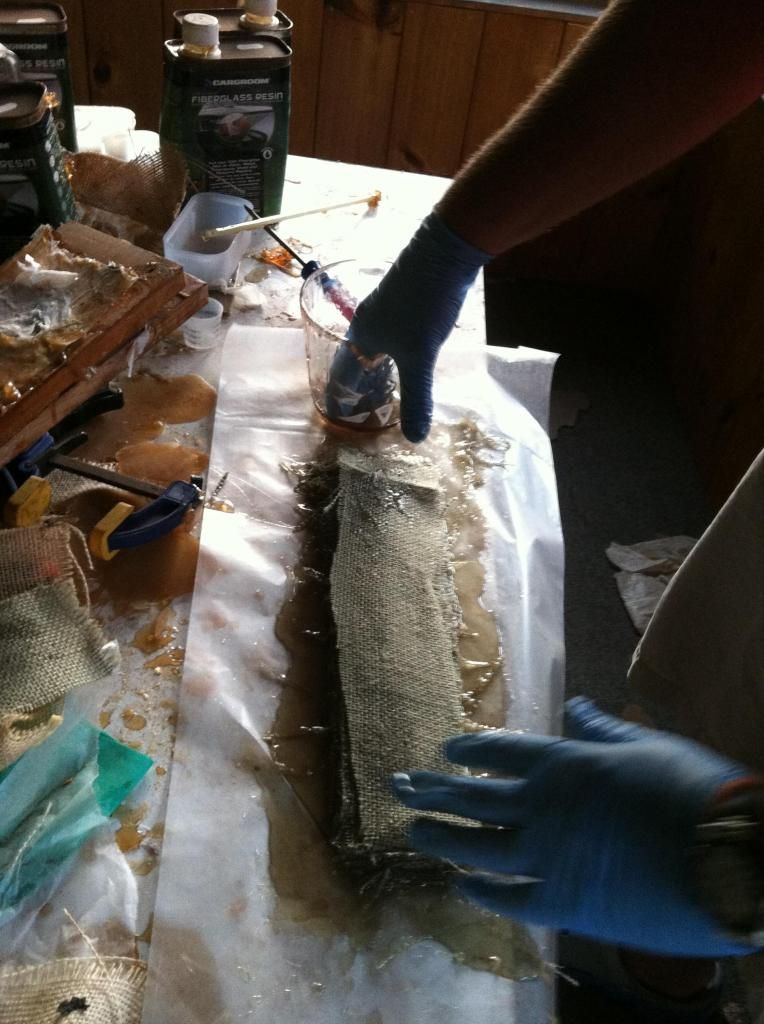

I cut up strips of burlap (see pic above) and just use fiberglass resin from a local hardware store...

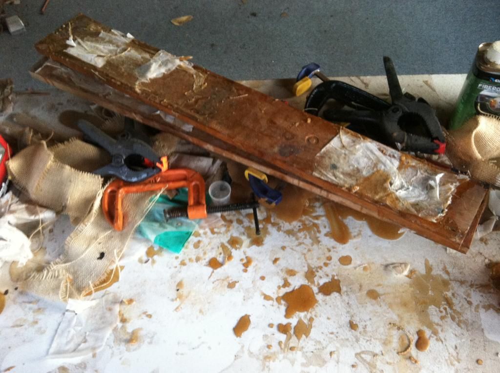

and we wait...
More to come....
I cant wait to see how burlap micarta turns out. When i used the bondo brand fiberglass resin and old kahki pants it turned a nice dark greenish color. Only problem is it absorbs water. Perhaps i didnt use enough resin. I want to use burlap next so keep us posted
yeah. i've found with heavy canvas fabric, you really need to make sure that you use plenty of resin (and hardener). burlap is good because it is quite easy to saturate the fabric with the resin.

Did my own burlap mycarta a while back. It certainly soaks up the resin. First one I used the Bondo stuff - very yellow-colored. Next 2 I used Tap Plastics layup resin. Much nicer than bondo (and usefully longer set time), but still a bit amber. I didn't worry about it much with my natural and brown burlap.
Currently for bonding liners in I'm using west systems. It's great in small quantities but, for me, it's too thick to wet out a set of scales. Resin is clear but hardener is deep amber. Dries a little yellow. But holds very, very well.
The fiberglass guys swear by u s composites. They have several options. If I had it to do again, I'd give them a try.

thanks for all the info. i use the G/Flex for gluing up liners/scales to the knife. but, it's too expensive to use for making slabs (for me). I'll have to look into the US Composites. thanks.
