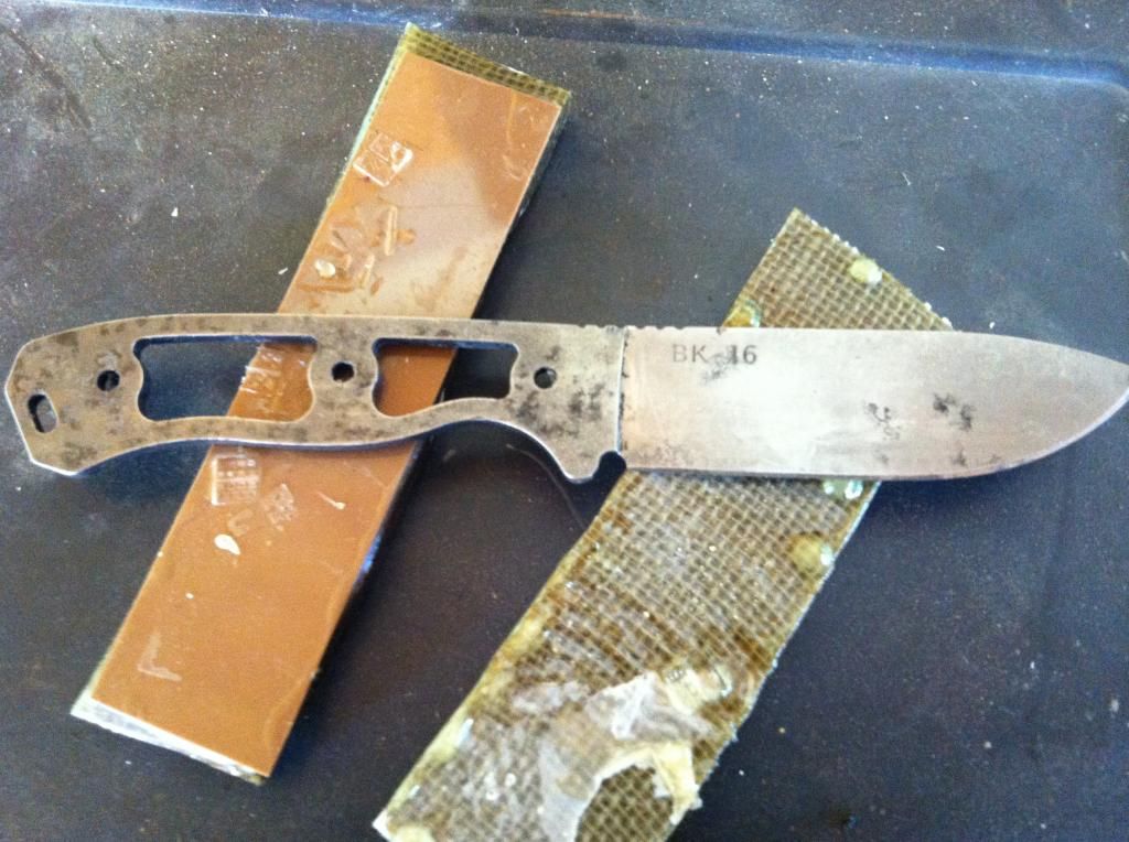

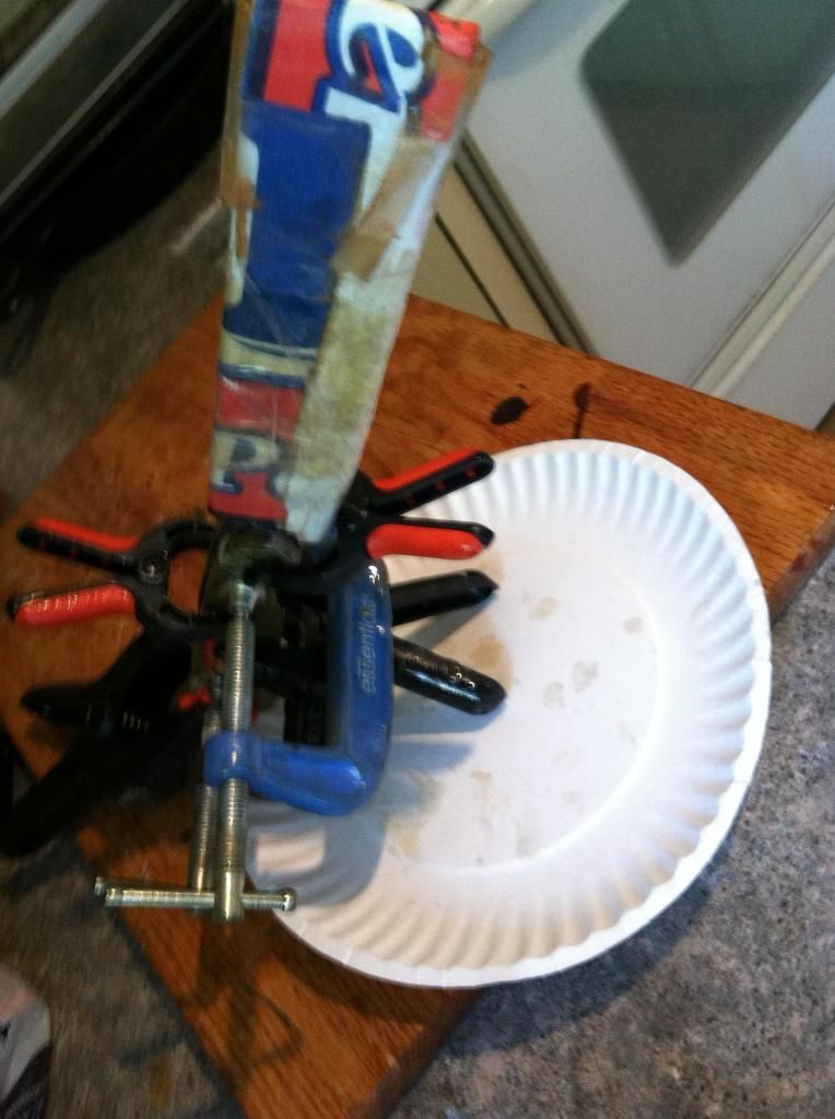

BK16 WIP, including some homemade burlap micarta
You mean to tell me that that's all I needed to do, to have my own micarta grips? I could've made some at any time with some burlap and resin?
Yyyup. Burlap, cloth, construction paper...even green wool sox (I'm looking at you LG&M). if you are just going to make one set, it's not much cheaper than buying scales. and, you will make a mess. but, it's a fun DIY thing every now and again. it's been a while since i've made a set. i got the 16 and it seemed like the right time.

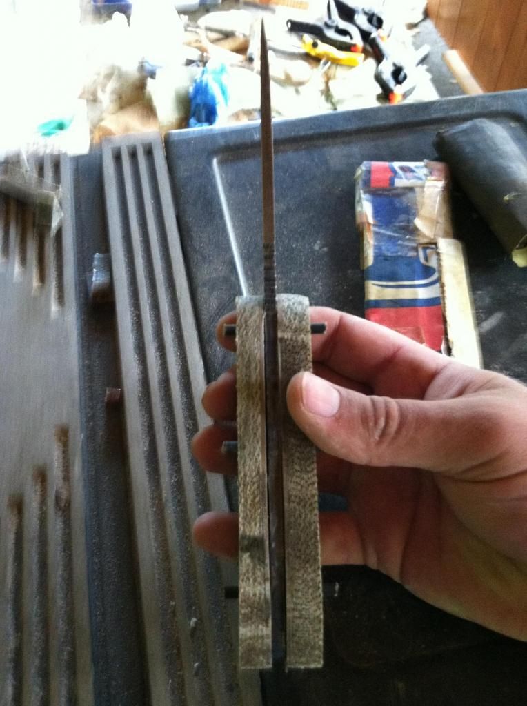

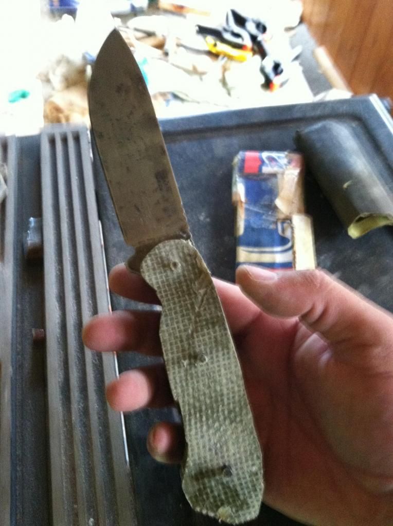

i didn't take many pics, so let me just describe the process a bit, for those unfamiliar and interested.
1) trace handle on handle scales. cut.
2) add contact cement to scales and knife, clamp, and let set for just a few minutes. (i have not been careful in the past and have ended up with not-so-straight holes, which is a big problem. so, i find the contact cement helps hold things together just well enough)
3) drill holes
4) finish blade end of handle (i.e. cut and sand). this is hard to do once, everything is glued up.
5) make sure pins go through both scales and knife :D **see #2 above (this is a joke, but only sort of. this is a good chance to make sure that everything lines up and that you like what you see)
6) glue scales to knife. i use G/Flex.
7) let set for 24 hrs
8) finish handle (really just sanding, filing, etc)
the couple pics below are step 5.
and this is step 6.

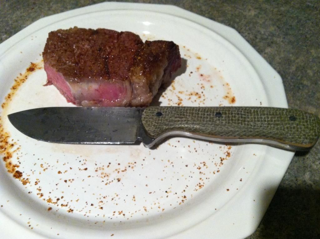

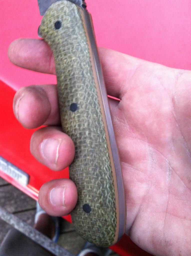

ok, here she is. a bit rough and she's dirty, but figured i'd still add some pics.
i have to tell ya....i'm not super-psyched. i have a low-tech/low-budget setup. i just use a drill press with sanding discs on it. i had it just about perfect. fit my hand great. but, i put on a new 120 disc to finish 'er up and bit in too much. and, i spent the rest of the time correcting. it's easy to do. before you know it, ya got a skinny handle.
still turned out alright, but i know already i will be doing another. ;)
i'll clean it up tomorrow (maybe) and try to take some pics in better light.
EDIT: adding the money shot....
