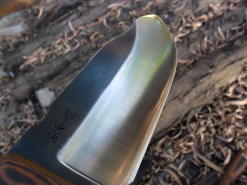

Convex your edge, makes in way better at cutting and chopping stuff. Best way IMO is to use sandpaper and a LEATHER strop. You'll need to start with 80 grit otherwsie it'll take you till your like 100 to finnish...work your way down ig. 80, 120, 300, 600, 1500. Plus the only maintainance you need for a convex edge is to strop it everynow and then on a leather strop (stropman.com, awesome quality strops hadmade in Texas and Robert is the nicest freaking guy you'll ever meet).
Heres my convex BK2.
BK-2 Convex Edge by CamH_16, on Flickr
