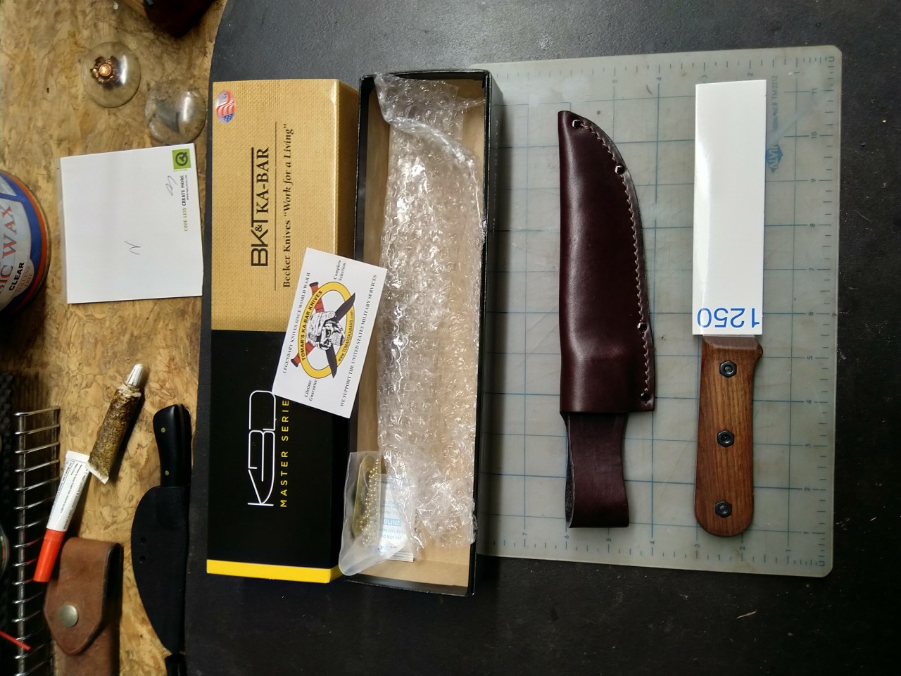

BK-62 arrived today!!
Sweet blade. Feels really interesting in the hand, makes me want to wave it around.
Some notes:
* The sheath is solid. Impressive, Ka-bar. It's not refined, but at this price point it's great. Good welt, riveting, molding.
* Love the tumbled finish.
* Good factory edge. Appears to have been stropped, no burr.
* I like the walnut scales. Grain is plain, as expected, but no manufacturing flaws
* I like the button-head allen bolts.
* Tall flat handle is interesting. Not sure I love it, BUT it indexes VERY well, and is super versatile. The narrow blade and tall handle give good torque in wood, as expected.
* Centered point makes drilling easy.

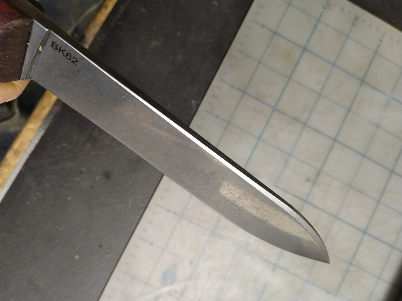

Some minor issues:
* plunges are a bit uneven at the edge
* Plunges appear to be a bit over-ground at the spine. It's actually thinner at the spine plunge than further down the blade spine over the belly. I think the big disc grinders that do the main bevels probably need adjusting. Tolerable, though.
I ordered from Tomars:

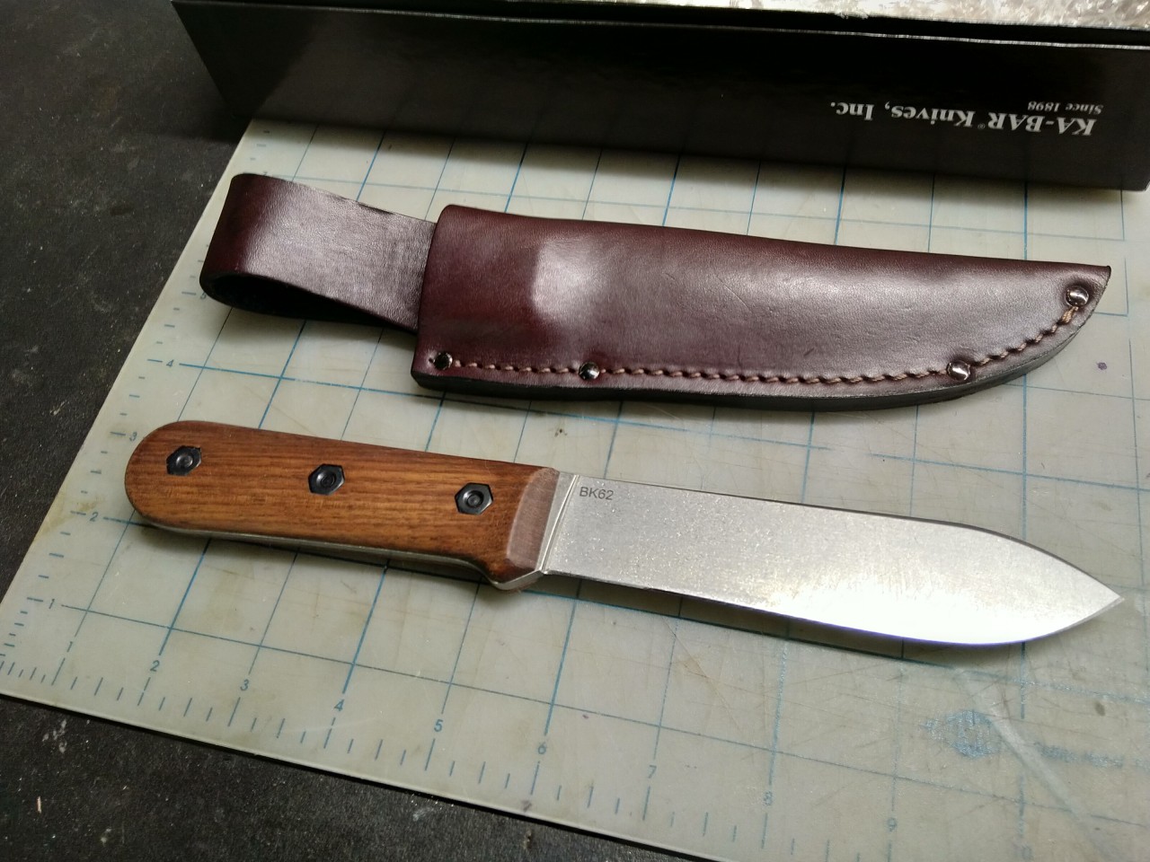

Out of the box:

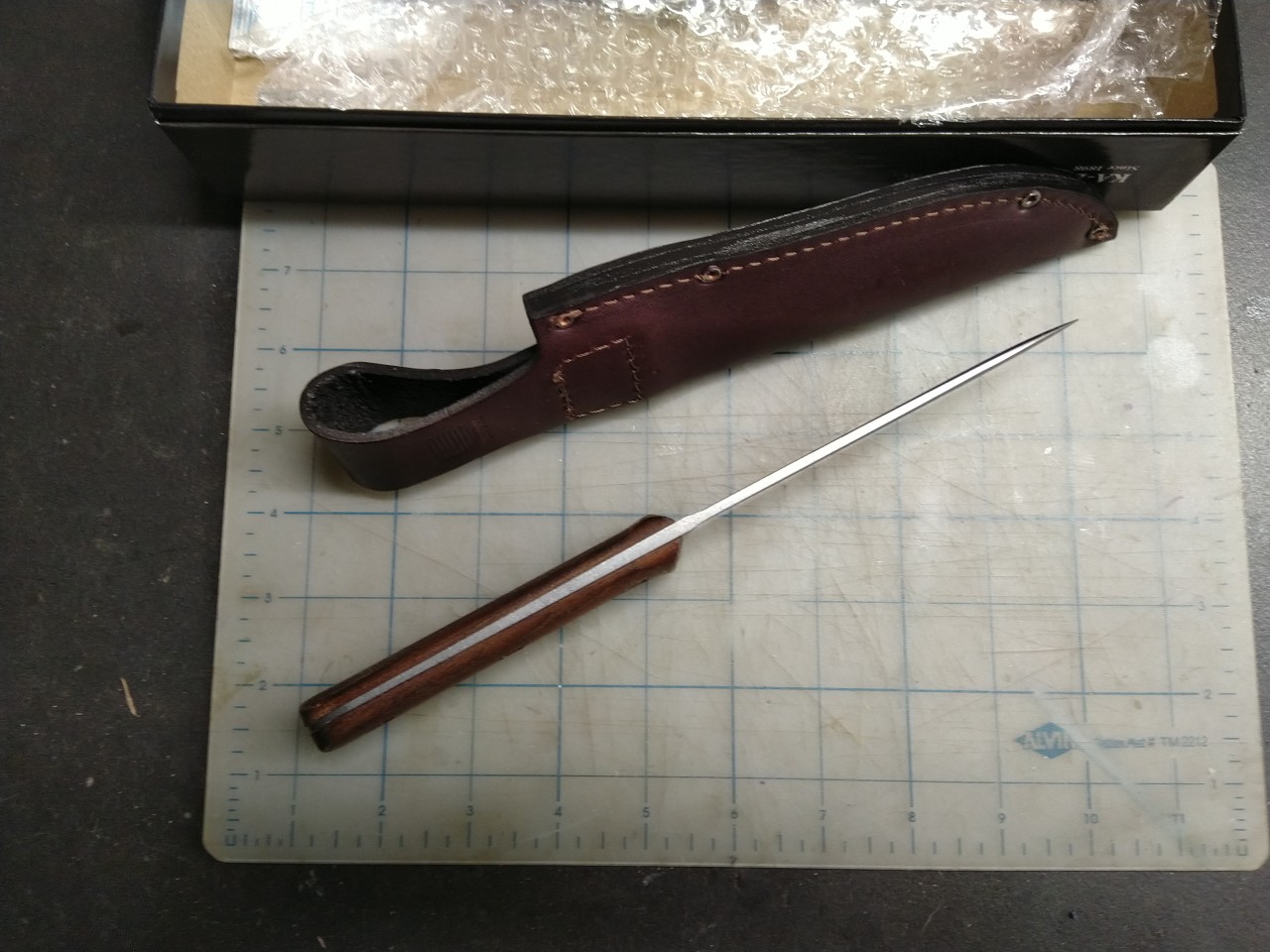

Slender and tapered tang are dead sexy!:
Long gentle swedge is dead sexy!:

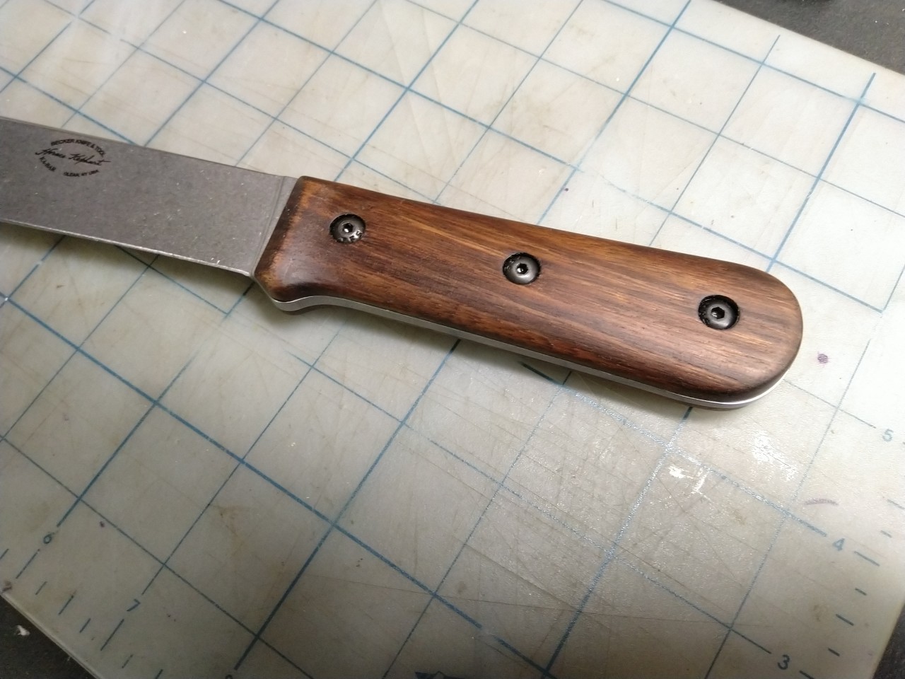

Scales after some 400x sandpaper, BLO, and furniture wax:

Good stuff daizee, glad you got one in. 'Tis a cool freakin blade. Your scales look awesome.
